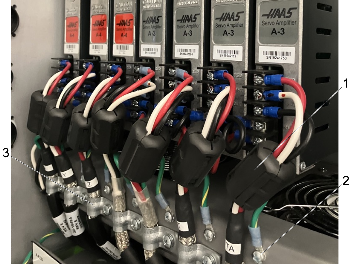

Use a service key and navigate to the MISC page on the control by pressing Diagnostics -> MISC. Look at the IOPerformance fields that show the communication errors that have been generated. See the Check IO Performance section below.
If the number of errors is growing, this indicates electrical noise in the control cabinet.
  1. Press [E-STOP] to turn the servos off. Then check to see if the number of errors continues to grow.
  2. Check that all ferrite filters are installed on communication cables.
  3. Check that the amplifier power cables are properly grounded to chasis.
Note: The MISC tab can only be seen when a service key is used on the machine.
Enter service mode using the service key.
Press Diagnostics and then going to the MISC tab [1].
Monitor the Total Errors and CRC Errors for both Transmitting (Tx) and Receiving (Rx) [2].
If the number of errors is growing, there is likely electrical noise present in the control cabinet.
Press [E-STOP] to turn off the servo motors. Check if this stops the number of errors from growing. Electrical noise may be produced by the power cables coming from the servo amplifiers located above the IO board.
If the number of errors stops increasing when the servos are off, make sure that all ferrite filters are installed on communication cables and that amplifier power cables coming from the amplifiers and vector drives are properly grounded.
Make sure there are ferrite filters [1] ground connections [2] and that the exposed shielding is grounded on all amplifiers [3].
