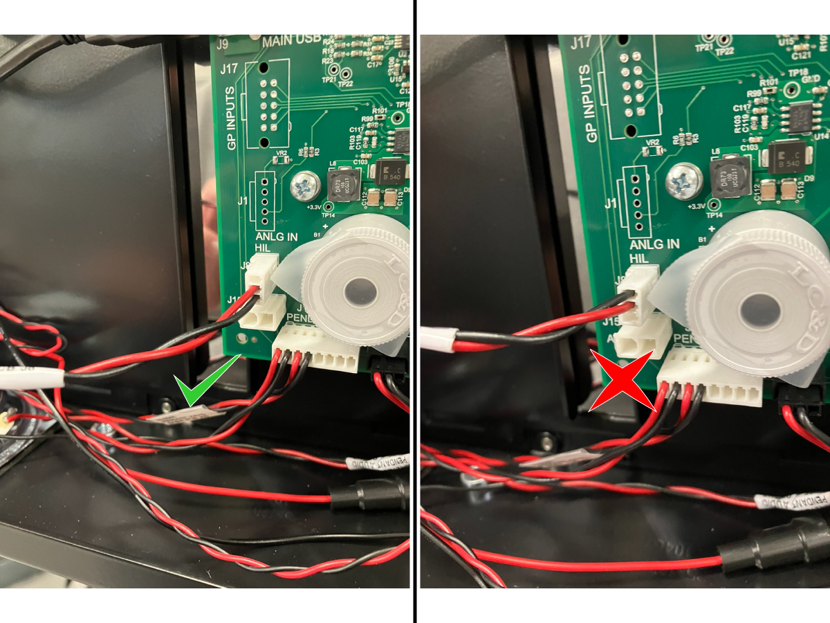

Mount 100W POWER SUPPLY [1] above the standard 24V work light power supply using PPHS SCREWS [2].
Connect the POWER SUPPLY CABLE [3] to the 100W POWER SUPPLY [1] terminals L, N, and ground.
Route the other end of the POWER SUPPLY CABLE (33-1592) [3] over the 100W POWER SUPPLY down the left cable track and connect it to a 120VAC output on the I/O PCB, P18/19/20/21.
Disconnect the work light cable [4] from the existing power supply and connect it to V+ and V- terminals on the 100W POWER SUPPLY. Red to V+ and black to V-.
 Important: The work light cable [4] needs to be routed along the left panel.  Do not route the extesion cable through the center track with the High Voltage cables..
 Important: Secure all cables and make sure the wires don't get caught on the door.
6
Actuate the light switch on the side of the controller to test that the work light turns on.

HIL Button Cable Incorrectly Wired
Symptom: After installing HIL, pressing the momentary button on the pendant does not turn on the lights. Quickly jumping the bottom two pins on J8 on the SKBIF is
Probable Cause: The wires going to the momentary button J8 on the SKBIF need to connect to the middle and bottom pins. The momentary signal will not trigger the HIL to turn on if it goes to the top and middle pins.
Corrective Action: Order replacement part 33-4511.
