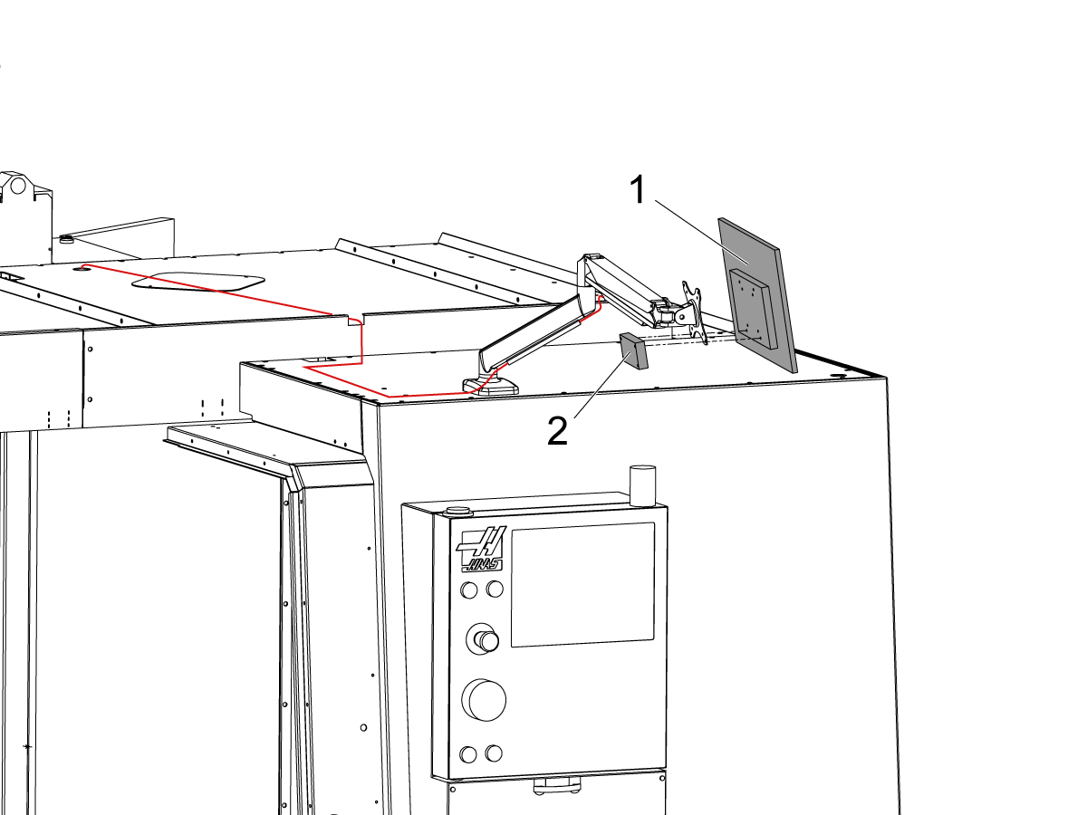

Mount camera [1] assembly in enclosure, right rear panel near the OMI [2].
Point the camera at the table where the parts are loaded.

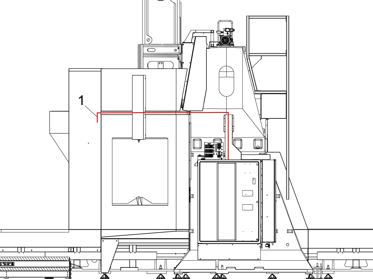

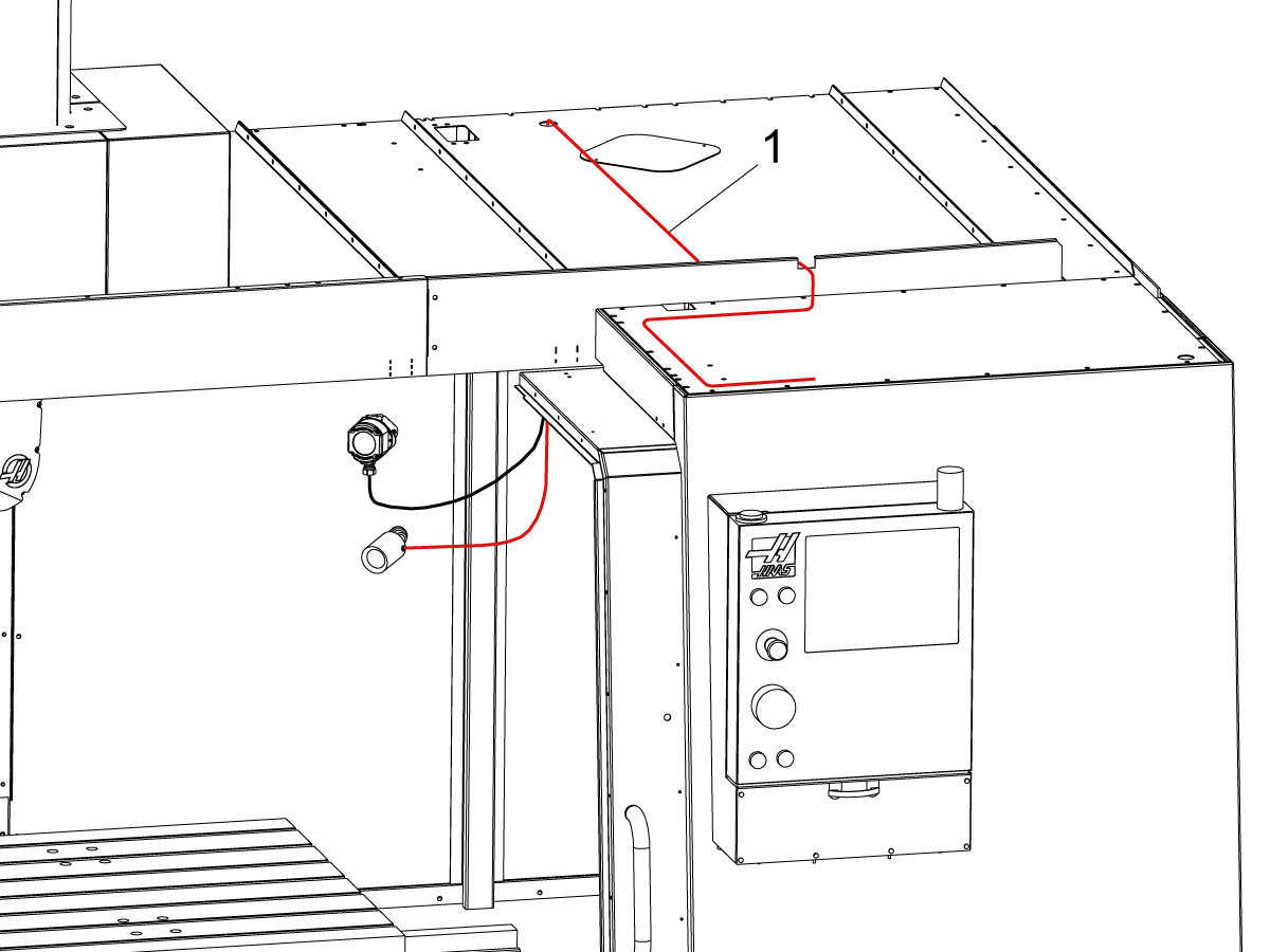

Route USB-C cable [1] following existing cable paths on the roof to the pendant area.
Route monitor power cable  from control cabinet 110V outlet to the pendant area using the existing pendant cable routing [1].
Note: Routing may vary based on machine size.
 Note: Remove the set screw on the lowest joint and slide the arm off of the base to access the bolt used to secure the arm to the machine.

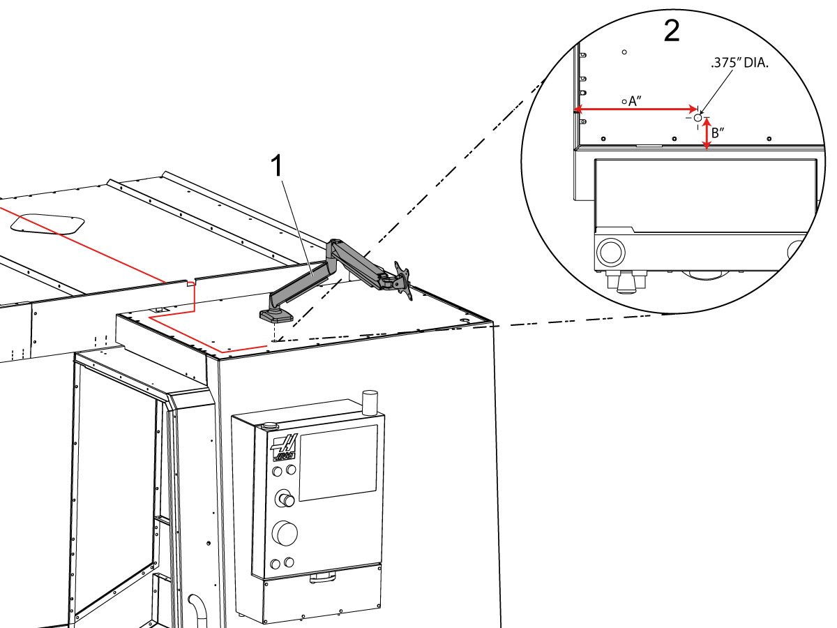

Install monitor mounting arm [1].
 Note: For machine build before 11/1/2024, a .375 inch dia. hole needs to be drilled on the right top panel [2].
Note: For VR-8/9/11 machines place the hole approximately 9 inches (228.6 mm) from the left side (A) and 5.5 inches (139.7 mm) from the front of the machine (B).
 Note: For VR-14 machines place the hole approximately 12.5 inches (317.5 mm) from the left side (A) and 5.5 inches (139.7 mm) from the front of the machine (B).

 Note: Route the cameras USB-C and power cables along the monitor arm under the plastic covers.

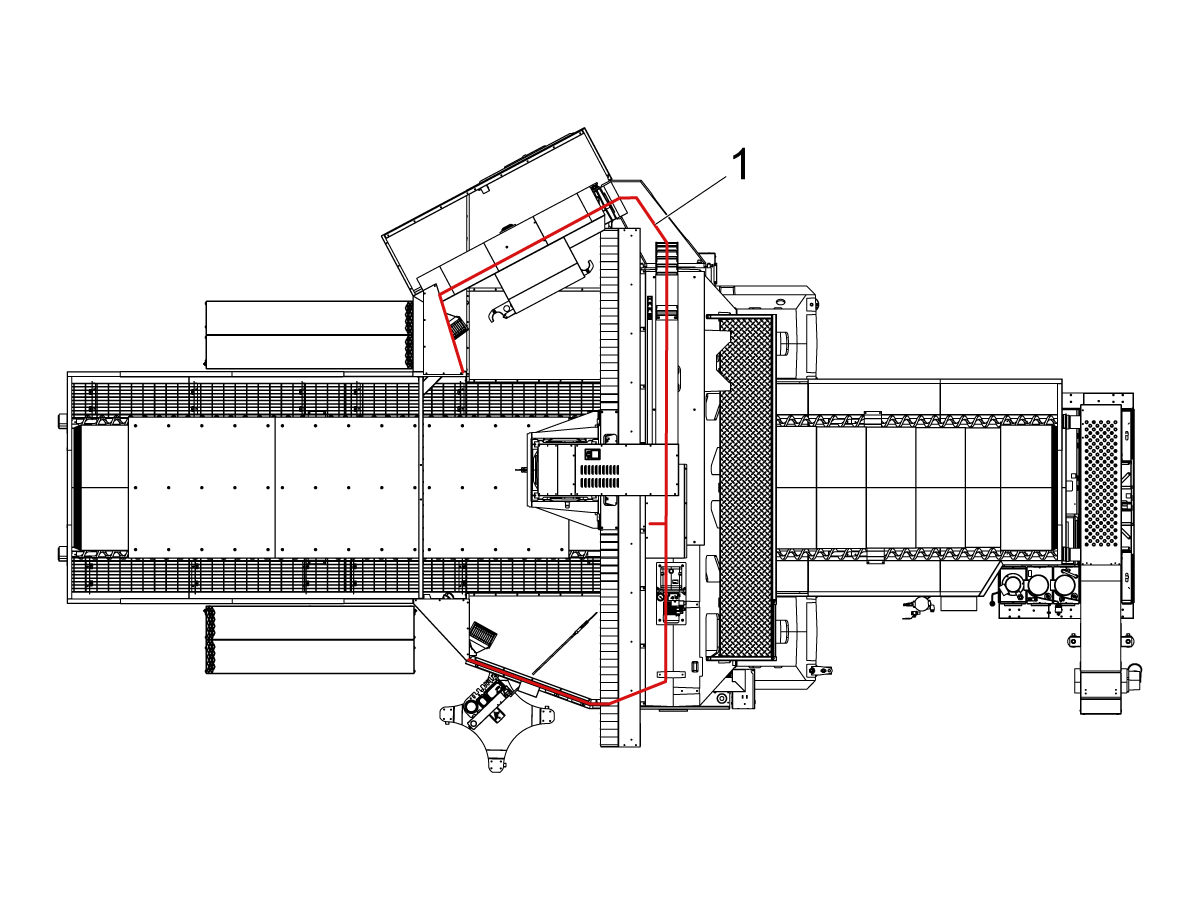

HDC Machines
Mount one camera assembly under the bridge on the right side [1] and the other camera assembly on the Tool Changer side [2] near the work light mount [3].
 Note: Route the camera cable through the hole [4] on the sheet metal under the bridge.
Install monitor mounting arms in 2 of the 3 locations [1, 2, 3] on the front of the machine near the operators window.
Route USB-C cables following the existing cable routing [1].
Route monitor power cable from control cabinet 110V outlet to the back of each monitor using the existing routing [1].
Install the monitors [1] and USB to HDMI converter boxes [2].
6
Plug in all components using provided cables.
Note: HDMI and Power cable supplied with monitor will not be used.
