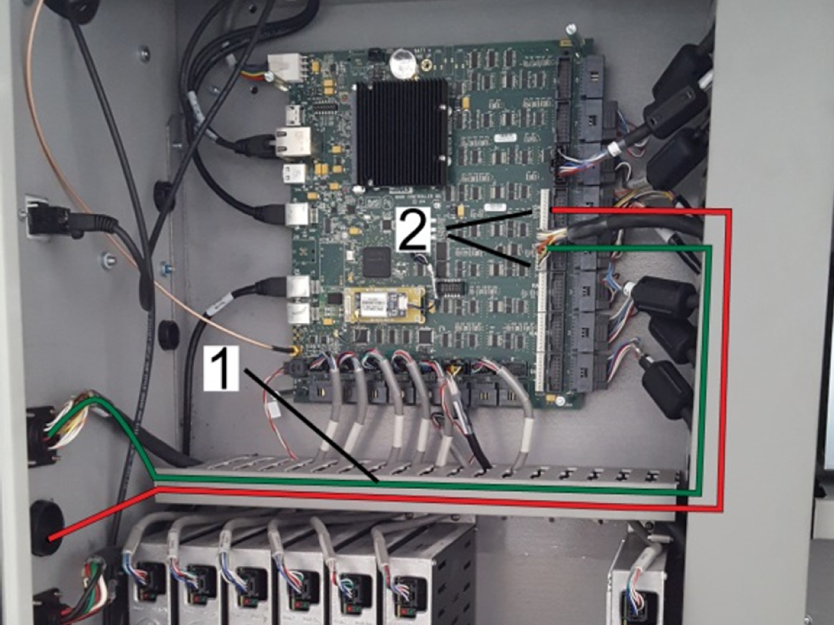

Remove the center cable track cover and the track cover below the MainCon PCB.
Remove the MainCon PCB cover.
Route the 4TH-AXIS SCALE or 5TH-AXIS SCALE cable [1] as shown.
Connect the 11-pin connector of the rotary scale feedback cable to the correct connector on the MainCon PCB:
  • 4TH-AXIS SCALE Scales Channel 12A (P36)
  • 5TH-AXIS SCALE Scales Channel 13A (P37)
Install the covers.
