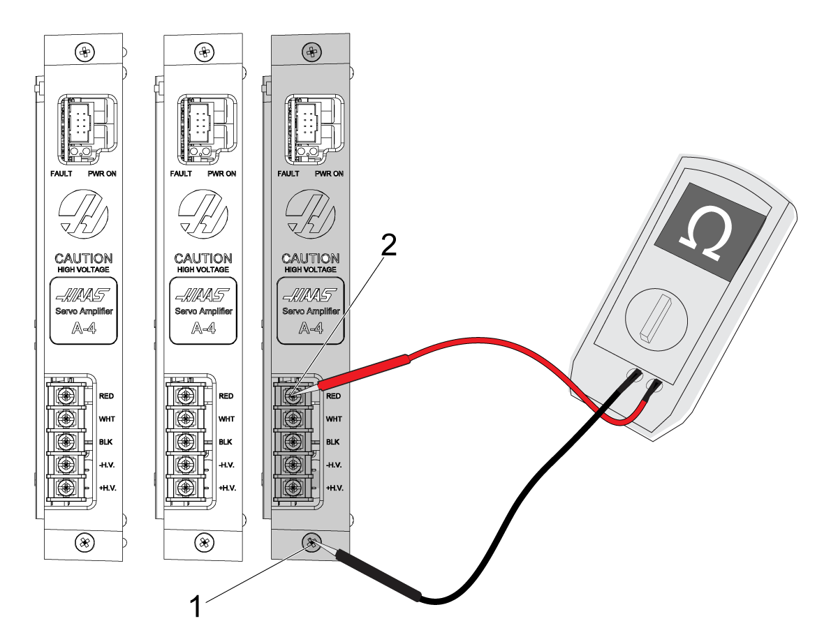

Amplifier Short Circuit Inspection
Check the amplifier for a short. Power off the machine. Disconnect the cables for the axis servo motor at the amplifier that generates the alarm.
Set the multimeter to ohms, and take the following reading:
  • Place the black lead on the ground screw [1].
  • Place the red lead on the RED terminal [2] and record the resistance reading.
  • Repeat this with the red lead on the WHT, BLK, HV(+), and HV(-) terminals and record the resistance reading for each.
Note: If the multimeter allows you to set the Ohms range, set it to the MegaOhms range.
If the multimeter does not show (O.L) for each of these readings then the amplifier is damaged.

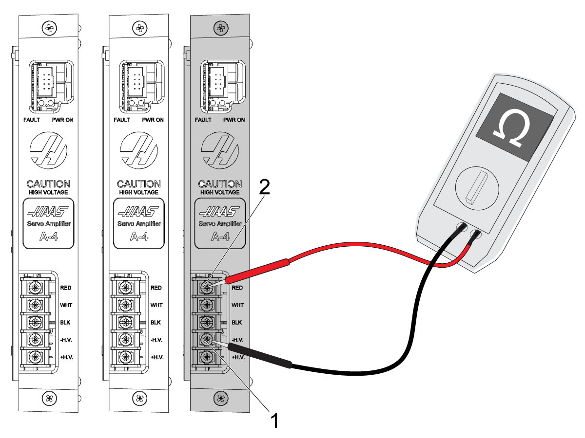

  • Place the black lead on the HV (-) terminal [1].
  • Repeat this with the red lead on the WHT, and BLK terminals and record the resistance reading for each.
If the multimeter should show a resistance in the MegaOhms range for each of these readings.
If the resistance reading is very low then the amplifier is damaged.
  • Place the black lead on the HV (+) terminal [1].
