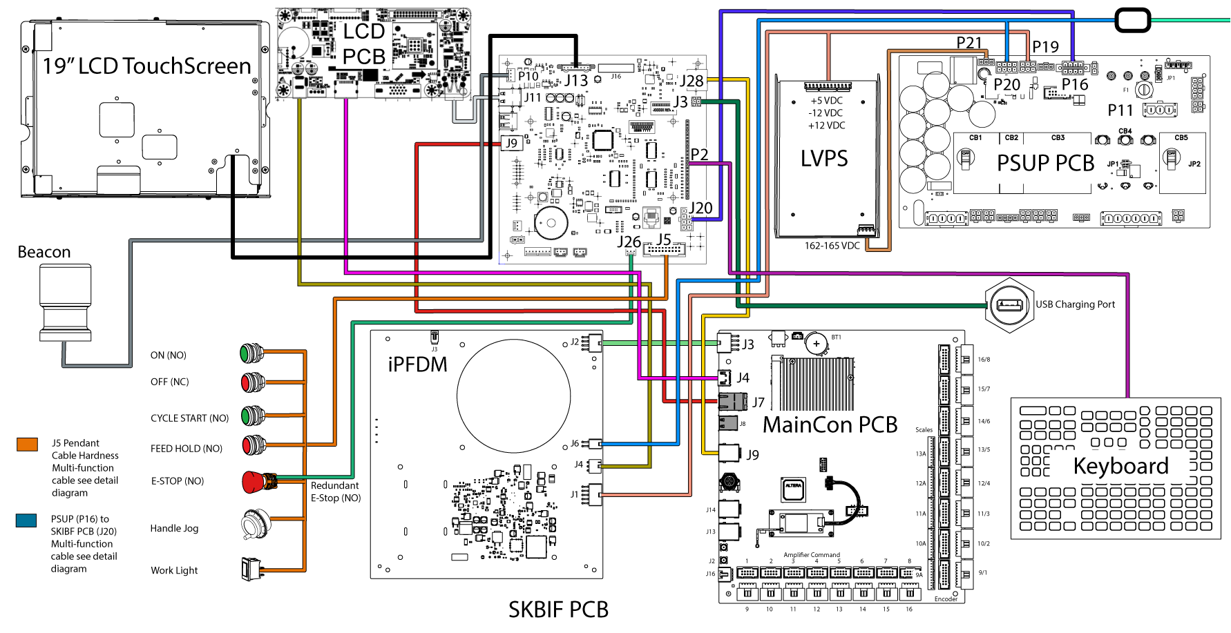

SKBIF Inspection Report Checklist
Download and fillout the SKBIF Inspection Report Checklist below before replacing any parts.
[1] 15" LCD.
[2] 15" Touchscreen LCD.
NOTE: Not all machines are equipped with the LCD touchscreen.  The LCD touch screen has a USB cable that plugs into the SKBIF PCB.
[3] SKBIF PCB
[4] Handle Jog
[5] E-Stop Button
[6] Power Off
[7] Power On

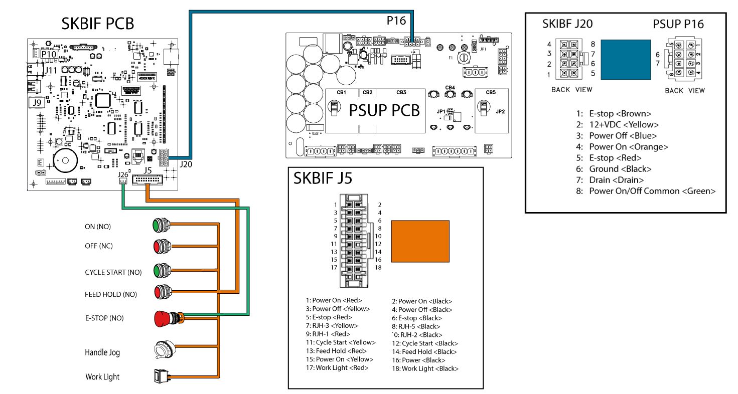

The wires to the [POWER ON], [POWER OFF], [EMERGENCY STOP], [FEED HOLD] and [CYCLE START] contactors terminals are loose.
The beacon light does not turn on. The beacon light cable is not connected. Make sure the beacon light is connected to SKBIF at P10.

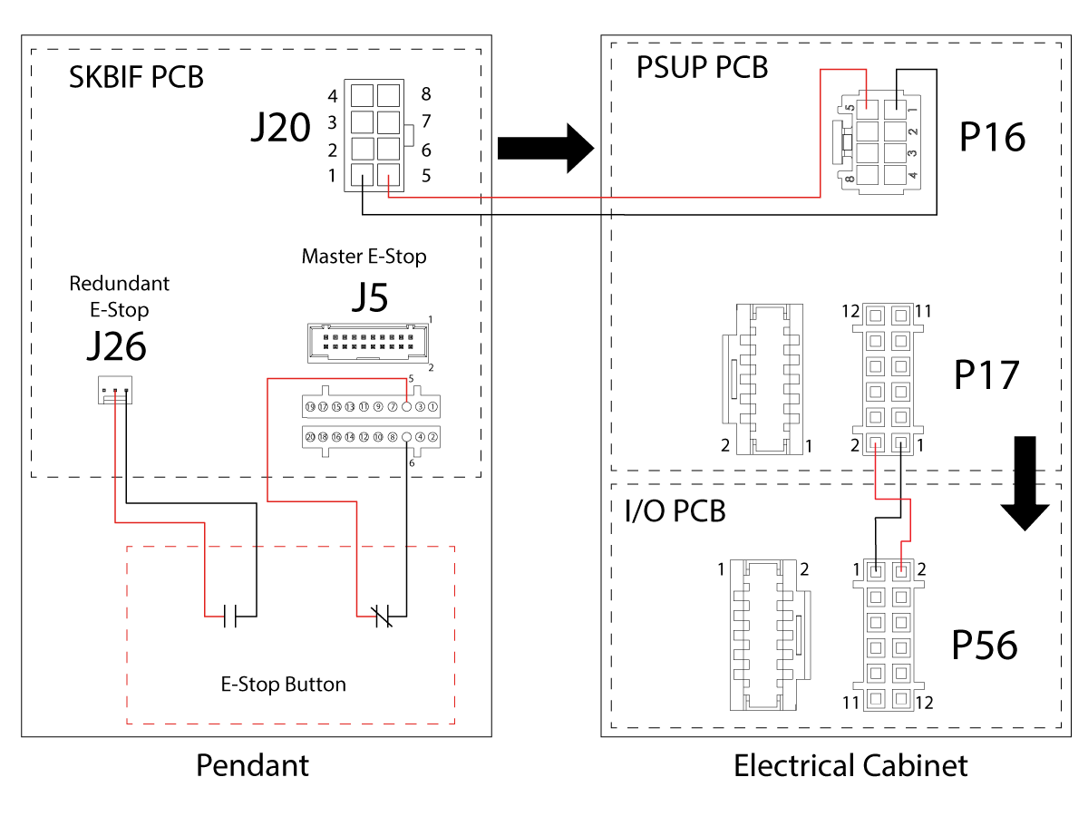

Alarm 2001 EMERGENCY STOP SWITCH ERROR
There is a loose connection from the E-stop button to the SKBIF PCB.
  1. Go to Diagnostic Page --> Keyboard I/O
  2. Type REDUNDANT_ESTOP then press [F1].
  3. With [EMERGENCY STOP] released the INPUT #26 REDUNDANT _ESTOP value should = 1.
  4. Press [EMERGENCY STOP].  The INPUT #26 REDUNDANT _ESTOP value should = 0. If it remained = 1 check the cable plug to SKBIF J26 see diagrams located at the end of this Troubleshooting Guide.

SKBIF / 15" LCD Interconnect Diagram

Pendant E-Stop Circuit Diagram
PSUP (P16) to SKBIF (J5) Detailed Diagram
PSUP (P17) to I/O PCB (P56) Detailed Diagram

Electrical Diagrams
SKBIF / 19" LCD Interconnect Diagram
SKBIF Diagram P/N 34-4510C
Note: Machines with SKBIF 34-4510C will have the USB Charging Port connected to J3. The Charging Port is only for charging purposes and not for getting data from USB devices.
