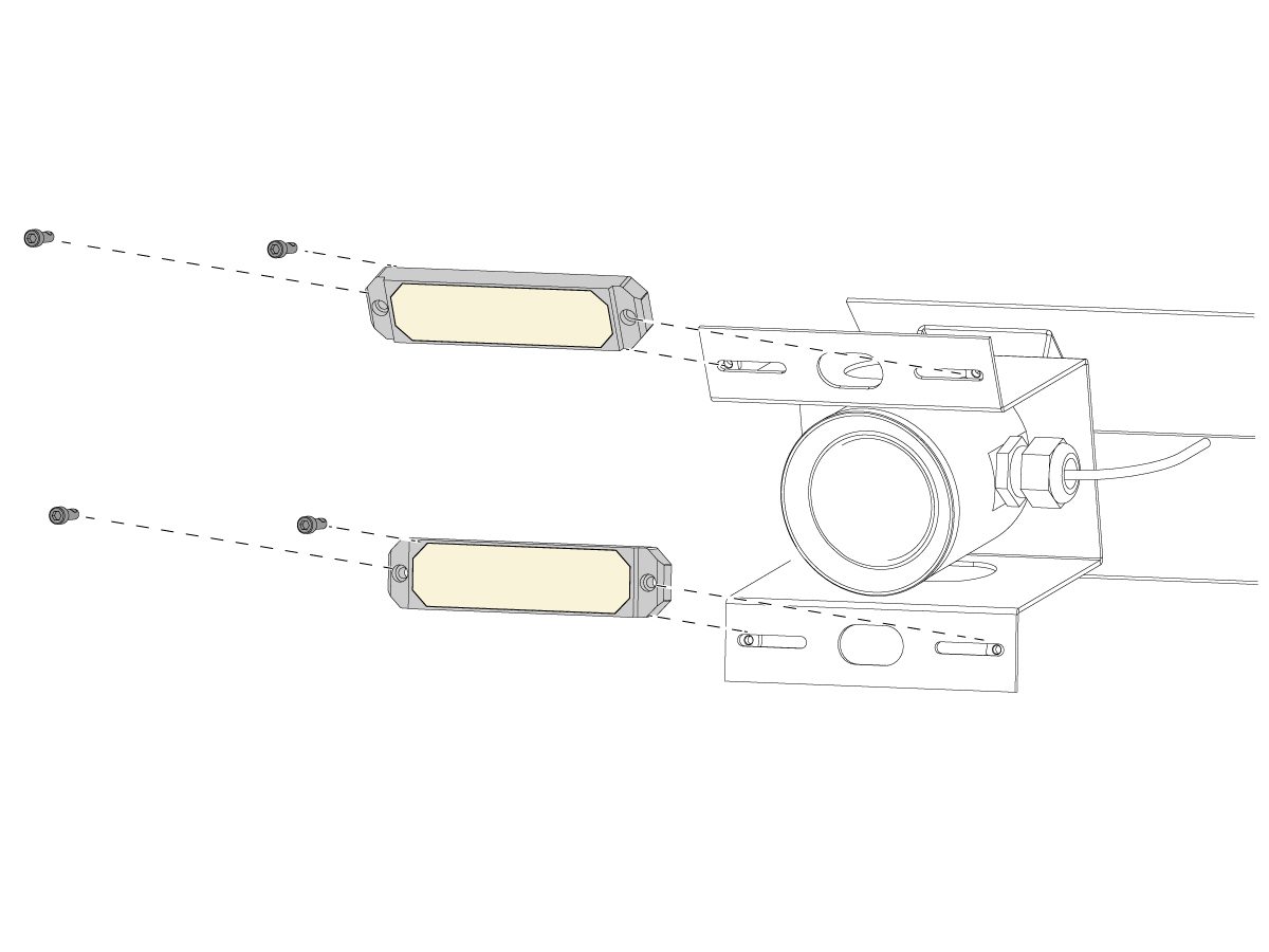

Broken Tool Detection - LED Replacement
AD0706
This procedure will show how to replace the LED lights on the Broken Tool Detection System.
This procedure should apply to the follow service kits:
  • 93-3813 SVC KIT BTD CAMERA/LED
IMPORTANT: This service kit only includes the LED lights. There is no camera included.
 NOTE: Once the LED lights have been replaced, the camera may need to be re-calibrate to adjust to the new brightness. For more information on the calibration process, refer to the Broken Tool Detection - Calibration procedure.

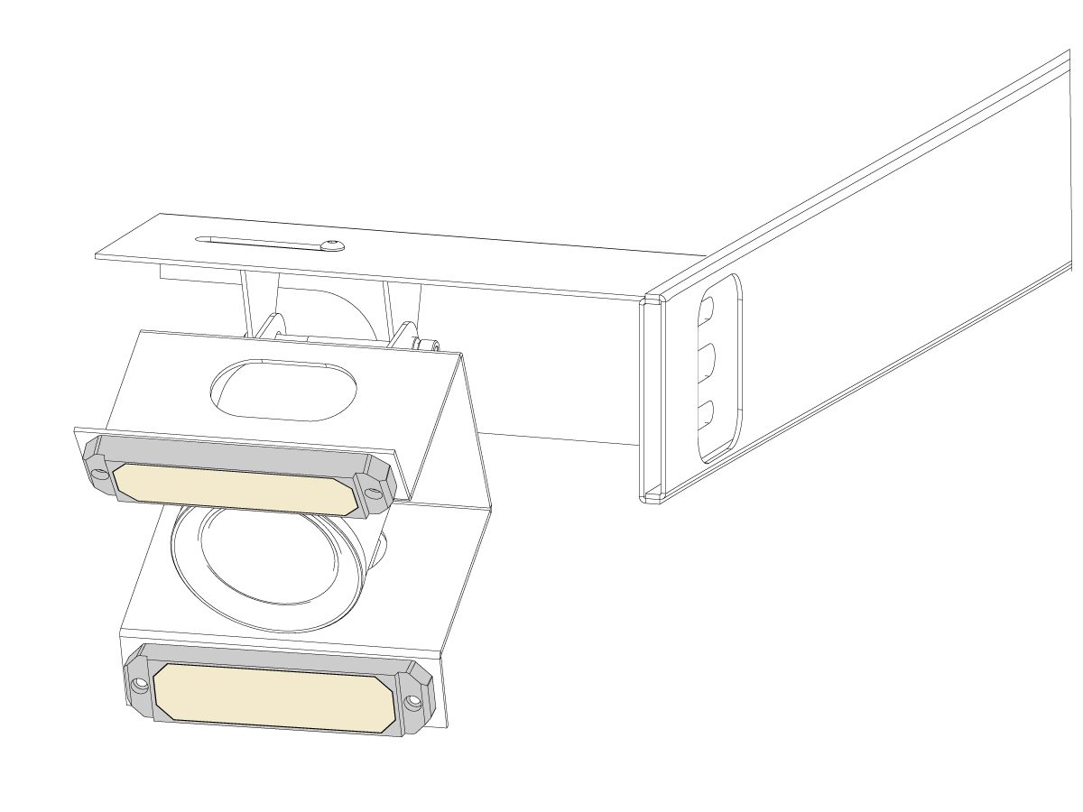

Replacement
Disconnect both LED lights from the +12V LED power cable 33-1228 [1] connecting into J3 on the BTD A62 PFDM PCB.
Follow the LED light cable from the control cabinet around the machine's enclosure panels. Remove the LED light cable.
Remove the (x4) screws securing both LED lights to the broken tool detection brace.
Remove & discard both LED lights.
Install the (x4) screws securing both LED lights to the broken tool detection brace.
Route the LED lights cable around the machine's enclosure panels into the control cabinet. Route the camera cable into the group of other routed cables behind the tool changer.
Install the LED lights cable into the LED lights.
Connect both LED lights from the +12V LED power cable 33-1228 [1] connecting into J3 on the BTD A62 PFDM PCB.
