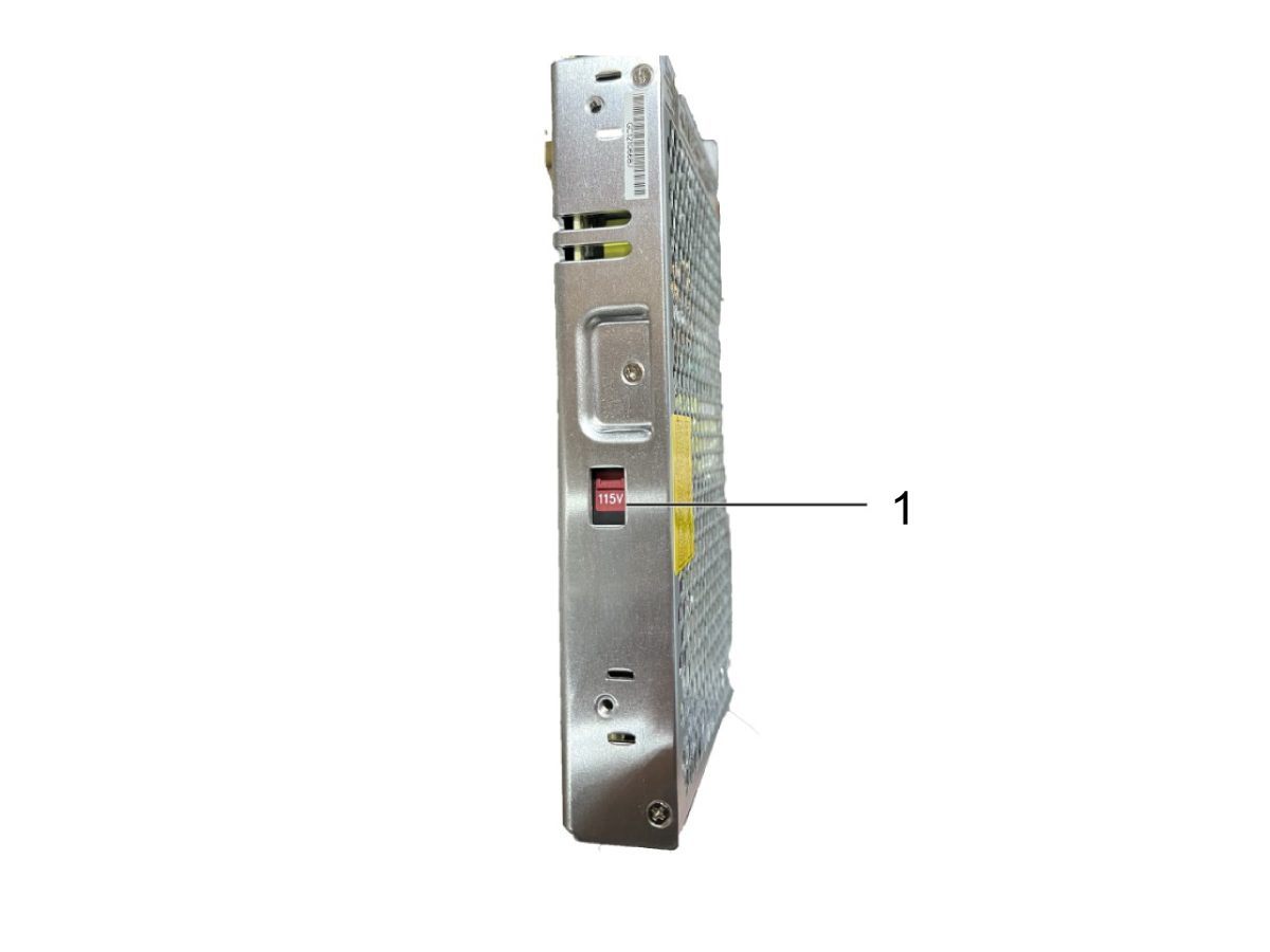

On the side of the power supply there is a voltage input switch. Set the voltage input switch to 115V [1].
Install the new 200W LVPS [1] to the plate [2] using the 4 screws.
Then, install the plate [2] to the enclosure [3] using the 4 screws.
