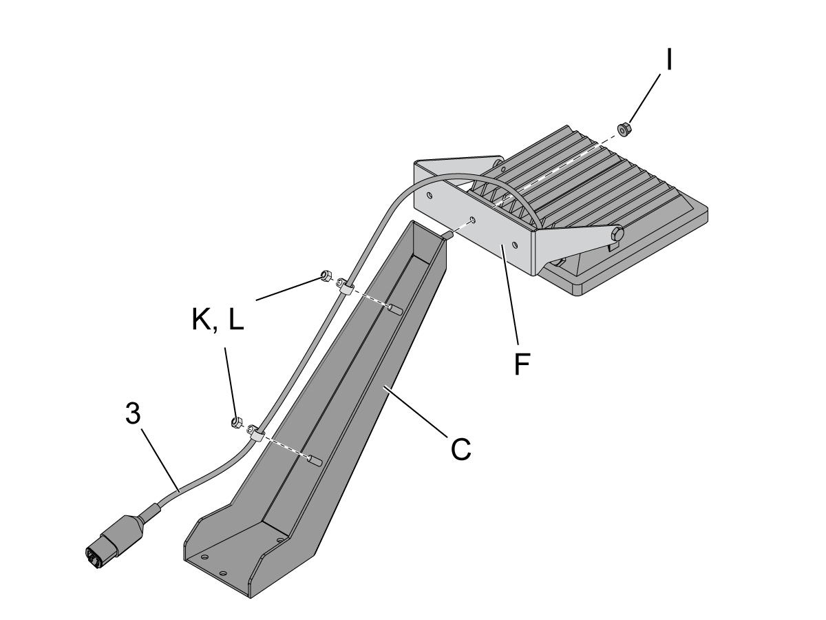

Attach the BRACKET, LIGHT MOUNT ARM [C] to the BRACKET, LIGHT MOUNT PIVOT [F]. Use the 1/4-20 LOCKNUT NYLN INSRT [I].
Attach the HIL power cable [3] to the BRACKET, LIGHT MOUNT ARM [C]. Use the (2) CABLE CLAMP 1/4 [K] and (2) NUT, 10-32 NYLON LOCK [L].
Make (2) of these assemblies.

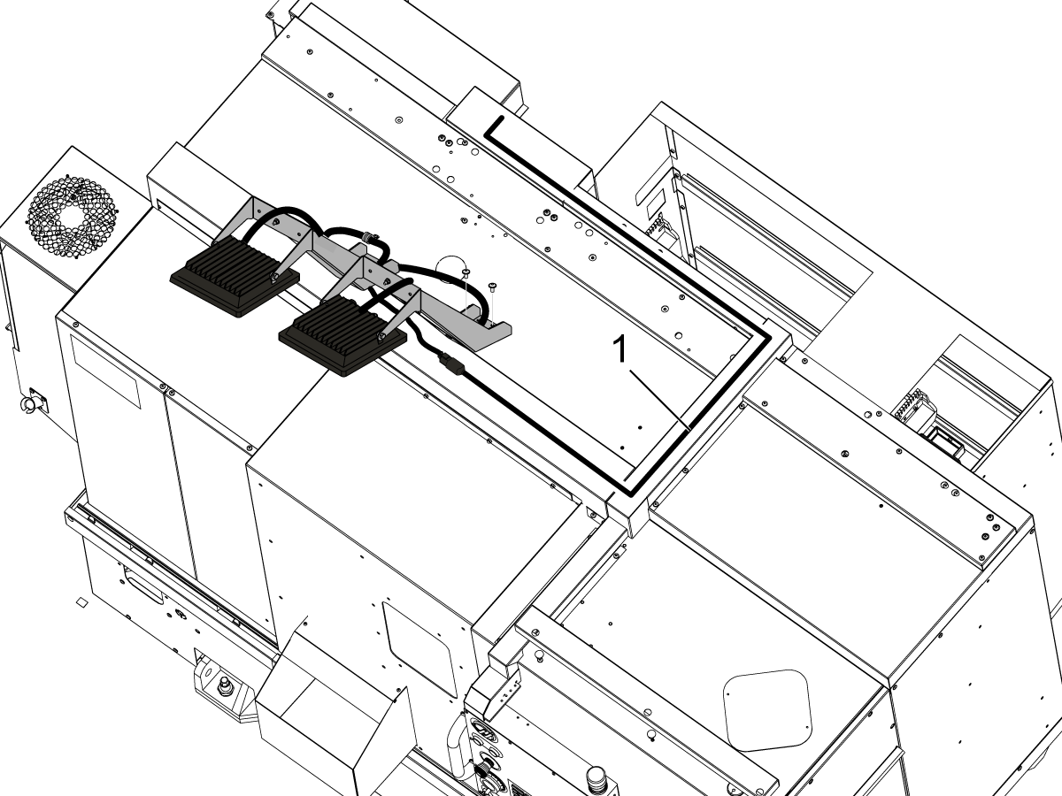

Lathe Reboot Power Cable Routings
Route the power cables [1] through the cable covers as shown.

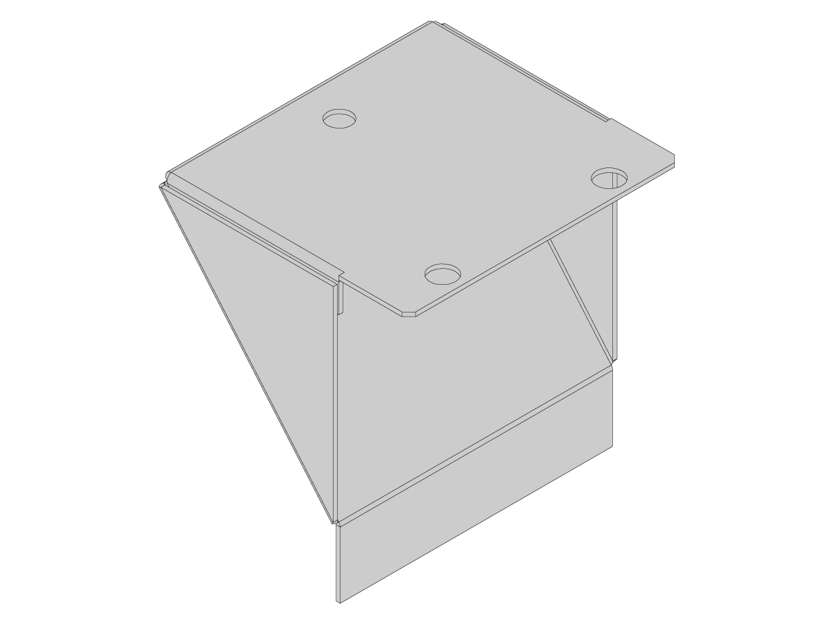

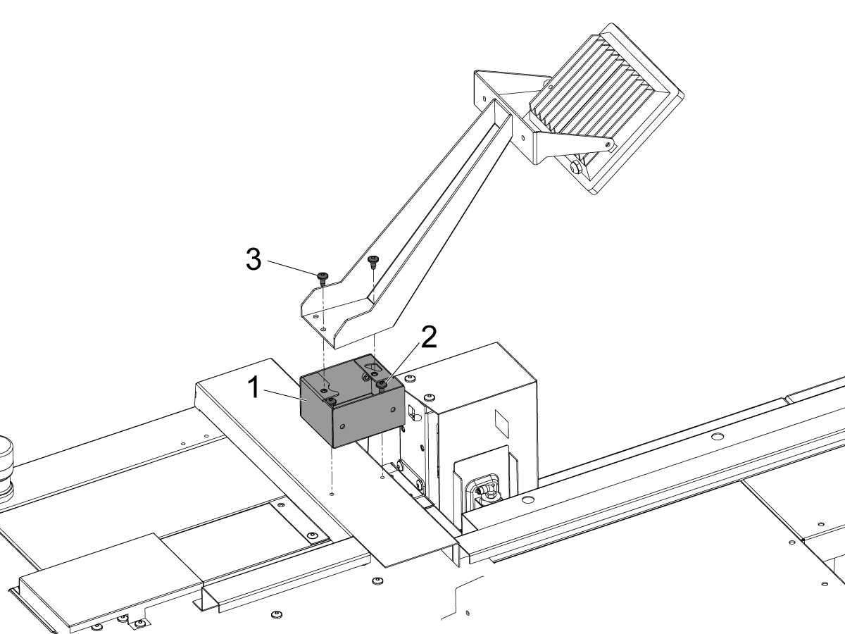

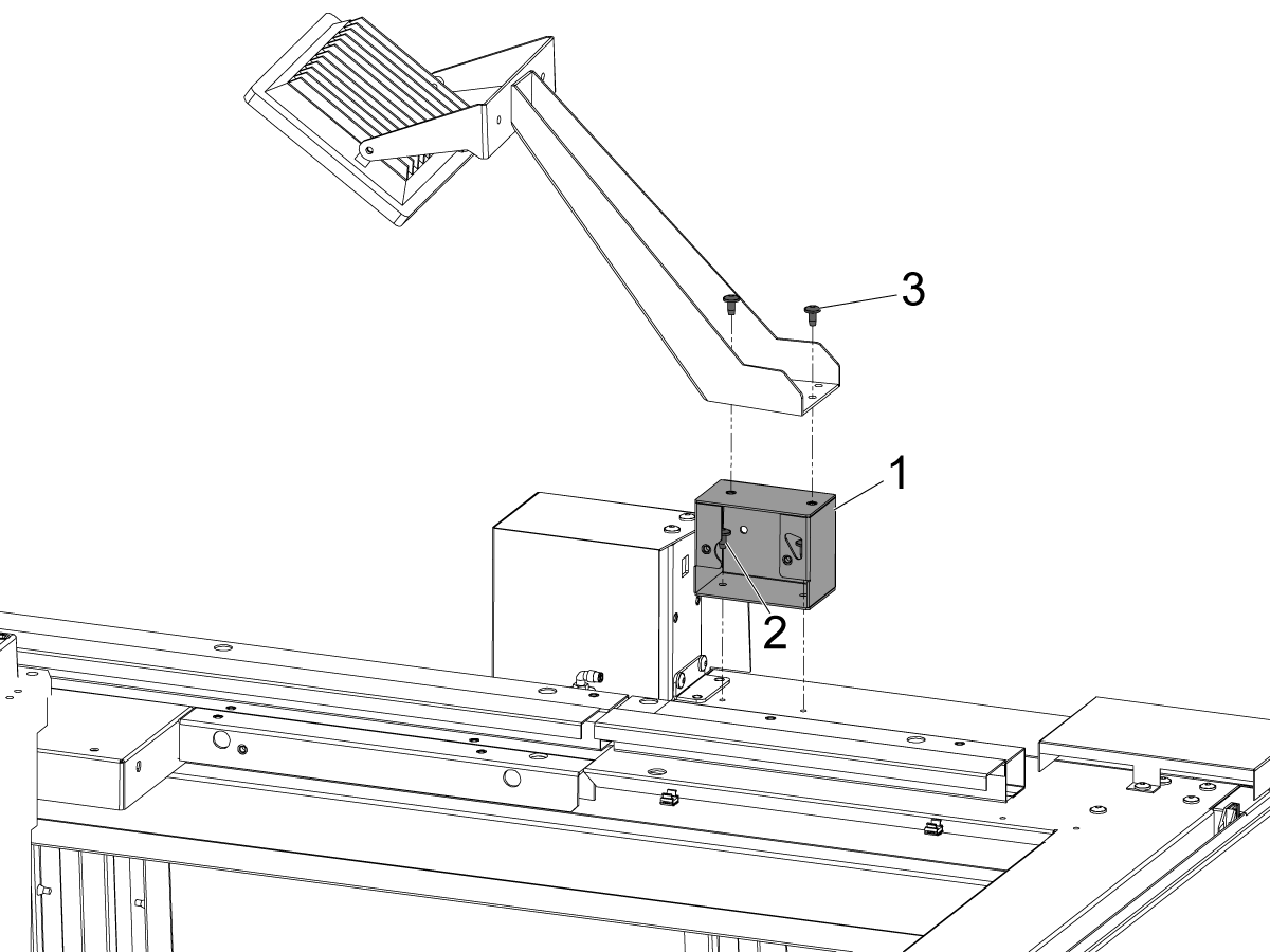

For models: VF-1/2
NOTE: If the autodoor option was installed with the HIL option a riser plate [1] will need to be installed to avoid interference.
The image shows the left HIL riser plate being installed, the plate [1] will need to be installed using FBHCS 1/4-20 X 1/2 LOCTITE [2] to the top enclosure. Then you will mount the HIL to the riser using FBHCS 1/4-20 X 1/2 LOCTITE [3]
For models VF-1/2:
The image shows the right HIL riser plate being installed, the plate [1] will need to be installed using FBHCS 1/4-20 X 1/2 LOCTITE [2] to the top enclosure. Then you will mount the HIL to the riser using FBHCS 1/4-20 X 1/2 LOCTITE [3].

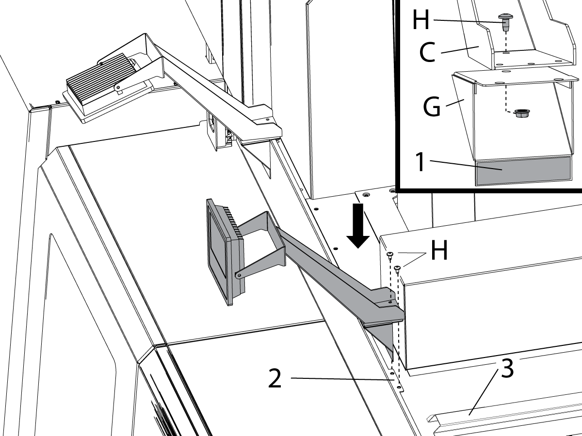

For models: VM-6, VF-6 through 14.
 Note: Use the HIL MOUNT BRKT KIT LRG VF (P/N 93-1000523) kit.
Fully clean the front panel above the doors.
Attach the BRACKET, HIL MOUNT [G] to the BRACKET, LIGHT MOUNT ARM [C]. Use (1) SCREW,FBHCS 1/4"-20 X 1/2" [H] and (1) 1/4-20 nut.
Remove the backing paper from the adhesive tape [1] at the bottom of the BRACKET, HIL MOUNT [G].
Install the light assemblies above the main doors. Use (2) SCREW, FBHCS 1/4"-20 X 1/2" [H]. Push the tape tightly against the front panel.
Connect the cables from the light assemblies to the CABLE, 24V EXT [E].
Put the CABLE, 24V EXT into the control cabinet. Attach the cable to the cable channel [3]. Use CABLE TIE BLK 5.6 LG [N].

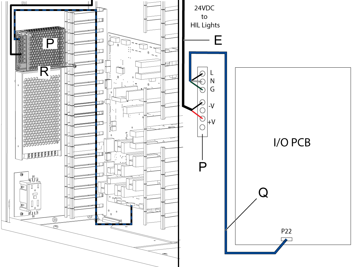

6
Mount 100W POWER SUPPLY [P] above the standard 24V work light power supply using PPHS SCREWS [R].
Connect the POWER SUPPLY CABLE [Q] to the 100W POWER SUPPLY [P] terminals L,N and ground.
Route the other end of the POWER SUPPLY CABLE [Q] over and 100W POWER SUPPLY down the left cable track and connect it to P22 on the I/O PCB.
Connect the HIL EXTENSION CABLE [E] to V+ and V- terminals on the 100W POWER SUPPLY. Red to V+ and black to V-.
Important:  Cable HIL EXTENSION CABLE [E] needs to be routed along the left panel.  Do not route the extension cable through the center track with the High Voltage cables..
Important: Secure all cables and make sure the wires don't get caught on the door.

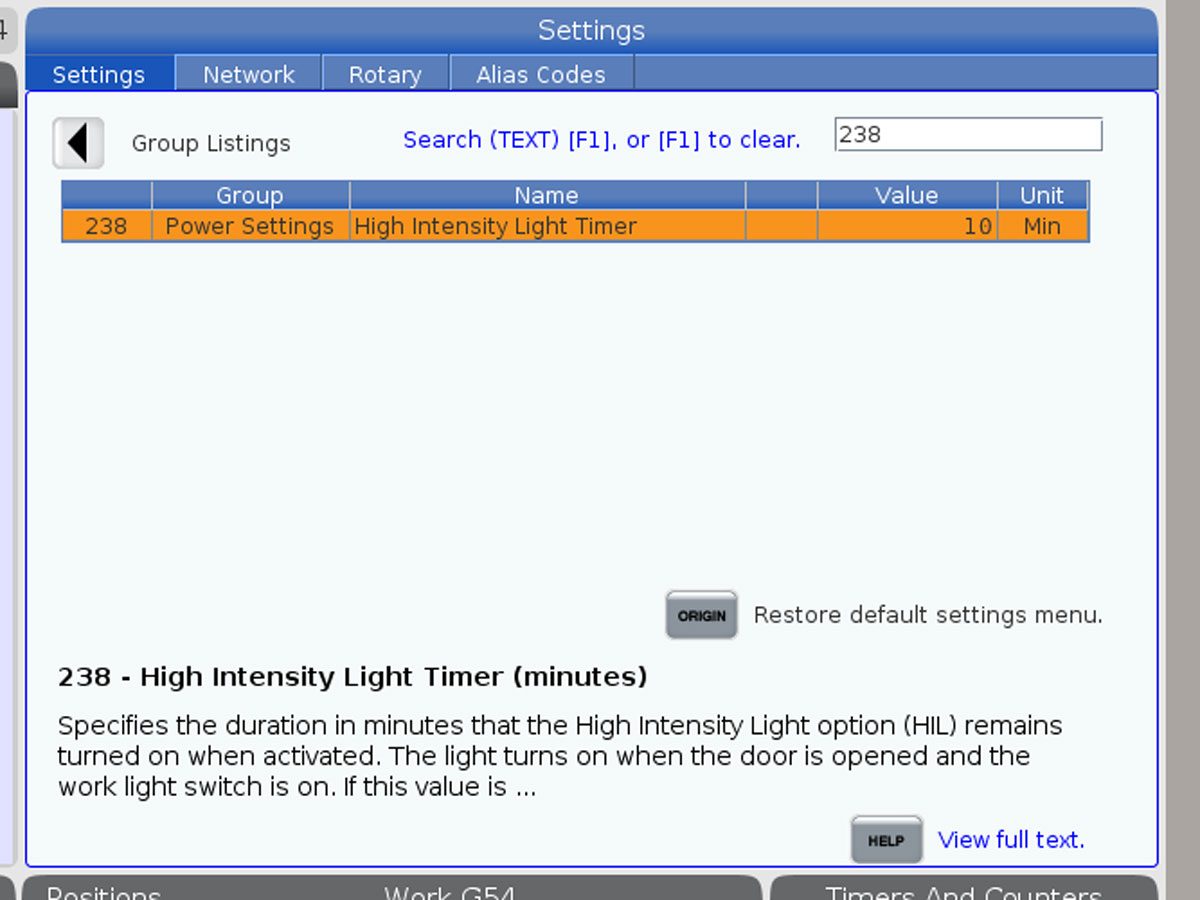

Push [POWER ON].
Change Setting 238, HIGH INTENSITY LIGHT TIMER, to 1.
Open the doors. If the HIL system operates correctly, the lights come on.
Wait one minute. If the HIL system operates correctly, the lights go off.
Change Setting 238, HIGH INTENSITY LIGHT TIMER to your preference.
