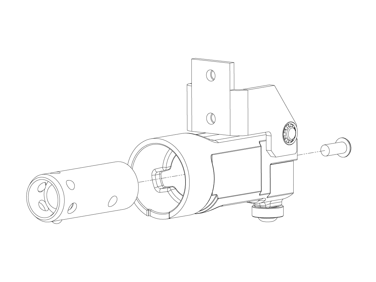

This procedure will go over how to replace the tool pocket and plungers on HSK tool changers.
Remove the number plate from the carousel.
Remove the (2) 5/16-18 bolts [1] from the carousel for the damaged pocket.
Slide the pocket assembly [2] out from under the carousel plate.
Install the replacement pocket. Torque the (2) 5/16-18 bolts [1] to 25 ft lbs. Install the number ring in the correct orientation.
To remove the plungers first remove the collect assembly.
With the collect assembly removed from the pocket, press the center cap [1] to remove the plungers [2].
NOTE: There is a spring behind the cap, be careful to make sure the cap does not shoot out after the plungers are removed.
Verify the spring is in good condition before reinstalling the plungers and collet assembly.
To reassemble follow this procedure in reverse order.
