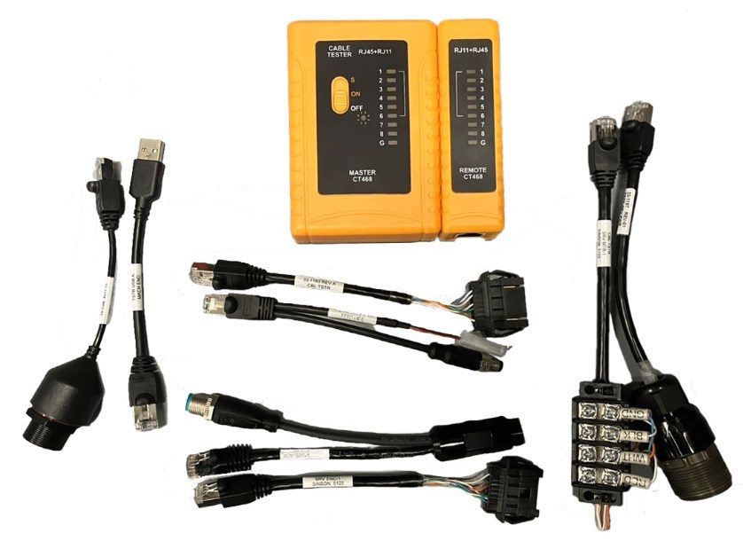

The purpose of this troubleshooting guide is to help diagnose faulty cables in a system and determine whether further troubleshooting should be done. For specific cable types, the T-0150 Cable Tester Kit is recommended to quickly assess whether a cable should be replaced.

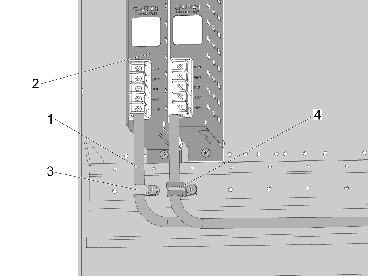

If a cable [1] going to the servo amplifier [2] has wear or damage on the cable jacket, check the type of cable clamp securing the cable to the control cabinet.
There are two types of cable clamps used on these machines are:
  • An all metal cable clamp [3]
  • A cable clamp with a rubber cushion [4].
Order the cable clamp with the rubber cushion, 59-2335 [4] if there is the all metal clamp on the servo amplifier power cable. This clamp is for a 5/16" cable and has a rubber cushion to prevent it from damaging cables.
Note: These clamps are for CM-1 and CL-1 machine models only. These clamps can be used for the X, Y, and Z-axis amplifiers on the CM-1 and the X, Z, and TT-axis amplifiers on the CL-1.

For more detail on how to use the T-0150 Cable Tester kit, refer to the instruction link below. The kit contains adapters for the common types of cables that can are tested.
Cable Tester Kit - AD0684
