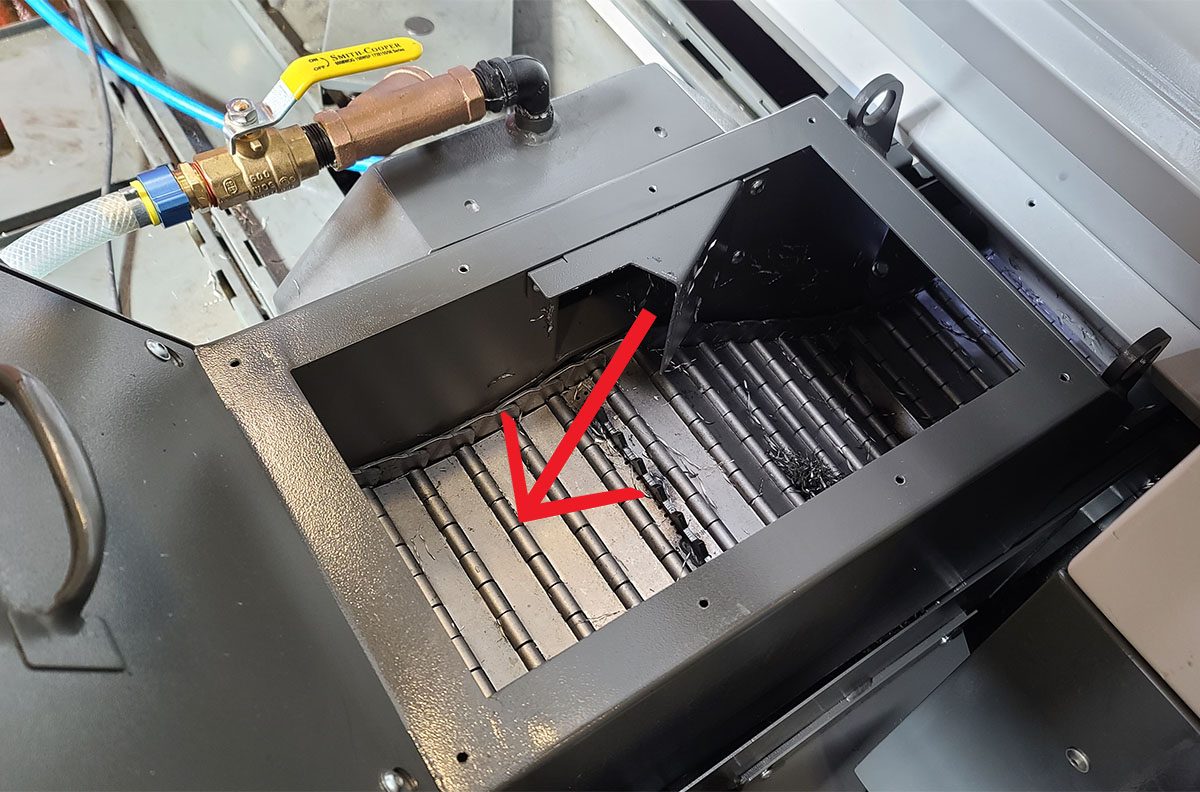

  • Integrated backwash system keeps chips on the belt for proper evacuation to chip hopper or barrel (includes additional pump)

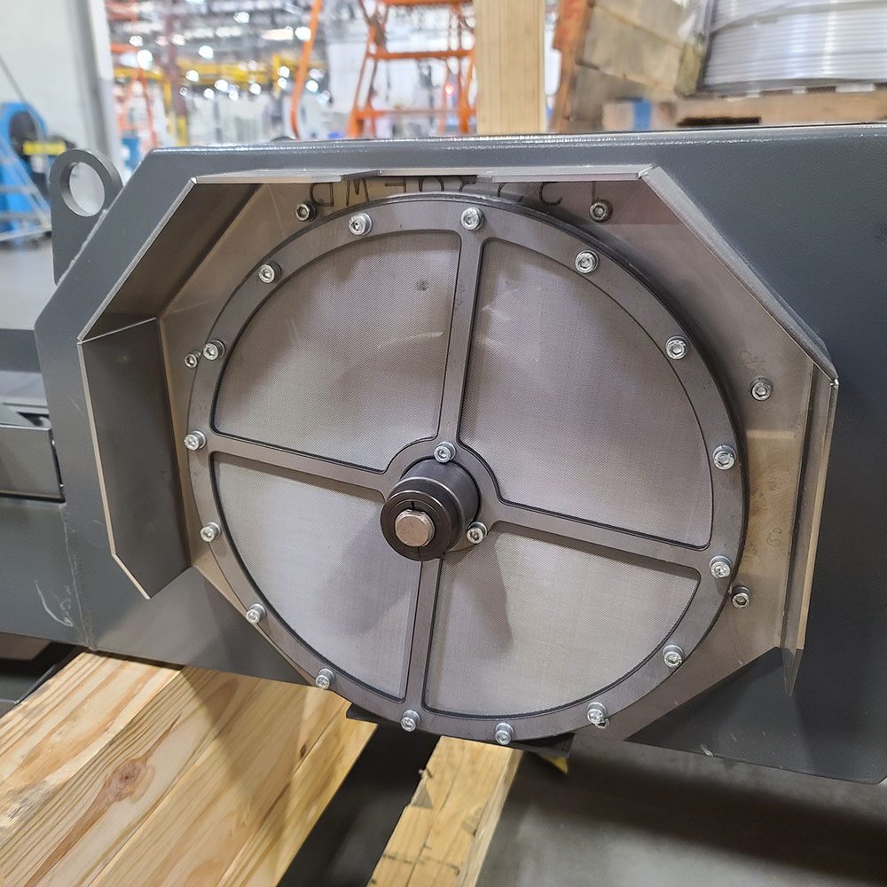

Chip Disk Filter
The filter disk (at right) rotates when the conveyor is running, and collects chips that are floating in the coolant. Coolant is pumped through the side shown to return the chips to the conveyor belt, and then out to the chip barrel.
The disk is like an oil skimmer, but for chips. It picks up the chips that are already in the coolant, and lifts them out of the tank to return them to the conveyor belt.
  • Stainless steel 24 mesh filter
  • Filters sediment larger than 0.027" (686 µm)

The CDF screen has pockets on the side that faces the inside of the coolant tank, and chips floating in the coolant are pushed into the pockets by the regular coolant flow. As the disk rotates, the chips are lifted out of the tank, and then washed back onto the conveyor belt to get evacuated.
The included pump flows coolant back through the disk filter to wash the collected chips onto the conveyor belt, so they can be carried out of the machine.
Back Wash Pump
The Chip Disk Filtration conveyor includes a separate pump for washing the chips back onto the belt conveyor and out of the machine. The pump mounts on the machine coolant tank, next to the other pump, or pumps.
  • 1/4 hp (0.19 kW) pump included
  • 6-gallon (22 liter) per minute at 10 psi (0.69 bar)
