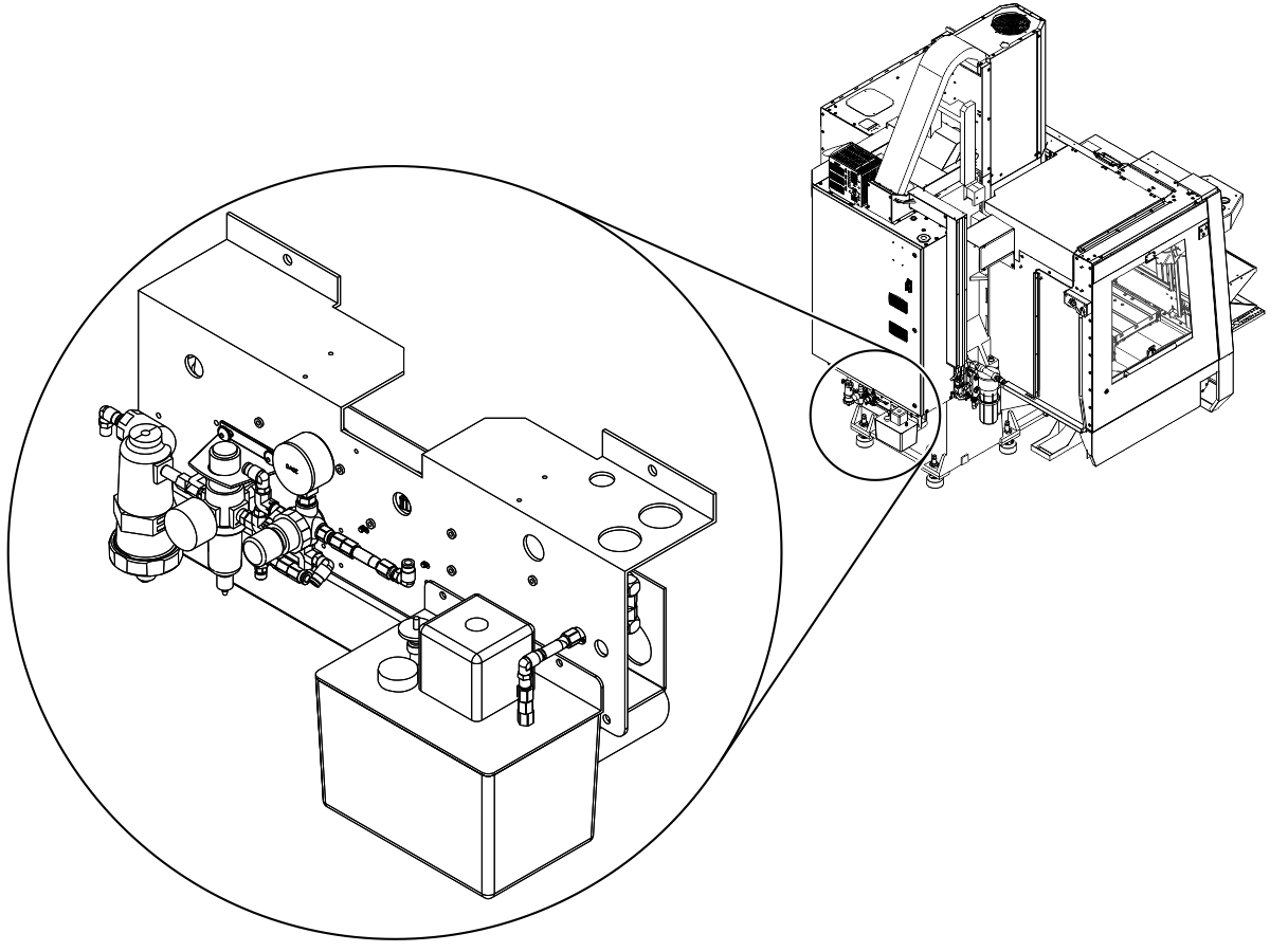

Bijur Mechanical - Oil Pump
Note: The location of the Bijuir mechanical-oil pump is different on some machines.
The Bijur mechanical-oil pump axis-lubrication system is under the control cabinet. For more information on this system, refer to the Axis Lubrication Systems - Bijur - Mechanical - Oil Pump.

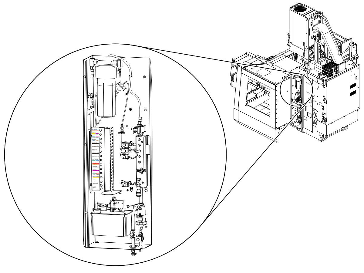

Haas Liquid Grease
Note: This systems has a grease pressure gauge [1] located next to the grease reservoir.
The Haas Liquid Grease lubrication system is adjacent to the control cabinet, inside the air-lubrication cabinet. For more information on this system, refer to the Axis Lubrication System - Minimal Lubrication System - Haas Liquid Grease.
