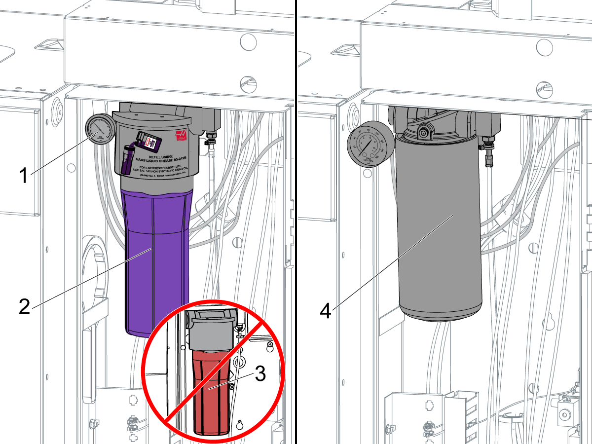

Use the illustration to identify the parts of the lubrication system.
  1. Grease Pressure Switch - Monitors the grease system pressure and sends a signal to the control to generate an alarm if the pressure drops below the minimum level too quickly.
  2. Grease Pressure Gauge - Shows the pressure (in psi and bar) of the grease system.
  3. Grease Filter Wrench - Removes the grease reservoir.
  4. Grease Reservoir Assembly - Stores the grease.

The Haas Liquid Grease reservoir has a gauge [1], and is either plastic [2] or metal [4]. Do not use Haas Liquid Grease on a machine that uses red Mobil SHC007 [3].
If the reservoir for the liquid grease does not have a pressure gauge and the grease is red, do not use purple/brown Haas Liquid Grease. This grease will not work in the red grease system. Perform the Axis Lubrication System - Grease Reservoir - SHC-007 - Refill procedure.

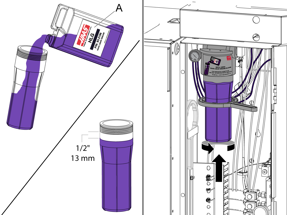

Haas Liquid Grease - Refill
Power off the machine. Close the primary air valve. This stops the air supply to the machine.
Pull the ring on the pressure relief valve on the air and lubrication manifold. This releases the air pressure from the system.
If the machine has a metal reservoir, go to Step 3.
Place shop towels under the reservoir to catch any grease that may fall.
If the machine has a plastic reservoir, use the supplied wrench to loosen and remove the grease reservoir.
Inspect the reservoir for cracks or damage. Replace the reservoir if it is damaged, chipped, or cracked.
Pour the HAAS LIQUID GREASE (HLG) [A] into the reservoir to about 1/2" (13 mm) below the threads on the reservoir.
 Note: It can be necessary to fill the reservoir again after you remove air from the system.
 Note: To prevent spills, do not overfill the reservoir.
Install the reservoir and tighten it with the wrench.
 Caution: The reservoir head has a stop. When you tighten the reservoir, do not try to tighten the reservoir after you feel it stop.
If the machine has a metal reservoir:
Remove the empty reservoir. Use an automotive oil filter wrench to loosen it if the reservoir is too tight to loosen by hand.
Pour the HAAS LIQUID GREASE (HLG) [A] into the reservoir to 1/2" (13 mm) below the threads on the reservoir.
Install the reservoir [B]. Use your hand to tighten it until the gasket makes contact with the reservoir head. Tighten another 3/4 turn.

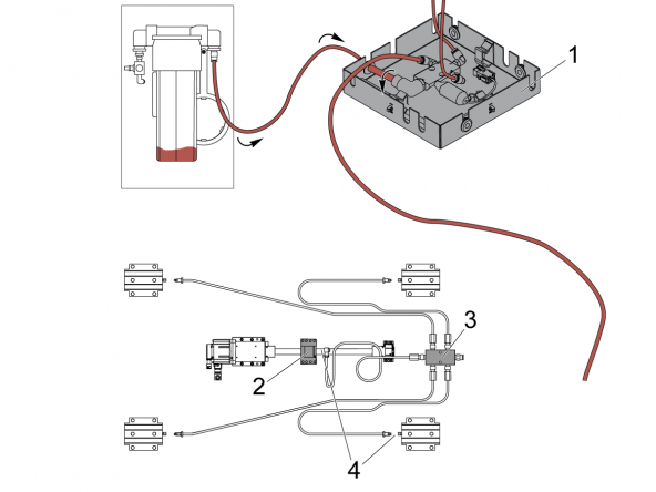

Identify the axis that has a clogged grease lines. Refer to the Haas Liquid Grease - Troubleshooting Guide.
Remove the sheet metal panels/waycovers to gain access to the axis lube manifold.
A liquid pump is used to drive oil through the lube lines to clear the obstructions. We recommend using the Haas Pump 30-7510. This is an air driven pump that can build enough pressure to clear the lube lines. An air driven pump from your local hardware store can also be used. Be sure to not exceed 3000 PSI when pressurizing the copper lube lines or you can cause them to fail. Use a pressure gauge to ensure you are at a safe pressure when operating the pump.
Remove the barb fitting [1] from the manifold. Install the 58-3657 reducer [2] and the 58-1684 JIC fitting [3] onto the manifold. Connect one end of the 59-8621 hydraulic hose to the JIC fitting [3] at the grease manifold. Connect the other end of the 59-8621 hydraulic hose to the JIC fitting [4] at the 30-7510 pump. Make sure that the ball valve [6] is in CLOSED position and connect the air supply [5]. Fill up the 30-7510 pump tank with the Mobil DTE24 oil. Open the ball valve [6] to turn ON the pump. Run the pump untll there is a steady oil flow out of each linear guide truck and the ballscrew ballnut [7]
NOTE: If any point on the system will not unplug, disconnect and plug the outputs of the points that are flowing oil using P/N 58-3015.  Apply pressure only to the points that will not unplug.  Repeat this as necessary.  If a point will not unplug after this sequence, the restrictor will have to be removed from this point to allow it to unplug.  Remove and replace the clogged restrictor.
 IMPORTANT:  Do not connect the hydraulic hose directly to the linear guide truck or ballscrew ballnut. Direct pressure can cause damage.
Once you get the steady flow of oil out of each lubrication point, stop the oil pump, remove the fittings [2] and [3] and reconnect the barb fitting [1] with the lubrication line back to the manifold.
Reinstall previously removed sheet metal panels/waycovers.
Repeat the same process for each axis.

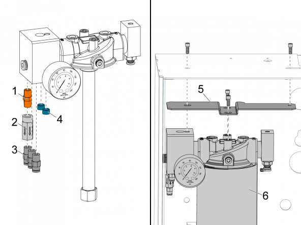

  • Replace the filter if the pick-up tube has the 40 mesh 0.625" diameter filter [1]
  • Replace with 80 mesh 0.625" diameter filter (P/N 58-1993A) [2]
  • Remove grease canister [4]
  • Remove brass fitting [3] on end of pick-up tube [1]
  • Discard old 40 mesh filter [2]
  • Clean brass fitting
  • Clean any debris from the inside of the pick-up tube and any brass from the threads
  • Install new 80 mesh filter to the fitting [2]
  • Install fitting to the pick-up tube
  • Fill the HLG reservoir with compatible lubricant to 1/2" (13 mm) below the threads on the reservoir.
  • Prime the lube lines and verify each axis is getting grease

Install fittings and new reservoir.
Install the brass nipple fitting [1], check valve [2], and hose fitting [3] to one of the ports on the grease manifold.
Install the other two hose fittings [3] to open ports on the grease manifold.
Install the two plugs [4] in the remaining two open ports.
Remove the red grease reservoir assembly.
Install the Haas Liquid Grease reservoir assembly and air tube. Use the bracket [5] to install the assembly to the lubrication cabinet. Install the metal reservoir with Haas Liquid Grease [6].
Connect the pressure switch cable to the pressure switch behind the grease manifold.

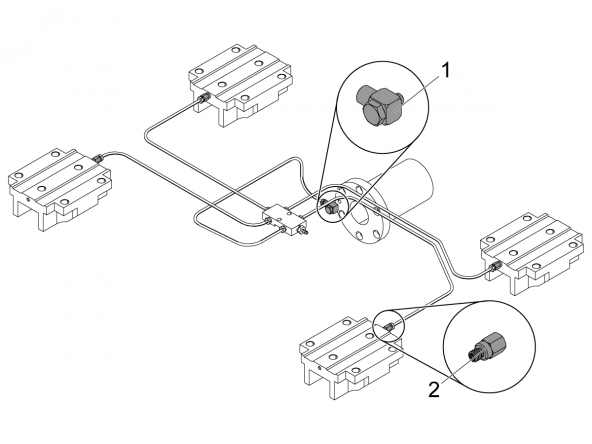

Install the banjo and restrictor fittings.
Remove the fittings at the ballscrew and at each linear guide truck.
Install the banjo fitting [1] at the ballscrew port. Torque the banjo fitting to 10 in-lbs. Be very careful here; if you exceed 10 in-lbs you will break the banjo bolt.
Install the restrictor fittings [2] at each linear guide truck port.
Torque the restrictor fittings as follows:
  • For linear guide brand Rexroth: 15 in-lbs
  • For linear guide brands INA, NSK, and THK: 12 in-lbs

  2. Metal Canister Grease Reservoir
  3. Plastic Canister Grease Reservoir

  • Ensure there is enough grease in the canister to run a test

  • Go to the lube cabinet and disconnect the plastic tube for the axis you are testing
  • Blow pressurized shop air into the tube and see if this will clear the clog
  • If the clog does not clear refer to the Haas Liquid Grease - Purge Clogged Lines procedure.

  • Check for contamination in the pick-up tube within the canister assembly [1]
    • Un-screw the grease canister [4]
    • Remove the brass fitting [3] that holds the mesh screen [2] in the pick-up tube and clean with a rag and alcohol
