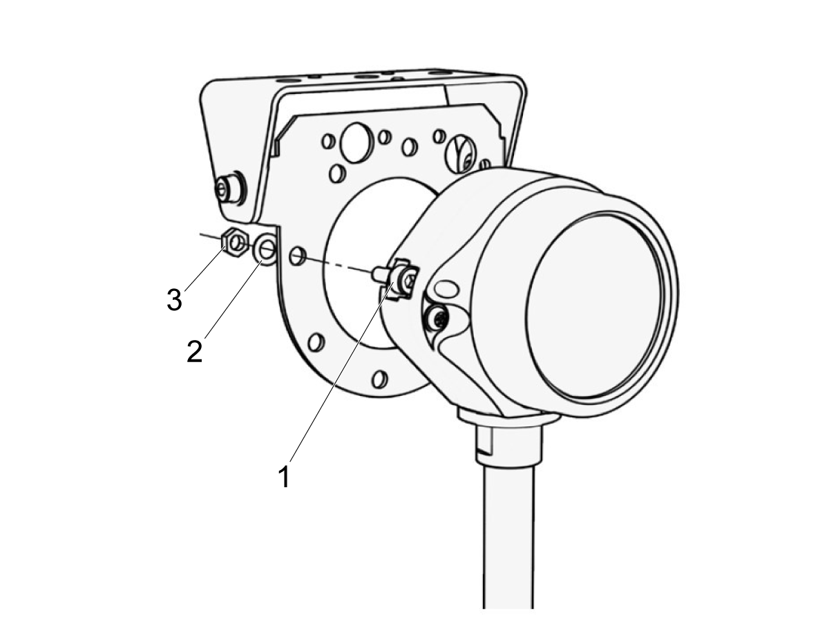

Secure one bracket to the OMI using two 10-32 x 3/8 SHCS.
Secure the other bracket to the machine enclosure wall using one 1/4-20 x 1/2 FBHCS.
Attach the wall bracket to the OMI/bracket assembly using two 8-32 x 3/8 SHCS.

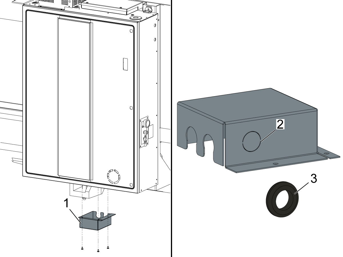

Route the OMI cable through the top of the control cabinet as shown, depending on the installation performed [1].
Join the OMI cable and 33-0625 cable plugs [2].
Plug the Haas probe cable 33-0625 into P7 on the I/O PCB board [3].

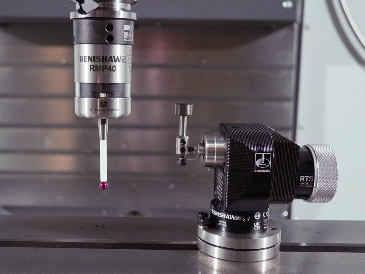

Renishaw - OMP40-2 Probe - Installation
Install the stylus [1] into the probe body.
Use the stylus installation tool [2] to tighten the stylus [1] into the probe body [3].
Turn the tool until the stylus is snug.
Use a coin or flat-head screwdriver to remove the battery compartment cover [3].
 Note: Do not touch the stylus after installing the batteries. Touching the stylus can change the settings.
Install batteries [4] into the battery compartment.
Install the battery compartment and tighten the cover.

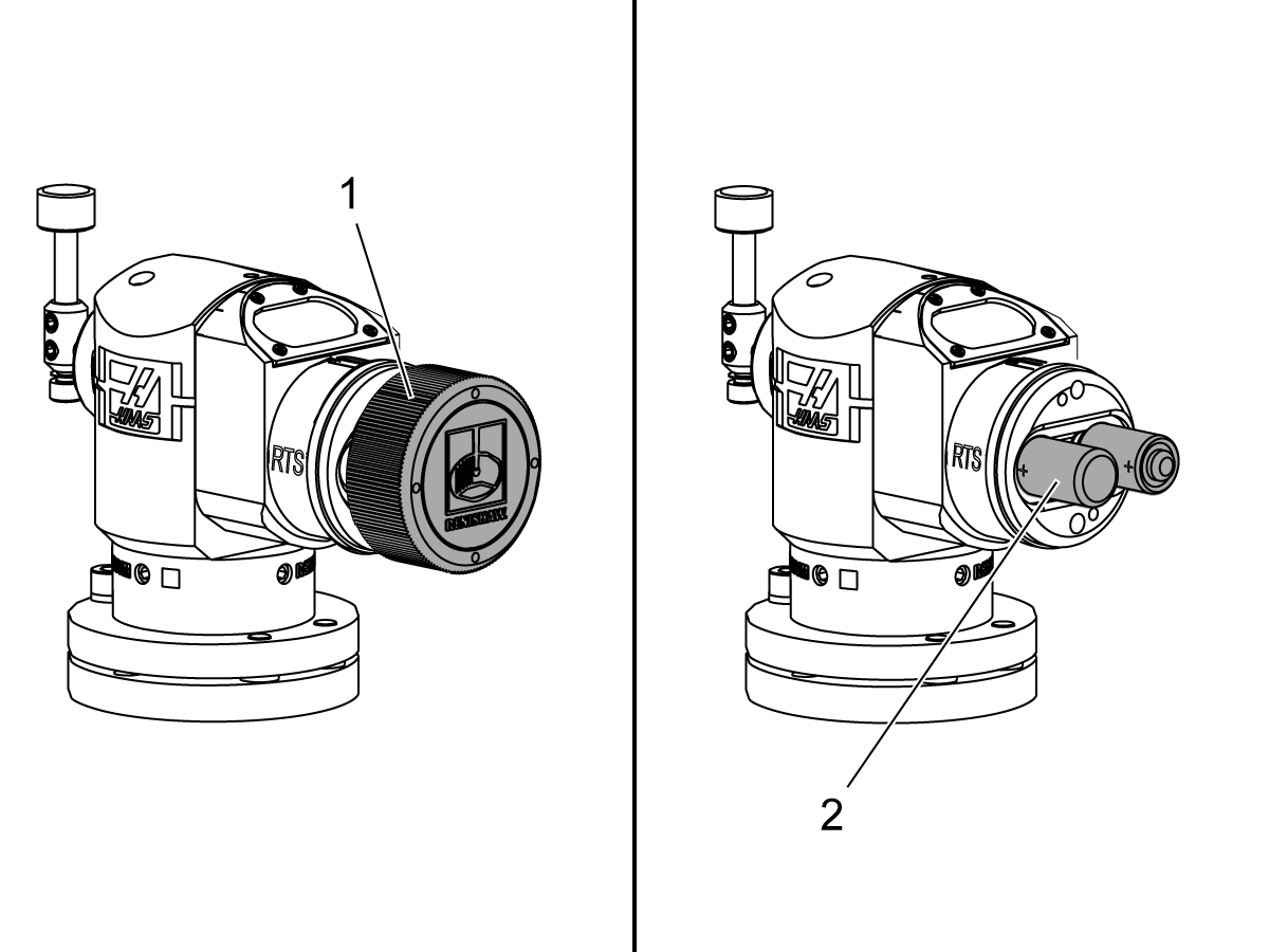

Install the batteries:
 Note: Do not touch the stylus when you install the batteries. This can change the settings.
Remove the battery cover [1].
On new probes, make sure to remove the plastic shield between the batteries [2] and the contacts.

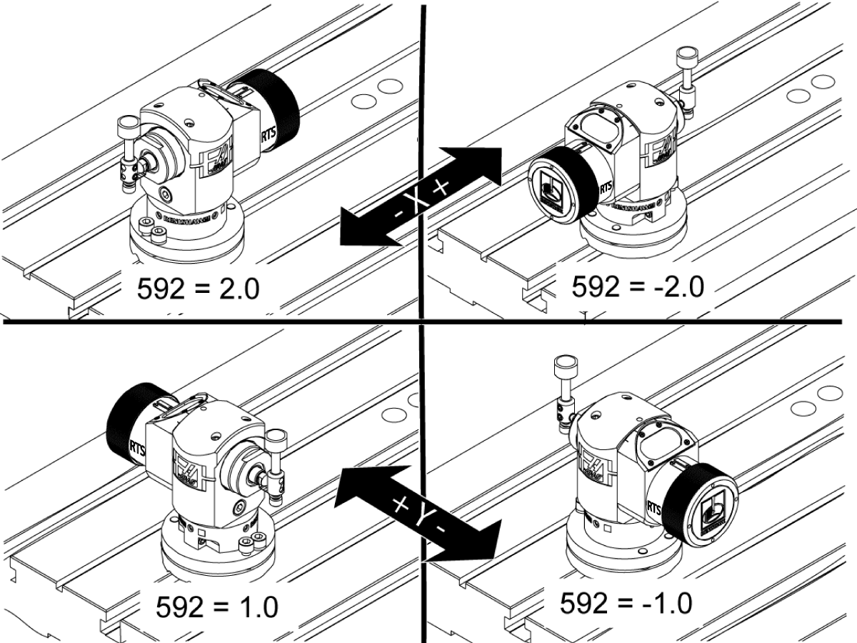

Set the direction of the OTS tool probe:
Macro variable 592 changes the radius offset direction. Change macro variable 592 to make sure the tool does not hit the probe body when it moves off center to compensate for the tool radius.
When you use the WIPS calibration pages to calibrate the probe, this will automatically sets macro variable 592 to 2.
When you use VQC calibration pages to calibrate the probe, you can select 2 or -2 for macro variable 592.
If the probe is installed in a different direction, you must change macro variable 592. This lets the tool move away from the probe during the rotating tool length cycle.
Set macro variable 592 to agree with the direction of the probe. These are the correct values:
#592 = 1.0, diameter along the X Axis setting: rotating length cutter radius offset setting in the Y- direction.
#592 = -1.0, diameter along the X Axis setting: rotation length cutter radius offset setting in the Y+ direction.
#592 = 2.0, diameter along the Y Axis setting: rotating length cutter radius offset setting in the X- direction.
#592 = -2.0, diameter along the Y Axis setting: rotation length cutter radius offset setting in the X+ direction.

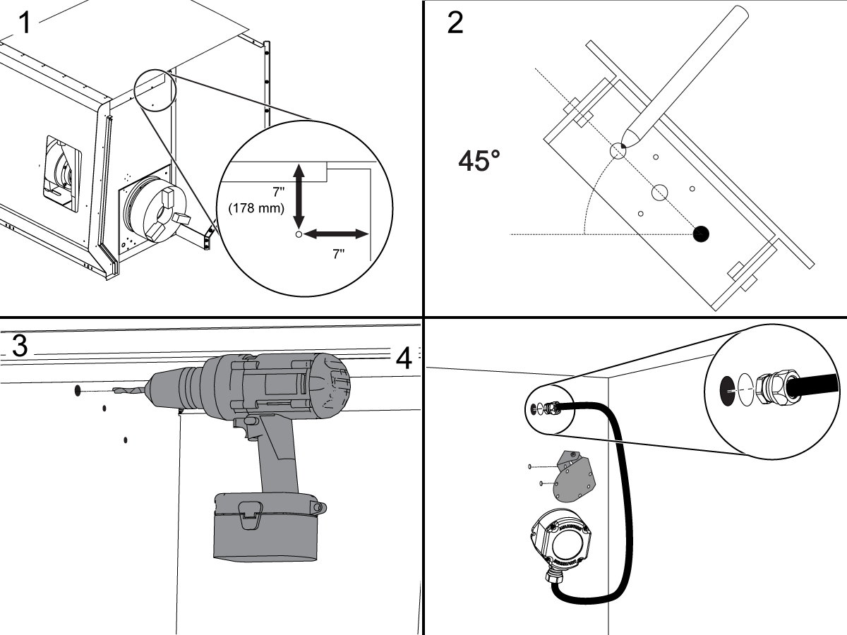

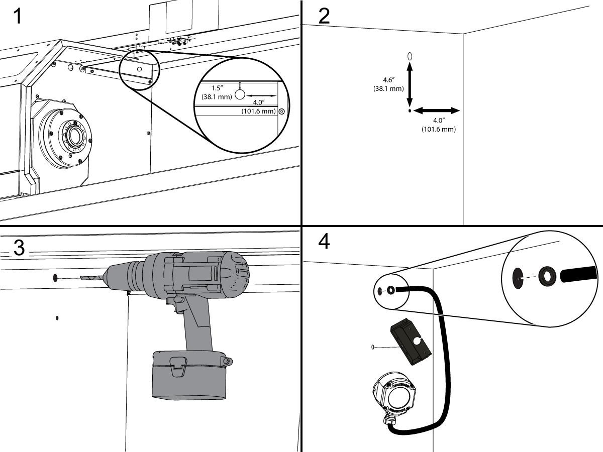

[1] On the spindle-side of the bulkhead cover inside the lathe, put a point mark approximately 7" (178 mm) from the top of the panel and 7" from the far side of the cover.
[2] Temporarily put the OMI bracket onto the bulkhead in the correct position as follows: Point the triangular pattern of dimples down. Keep the right-side hole aligned with the mark, while you turn the bracket approximately 45 degrees clockwise. Put a mark for the second hole.
[3] Drill (2) 9/32" (7 mm) holes through the bulkhead at the point marks. Drill a 7/8" (22 mm) hole through the bulkhead, approximately 1" (25 mm) above and 3" (76 mm) to the left of the top 9/32" (7 mm) hole.

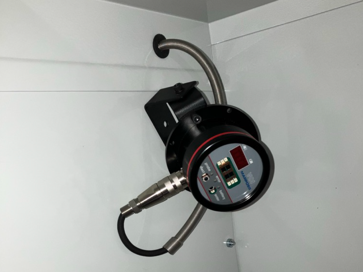

[4] Pull the OMI cable through the 7/8" (22 mm) hole in the bulkhead panel. Put the appropriate grommet from the kit over the cable and install it into the bulkhead. Install the OMI bracket with the screws and nuts on the other side of the bulkhead. Apply sealant to the screws. Install the OMI unit onto the bracket so the cable is oriented down.

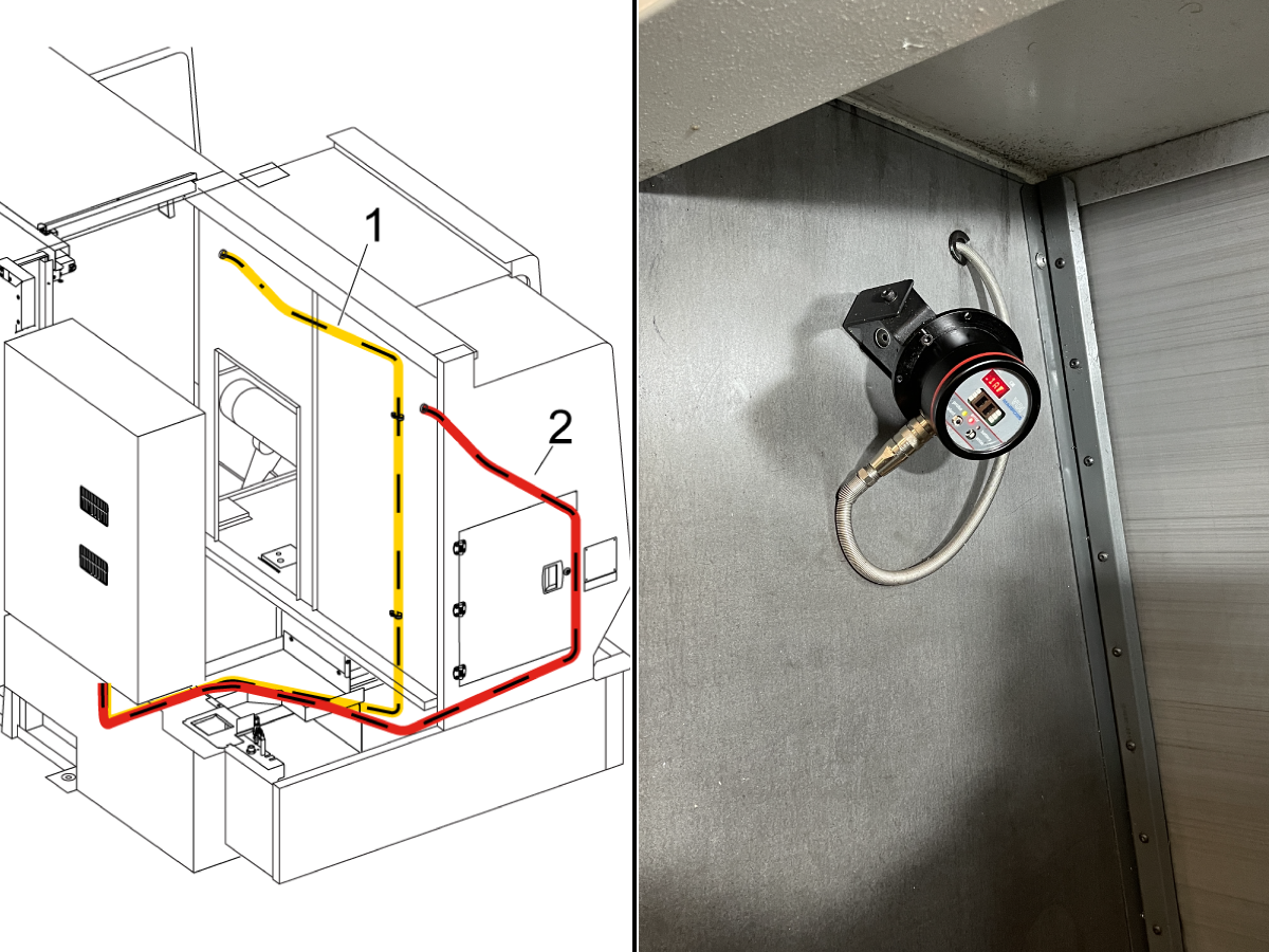

Route the OMI cable [1] through the enclosure to the control cabinet and make sure there is a loop to limit the coolant collecting on the cable and the OMI.
Connect the splitter cable (P/N: 33-0619A) [1] to P7 [2] on the SIO PCB.
Connect the OMI cable [3] to the 6-pin connector of the splitter cable.
 NOTE: Disregard the label on the 33-0619A cable that states to connect it to the P77.

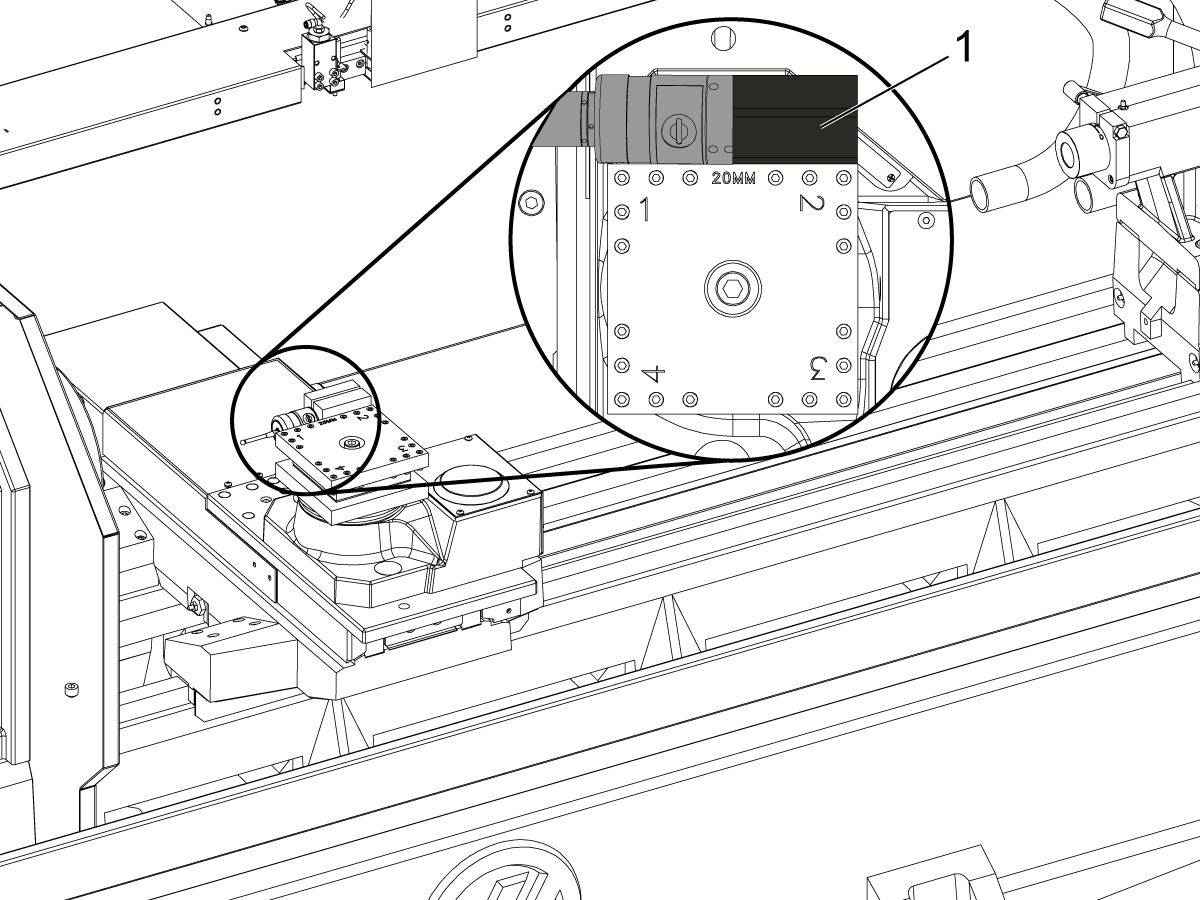

NOTE: You will need a 1 inch or 25 mm boring bar holder [1] to install the Work Probe [3] onto the turret. The probe kit does not include the tool holder. Refer to theHaasParts.com to purchase the correct tool holder.
Install the boring bar holder [1] onto desired turret station.
Move the X axis into the position when the tool holder centerline is aligned with the spindle centerline.
NOTE: This position is stored in the settings 319, 320, 321 under the User Positions tab. These settings are set from the factory. If you have a BOT or the BMT tool holder use setting 320. If you use a VDI toolholder use the setting 319.
Attach the probe [3] to the arbor [4] using four setscrews with the flat tip [5] and two setscrews with the tapered tip [6]
 IMPORTANT: Install the setscrews with the flat tip [5] into the four holes that are closer to the probe. Install the setscrews with the tapered tip [6] into the two other holes.

TL - WIPS-L Installation
[1] On the spindle-side of the bulkhead cover inside the lathe, put a point mark approximately 1.5" (38 mm) from the top of the panel and 4" (102 mm) from the far side of the cover.
[2] Mark a second hole for the OMI bracket approximately 4.6" (38 mm) below and 4.0" (102 mm) from the far side of the cover where the point that was marked in image [1]
[3] Drill a 7/8" (22 mm) hole through the bulkhead  Drill A 9/32" (7 mm) hole through the bulkhead at the point mark in image [1]. Drill a 7/8" (22 mm) hole through the bulkhead at the point mark shown in image [2].
[4] Pull the OMI cable through the 1/2" (13 mm) hole in the bulkhead panel. Put the appropriate grommet from the kit over the cable and install it into the bulkhead. Install the OMI bracket with the screws and nuts on the other side of the bulkhead. Apply sealant to the screws. Install the OMI unit onto the bracket so the cable is oriented down.
Machines built before 06/06/24 will need to drill out a 1.4" (35.56 mm) diameter hole [2] as shown on the lower cable cover [1] and install the grommet (P/N: 59-7221) [3].
NOTE: Machines built before 06/06/24 need to order the grommet P/N: 59-7221 as it does NOT come in the field install kit P/N: 93-1000245.
Cable (P/N: 33-0619A) [1] should be routed through the bottom lower cable cover [2] and through the enclosure [3] secured by (2) cable clamps [4].
Route the OMI cable [1] through the bulkhead enclosure panel.

NOTE: You will need a 25mm tool holder which will need to be purchased seperately to install the Work Probe onto the turret. The probe kit does not include the tool holder. Refer to HaasParts.com to purchase the correct tool holder.
  • TT4 - Metric: 20-3265
  • TT4 - Inch: 20-10938
IMPORTANT: WIPS-L must be used with a safe tool change postion and held in the correct pocket to avoid collisions with door, coolant spout, and tailstock.
The recommended position with the safe tool change zone is by placing the tool holder farthest to the right on the TT4 turret as shown in the image [1].
7
Attach the probe [2] to the arbor [3] using four setscrews with the flat tip [4] and two setscrews with the tapered tip [5]
Attach the stylus [2] to the probe [3].
Install the coaxial indicator [9] onto the chuck.
Keep the tool holder centerline inline with the spindle centerline and sweep the probe stylus tip with the indicator. Keep the tapered setscrews [5] snug and adjust the flat setscrews [4] until the stylus tip is inline with the spindle centerline NTE 0.0005" (0.0127mm). Make sure all of the setscrews are tight when the alignment is done.

RMI-QE - Installation
If WIPS - RF did not come installed on your machine a Haas Service tech must download and apply the new configuration file.
The RMI-QE detects probe signals up to 49.2 ft (15 m) from the RMI-QE window. Position the RMI-QE such that the optimum range can be achieved from both the tool probe and the work probe over the entire machine travel range. If a rotary, fixture, or workpiece occludes line of sight between either probe and the RMI-QE during a probing cycle connection can be decreased or lost. If the connection is lost, the system will alarm out. Plan your machine setup to avoid this. On some large machines it may be necessary to elevate the tool probe off the table using a riser.
Secure the wall bracket to the machine enclosure wall using two 1/4-20 x 1/2 FBHCS.
Secure the RMI-QE to the wall bracket using two 10-32 x 3/8 SHCS [1], two flat washers [2], and two nuts [3].
 Note: Do not touch the RMI-QE glass window with your hands as this can affect the transmission performance.
Route the RMI-QE cable through the top of the control cabinet as shown, depending on the installation performed [1].
Join the RMI-QE cable and 33-0625 cable plugs [2].
Renishaw - RMP40 Probe - Installation
If the probe is not yet installed to the toolholder, follow the below steps, otherwise skip to Step 3:
Loosen the all the set screws in the probe toolholder [1].
 Note: The (2) top set screws hold the probe body into place. Make sure the (2) top set screws in the probe toolholder are conical.
Insert the probe body [3] into the toolholder [1].
Use the hex wrench [2] to snug the (2) top set screws.
Use the hex wrench [1] to slightly loosen the (4) adjustment set screws.
Insert the RMP40 probe [2] into the spindle.
Place an indicator [3] onto the center of the stylus ruby.
Adjust the “A” screws in sequence and monitor alignment, loosening on one side and tightening on the other, bringing the probe into alignment.
When probe is aligned to within 0.0002”, tighten each “B” screw while tightening opposing “A” screw, each to no more than 0.5 ft-lb. Re-verify alignment and tighten the remaining “A” screws.
Verify the battery polarity is correct.

Set the direction of the RTS tool probe:
