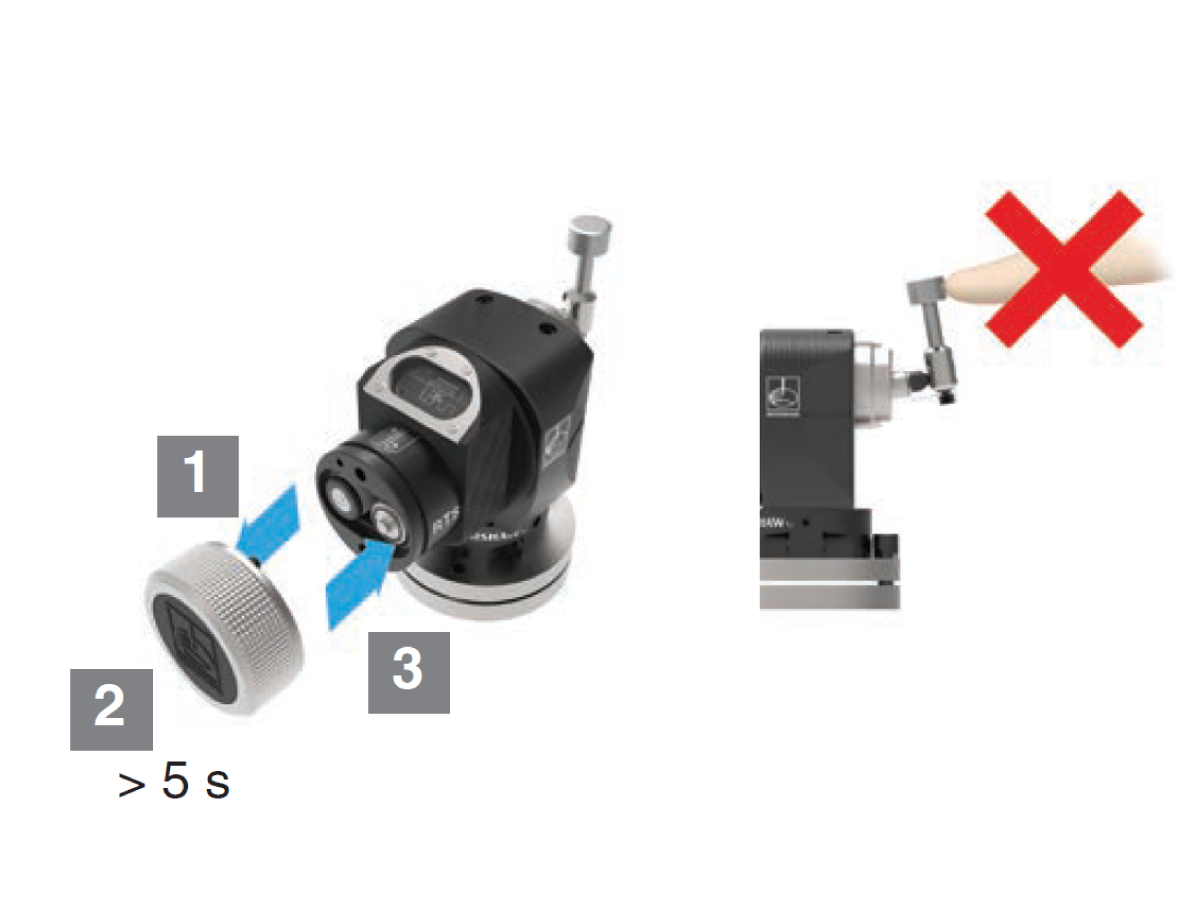

Renishaw Table Probe - Renishaw Table Probe contains two 1/2 AA 3.6V batteries.
Unscrew the battery cover/holder from the battery compartment located on the side of the probe. Remove both 3.6V batteries, insert new ones and replace cover/holder
NOTE: For future reference, write the date on new batteries before installing them. Batteries in the work probe have a life span of about 8 months and batteries in the table probe have a life span of about 10 months.
NOTE: Do not touch the stylus after installing the batteries. Touching the stylus can change the settings.

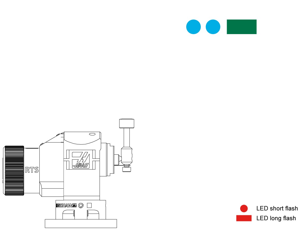

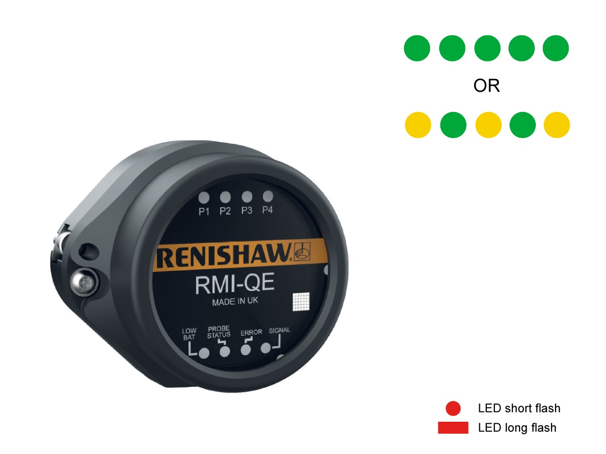

Renishaw Probe – WIPS-RF - Pairing Process
Revision A - 05/2025
This procedure shows how to pair the RMP40 and RTS probes with the RMI-QE interface.
  • Load the pairing program onto the machine.
  • Insert the batteries in the probe. If they have already been installed, remove them for five seconds and then reinstall them.
  • The LED check will flash: red, red, green, green, blue, blue or red, green, blue.
  • The probe will then show the probe settings and end with the "Battery Status". If the battery power is good, the battery status will be eight green flashes. If the battery power is low, each green flash will be followed by a blue flash.
  • While the "Battery Status" is being displayed, deflect and then release the stylus.
  • Press [CYCLE START] to run the pairing program, once the stylus has been triggered, to run the O09601 RMP40 or O09602 RTS program.
  • The probe will display a series of cyan lights followed by a long yellow light when the probe and the RMI-QE are ready to pair.

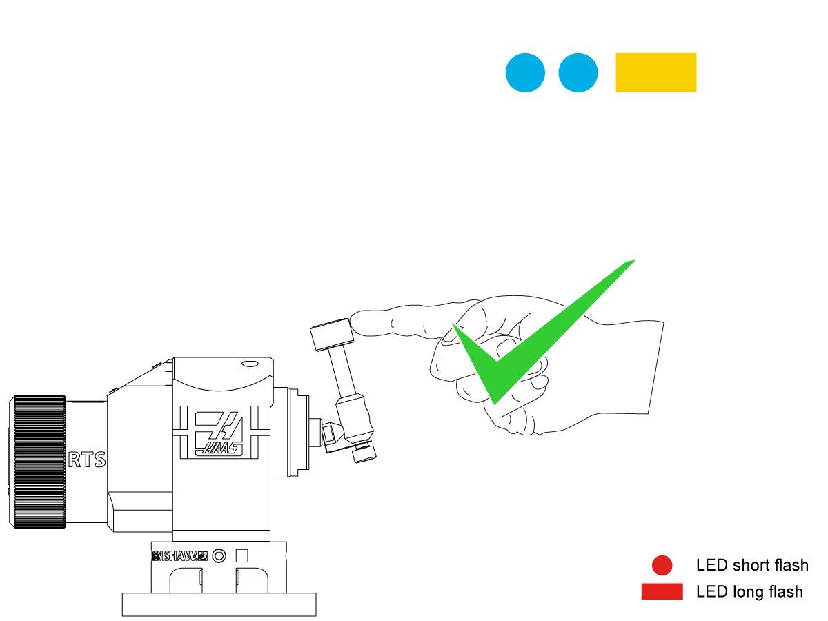

  • Deflect the probe stylus for less than four seconds after the long yellow flash.
  • A successful pairing is indicated by a cyan, cyan, green flash. The probe will timeout after 20 seconds and then go into standby mode.
  • If the "Partnering mode on" is not selected, the probe will time out after 120 seconds and will go into standby mode. The process will need to be repeated to pair the probe to the RMI-QE.

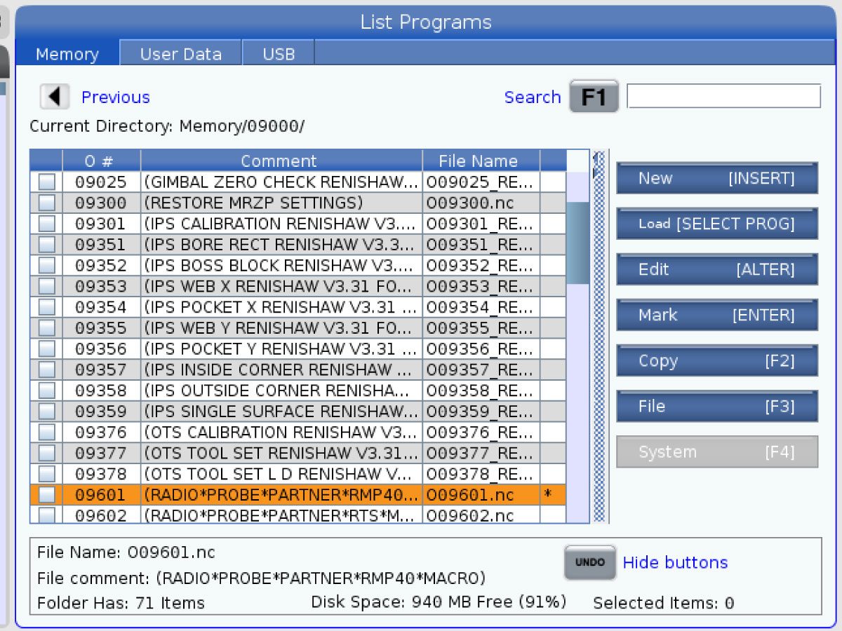

RMP40 Pairing
To pair a RMP40 probe with the RMI-QE, load the pairing program O09601 into the memory.
Press [LIST PROGRAM].
Go into the O9000 files.
Find O09601 and load it by pressing [SELECT PROGRAM].

Remove the batteries from the RMP40.
Wait 5 seconds.
Place the batteries back into the probe.
 Warning: Do not deflect the probe stylus at this time.

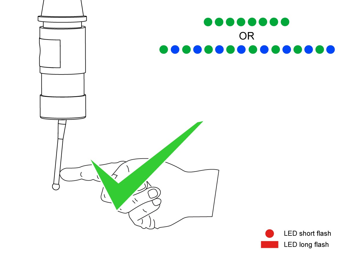

Wait for the RMP40 to show one of the following LED checks:
or

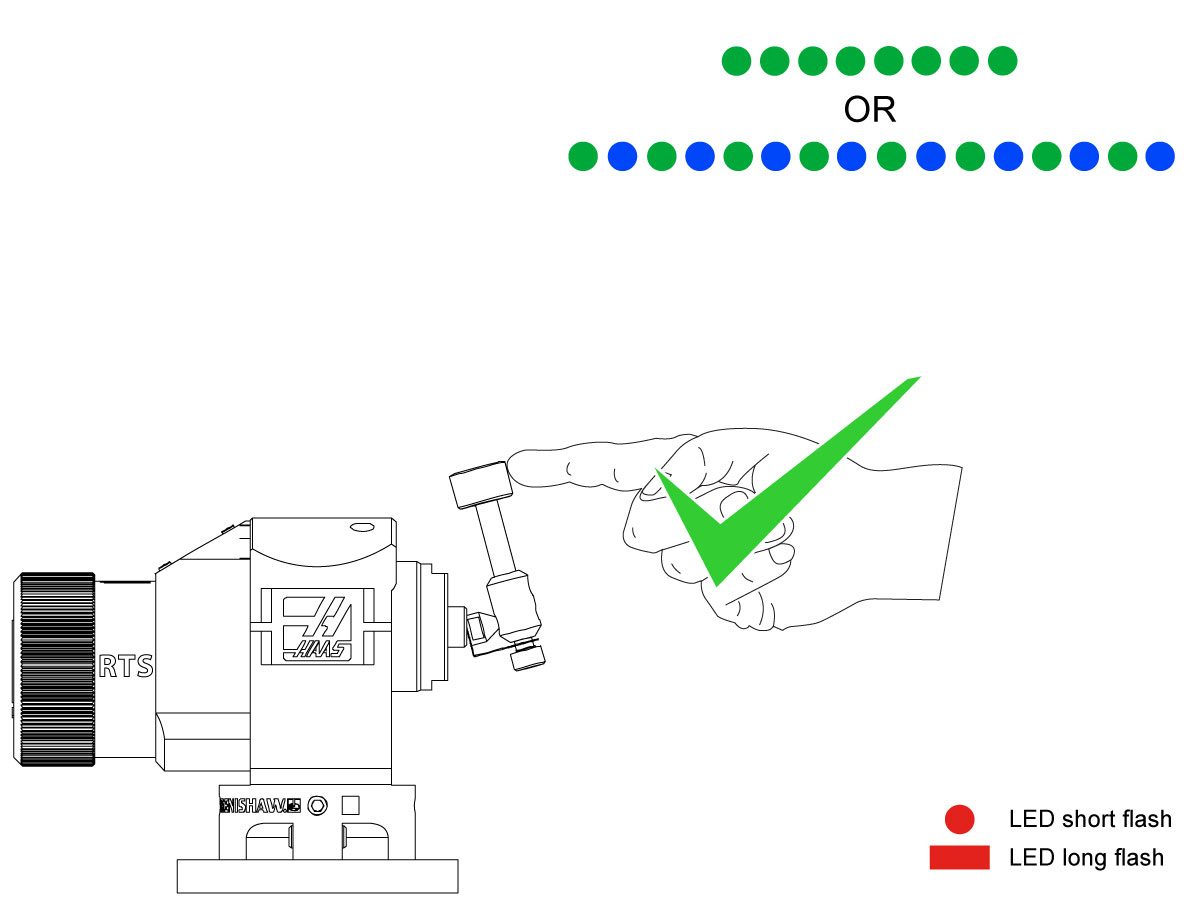

The probe will then show the probe settings and end with the "Battery Status". Eight green flashes indicates good battery power while a green light followed by a blue light eight times indicates low battery power.
LED Battery status:
or
Once the three green lights flash in a row (or green, blue, green, blue for low battery) deflect and then release the stylus.

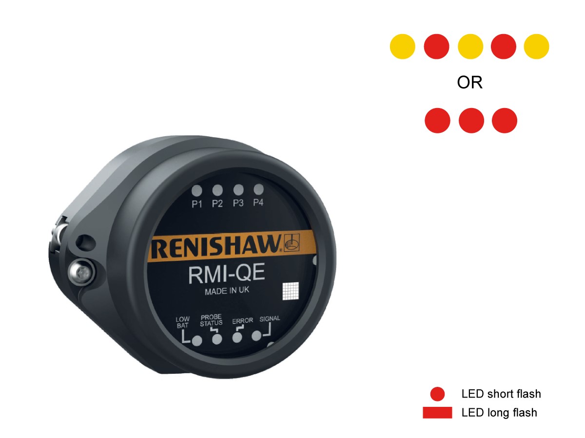

During the program the RMI-QE will display the following LED System Status:
, , , ,  (Pairing mode with empty probe location)
or
, , , ,  (pairing mode with full probe location)
6

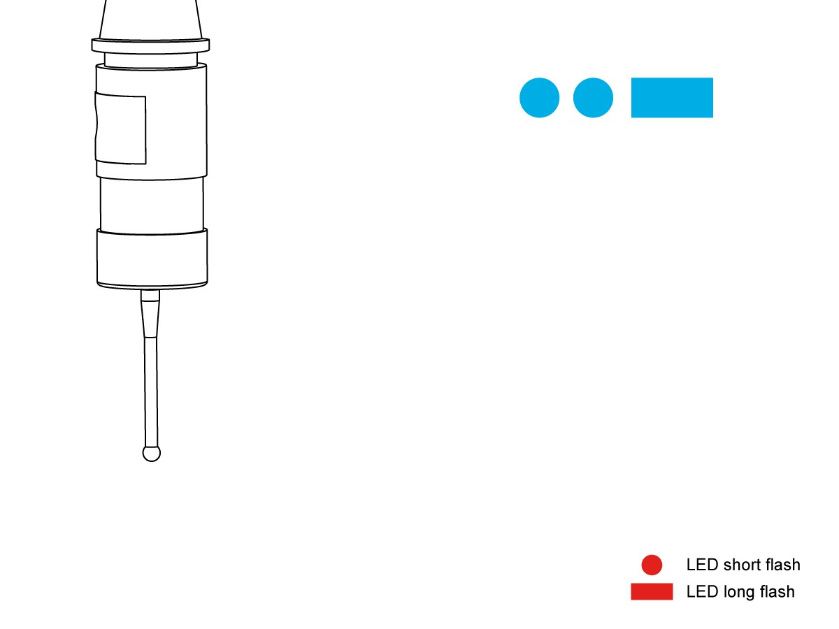

As the program finishes the RMP40 LED status will change to the following LED status when the RMI-QE is found:
Deflect the stylus for less than 4 seconds, after the RMI-QE is found.
7
The RMI-QE should change from "Partnering pending", flashing green, to one of the following LED System Status:
, , , ,  (New radio probe partnered)
or
 ,  ,   (Radio probe cleared from location)
8

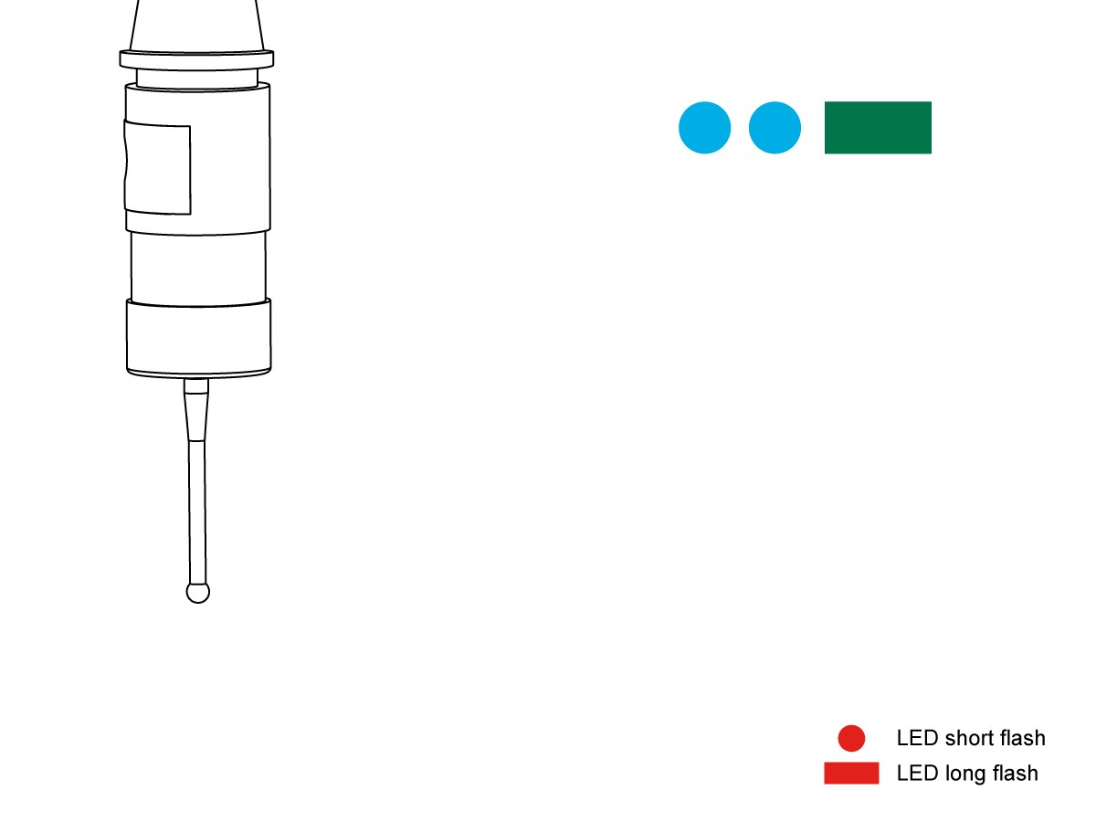

When the RMP40 has successfully paired with the RMI-QE it should display the following LED status:
Use the steps in the verification steps below to test that the RMP40 has successfully paired to the RMI-QE.

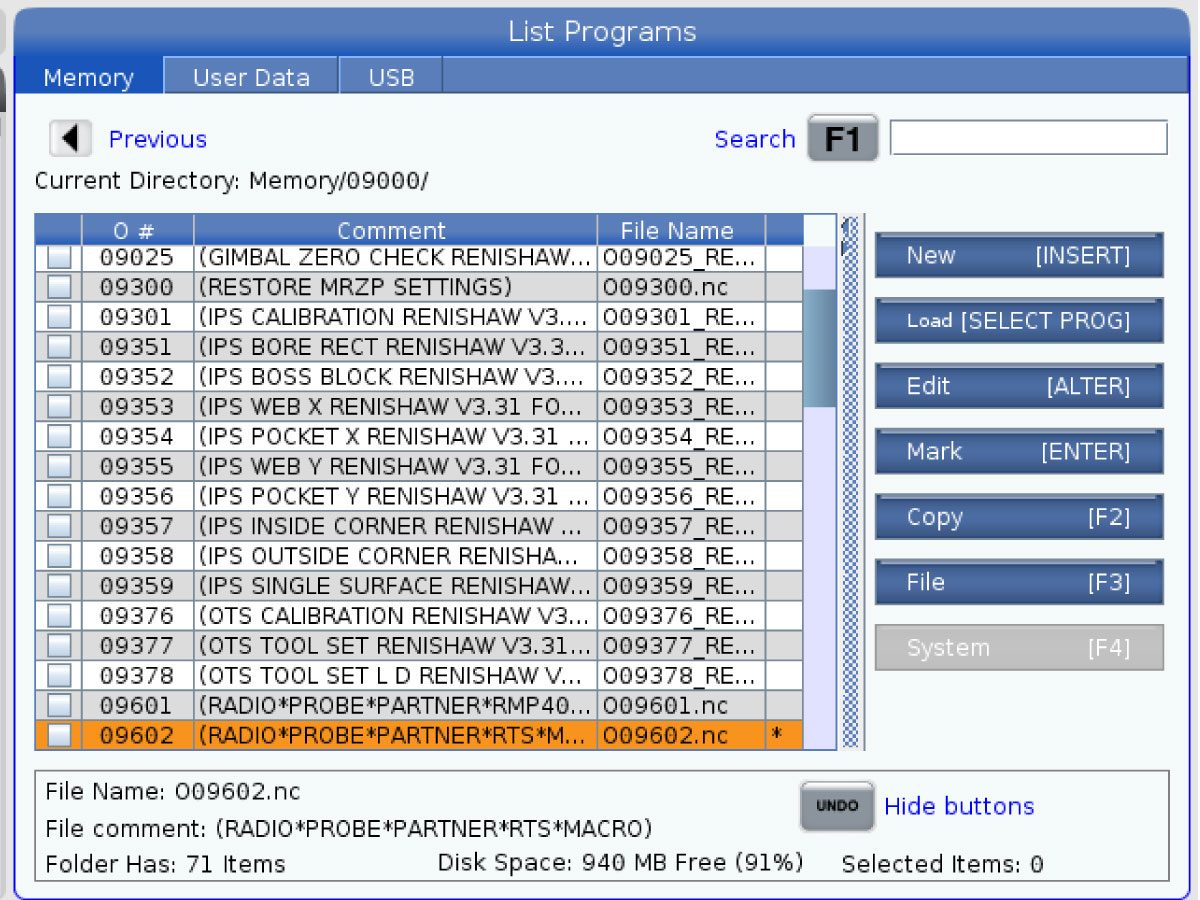

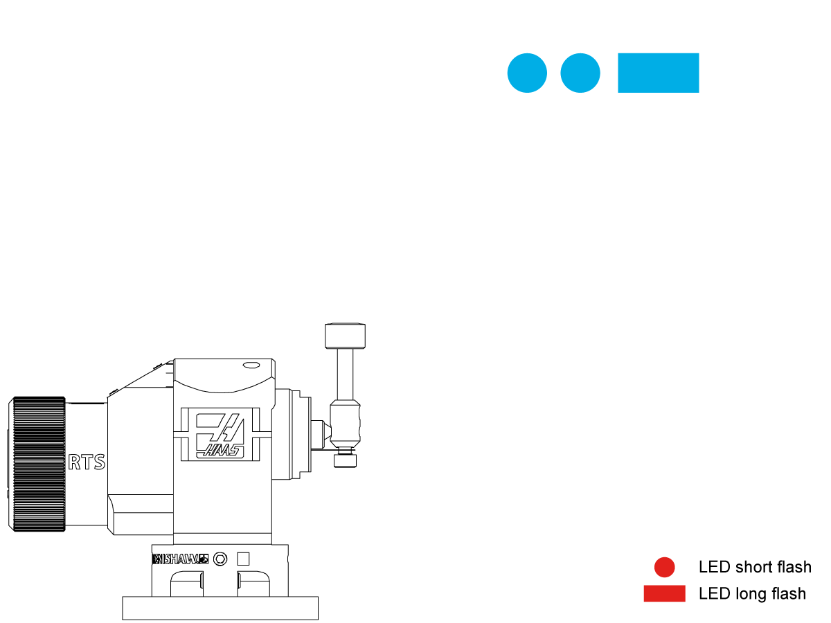

RTS Pairing
To pair a RTS probe with the RMI-QE, load the pairing program O09602 into the memory.
Find O09602 and load it by pressing [SELECT PROGRAM].

Remove the batteries from the probe.
Wait 5 seconds.
Wait for the RST to show one of the following LED check:
or
The Battery Status will be displayed after the LED check and probe setting review has been completed. Eight green flashes indicates good battery power while a green light followed by a blue light eight times indicates low battery power.
Wait for the RTS to show the following LED Battery status:
or
Press [CYCLE START], once the stylus has been triggered, to run the O09602 program.
 Note: The program should be running while the RTS enters pairing mode. LED Pairing mode Status:
or

The RTS LED status will change to the following LED status when the RMI-QE is found:
Ensure this is done within 60 seconds of the RMI-QE system status LED flashing green.

When the program has finished the RTS should display the following LED status:
Use the steps in the verification steps below to test that the RTS has successfully paired to the RMI-QE.

Renishaw – WIPS-RF - Radio Machine Interface (RMI) - Lights Information
Overview
The probe has (8) LEDs. The LEDs flash in different colors and different lengths of time. The sequence that the LED flashes tells you the probe settings.
The LEDs flash these colors:
  • Red
  • Green
  • Blue
  • Yellow
The LEDs flash a short or a long time. In the tables that follow, a small colored circle shows that the LED flashes a short time . A rectangle shows that the LED flashes a long time .
Look at the probe LEDs. Record the color and length of time that the LEDs flash.
The meaning of the color and the length of time that the LED flashes is important. Refer to the table for the meaning.
Number in the Illustration LED Name LED Color This tells you this information:
1 Probe 1/2/3/4 OFF Probe number empty
Yellow  Probe number full, in standby
Green  Probe number full, in operating
Red  System Error. See Installation Guide
Yellow , Yellow , Yellow  Selection error
Green , Yellow , Green , Yellow , Green  Parnering/clearing pending, full
Green , Green , Green  Partnering pending, empty
Red , Yellow , Red , Yellow , Red  Partnering complete, probe full
Green , Red , Green , Red , Green  Probe authentiction error
Red , Red , Red  Clearing complete, probe empty
2 Signal LED OFF  No probes operating
Good communications
Poor communications
Red , Red , Red  Overload error
3 Error LED OFF No error
Red  Error
Red , Red , Red  System error. See Installation Guide
Overload error
4 Probe Status LED Red  Prode triggered
Green  Probe seated
Overload error
5 Low Battery LED OFF Battery is okay and no M code start/stop in progress
Red  Battery low
Green  M code start/stop in progress
Yellow  Battery is low and M code start/stop in progress
 Notes:
  • The Probe Status LED is always illuminated when power is present at the RMI-QE.
  • All LEDs report the status of the partner radio probe. if there is no partner or the partner is off, then the Probe Status and Error LEDs will illuminate red. The Low Battery and Signal LED will be off.
  • When the RMI-QE is powered on, each of the eight LEDs will flash orange in sequence starting from the top left and finishing at the bottom left. After this it will enter the acquire partner mode. This is indicated by a flashing green Signal LED. After approximately 60 seconds it will switch to its normal mode listening for its partner.

The probe has (2) LEDs. The LEDs flash in different colors and different lengths of time. The sequence that the LEDs flash tells you the probe settings.
  • Red
  • Green
  • Blue
  • Yellow
  • Cyan
  • Purple
The LEDs flash a short or a long time. In the tables that follow, a small colored circle shows that the LEDs flash a short time . A rectangle shows that the LEDs flash a long time .
The meaning of the color and the length of time that the LEDs flash is important. Refer to the table for the meaning.

, ,  The trigger filter is off. This is the initial setting for Haas machines.
, ,  The trigger filter is on with a nominal 6.7 ms delay to the probe output.
