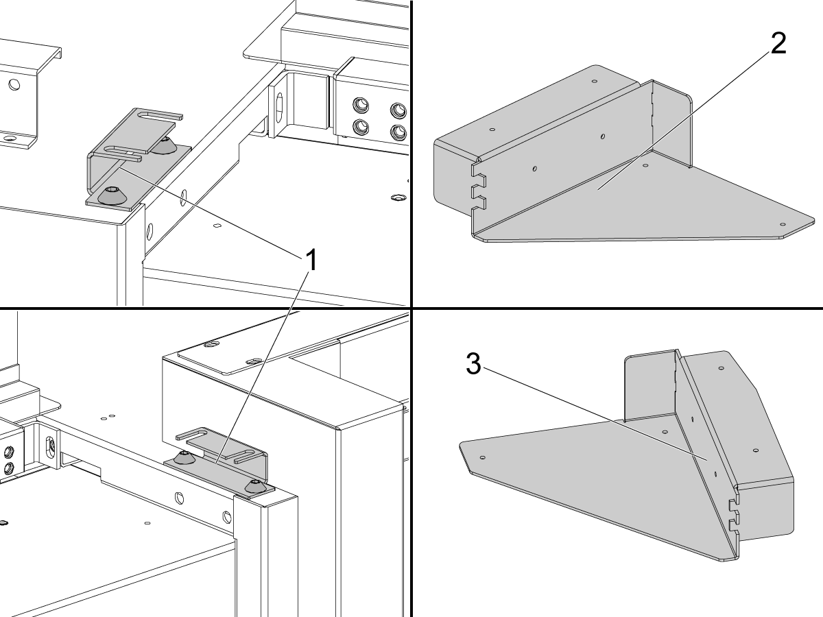

This kit contains 2 drill templates, 1 for the right and 1 for the left door. The left [2] and right [3] door templates are shown in the image.
Note: If the machine doesn't have the autodoor adapter brackets [1] then both the 93-4987 and the 93-1001099 kits will need to be ordered to install autodoor. If the machine has the brackets [1] and the other holes to mount the drive assembly and the track, then you only need the 93-1001099 install kit.

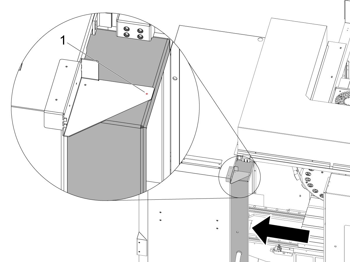

Place the left door drill template [1] on the corner of the enclosure.
Make sure the drill template is pushed fully against the edges of the enclosure so that the holes don't have to be re-drilled to have the drive assembly aligned.
Close both doors together. Make sure that the doors are being held together by the magnets.

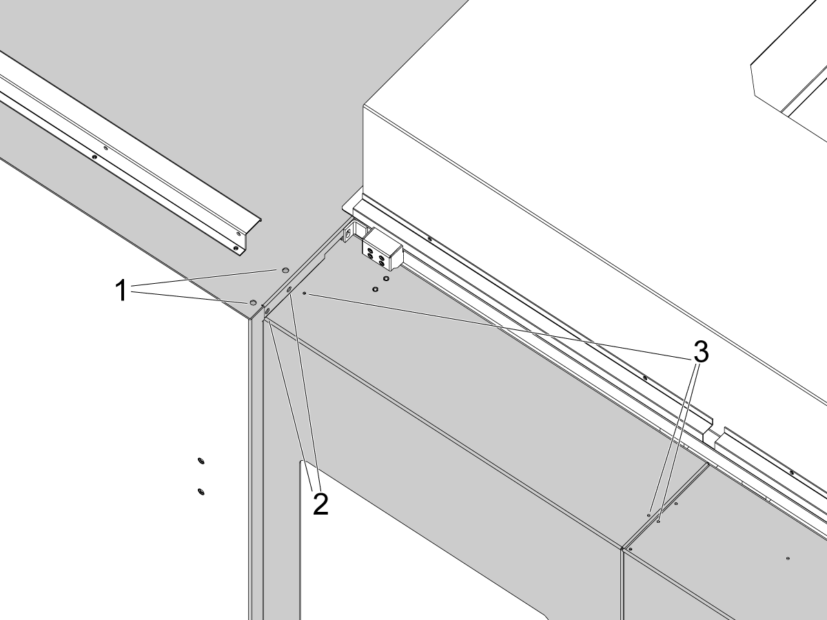

Mark the following hole locations on the enclosure with the door in the closed position:
  1. The top 2 holes [1] for the autodoor adapter brackets
  2. The side 2 holes [2] for the autodoor drive assembly
  3. The inside edge hole [3] in the top of the door for the autodoor track
Note: Make sure that the autodoor track hole [3] is marked with the door in the fully closed position.
Important: Keep the drill template in the same position after these holes are marked. Continue to the next step.

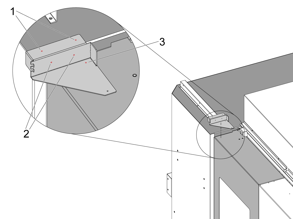

Fully open the left door while the drill template is in the same position as the previous step.
Once the door is fully opened, mark the autodoor track hole [1].
Repeat both step 1 and 2 for the right door.
Note: Make sure you are using the right door drill template which is different from the one used on the left door. Once both the left and right sides have all the drill holes marked, continue to the next step.
At this point all hole locations on the enclosure and left/right doors should be marked.

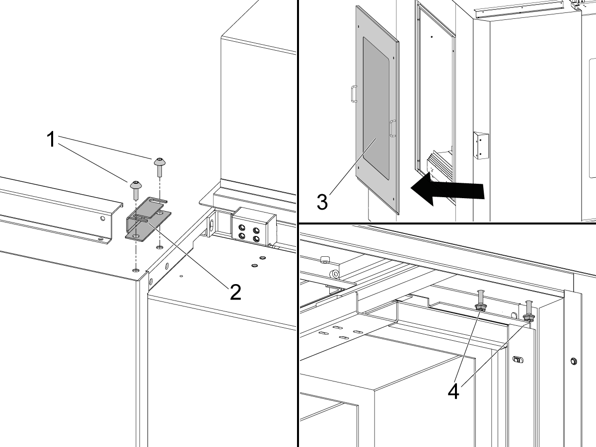

For the 2 holes on the top [1] and the 2 holes on the right edge of the enclosure [2], use a 3/8" drill to make holes in the sheet metal.
Note: These holes are for the screws for the adapter bracket and the 1/4" studs of the autodoor drive assembly.
For the 2 holes on the top of the door sheet metal [3] use a 5/32" drill to make the hole that is used to mount the autodoor track.
Note: Drill these holes on both the right and left doors.
Fasten the autodoor adapter brackets [2] to the enclosure using two 1/4"-20 BHCS [1].
Remove the window from the side of the machine so that you can access the inside of the enclosure.
Secure the brackets in place using 1/4"-20 nuts [4] on the screws holding the adapter bracket.
Note: The left door is shown in the image, but this step needs to be done for both the right and left door.
After all the holes are drilled and the adapter brackets are installed, you can continue to installing the autodoor kit. All the autodoor components are included in the 93-1001099 Autodoor Field Install Kit. Refer to AD0513 - Can Autodoor Installation for instructions on how to install the autodoor kit.
