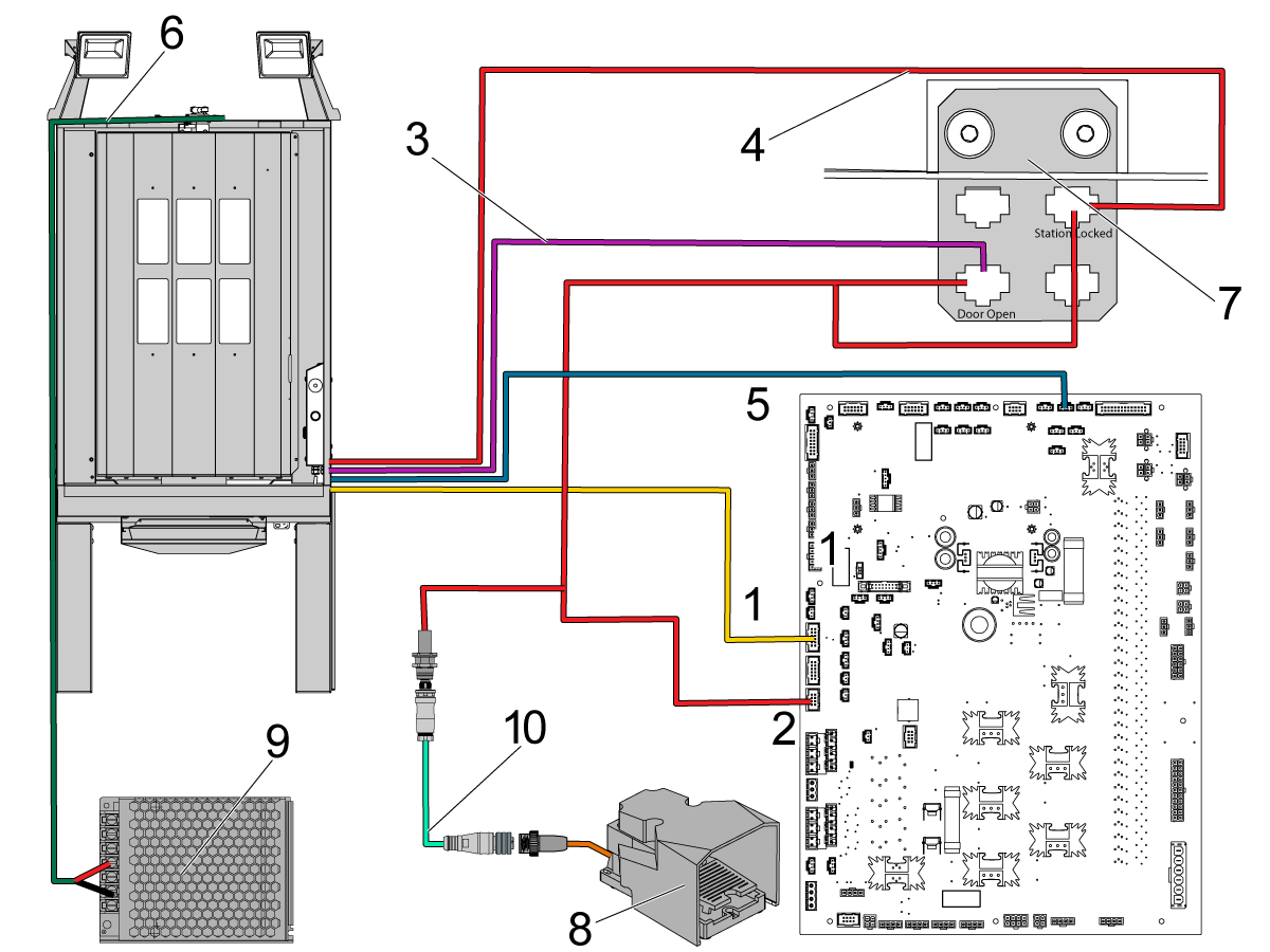

Remove the bottom cable cover [1] from the control cabinet [2].
For machines purchased with the RPL option, cables will be coiled inside the cover.
Note: RPL's being added to an existing machine will have to install these cables. These are included in the field install kit for the zero point ready.
Connect the cables to the load station cable bracket [3] which is located as shown in the image.
The cables coming from the load station are connected to the bracket in the previous step [7], or routed all the way to the control cabinet. Make sure the following cables are connected:
  1. 33-2565 - Connect to P12 on IOPCB.                              Note: Make sure to remove jumper from P12                           on the IOPCB before installing the cable.
  2. 32-1303 - This is connected to P14 on the IOPCB. One end connects to the cable bracket at the Door Open label and the Station Locked label. The other end is connected to the cutout at the skirt of the machine where the foot pedal connects. If there is already a cable routed to this connector it needs to be replaced with the 32-1303 cable.
  3. 32-1286 - Connects to the foot pedal assembly [8] and then also to the connector of the cable 32-1303.
  4. 32-1304 - Connect to the cable bracket at the Door Open label
  5. 33-1308 - Connect to the cable bracket at the Station Locked label
  6. 33-1482 - Connect to P50 on the IOPCB (pallet alarm).
  7. 33-5838 - Connect work lights to splitter on top of load station. And then connect to work light power supply [9].
Note: The foot pedal assembly [8], cable 32-1286 [10] and the 32-1303 [2] cables are found in the Zero Point Installation kits.
Route the cables and hoses going to the load station and robot through the cable conduit [1] on the machine side of the pallet.
