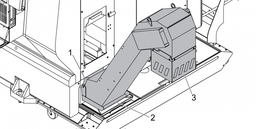

Chip Conveyor - Field Installation - Introduction
  1. Conveyor Trough Cover
  2. Drip Tray
  3. Safety Skirt

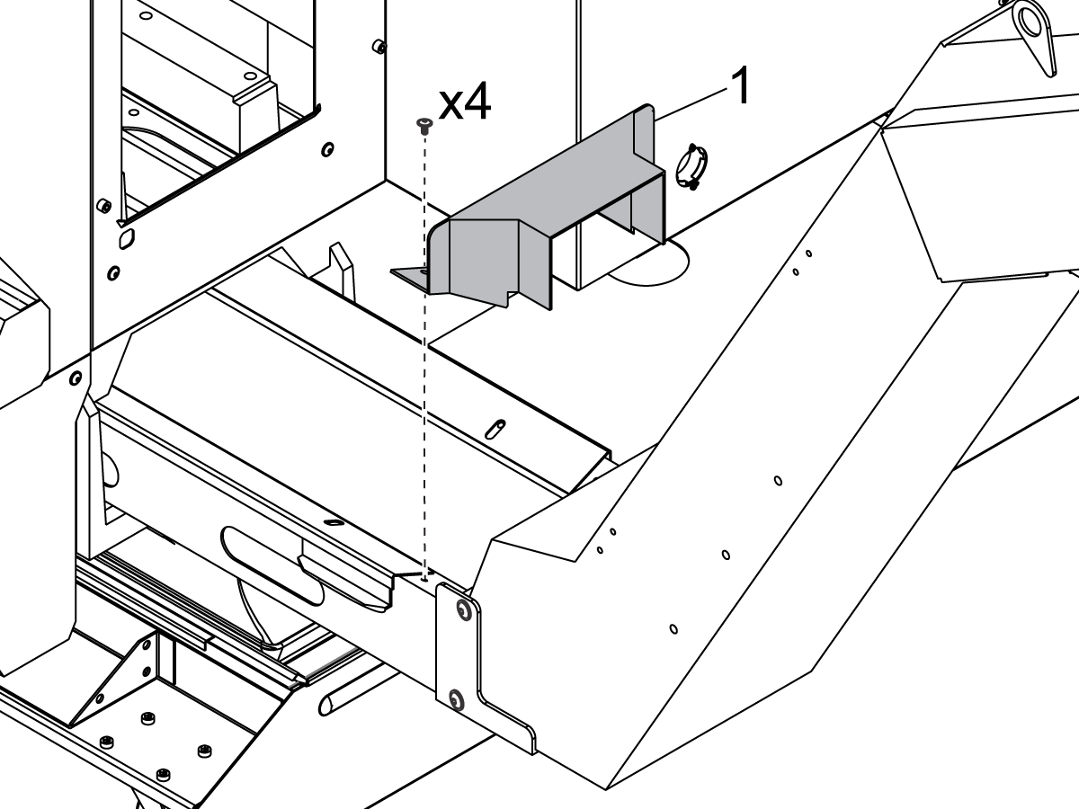

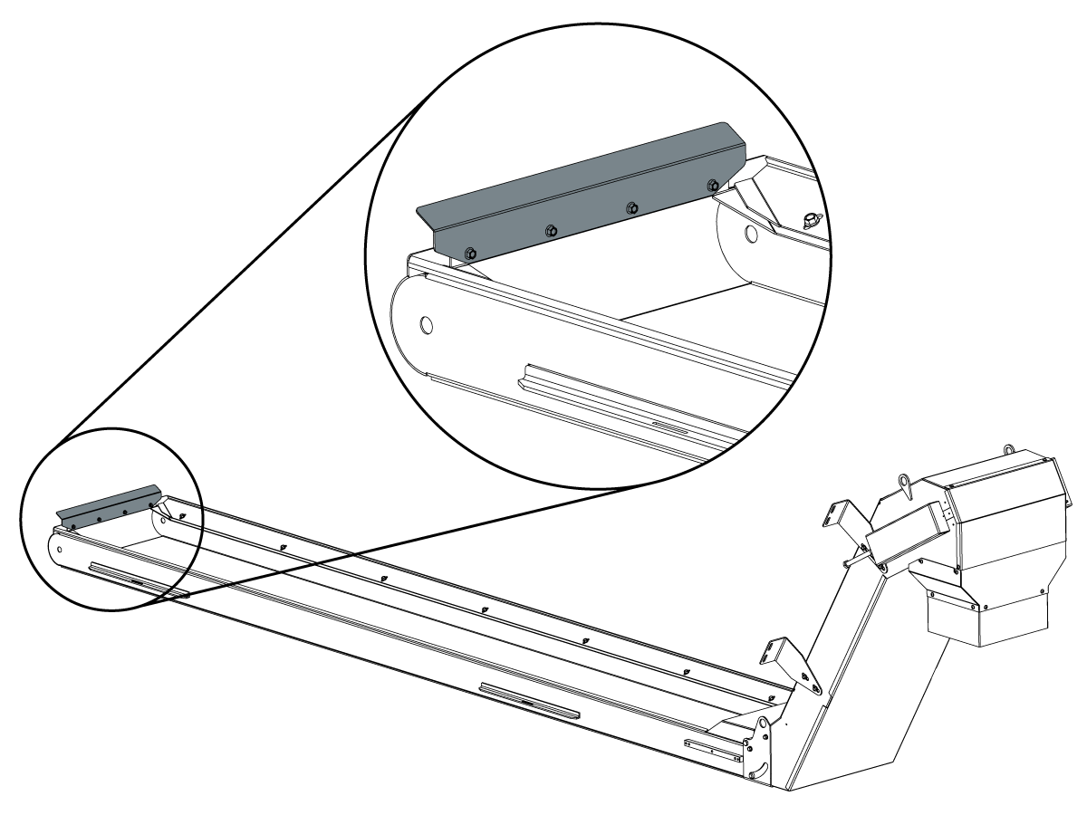

Attach the trough cover [1] to the CHIP CONVEYOR.
For a Jorgensen conveyor, install the (8) hex head screws and washers to attach the trough cover and lock the conveyor in the operating position as shown.
For a Hennig conveyor, install the (4) hex head screws and washers to attach the trough cover and lock the conveyor in the operating position.

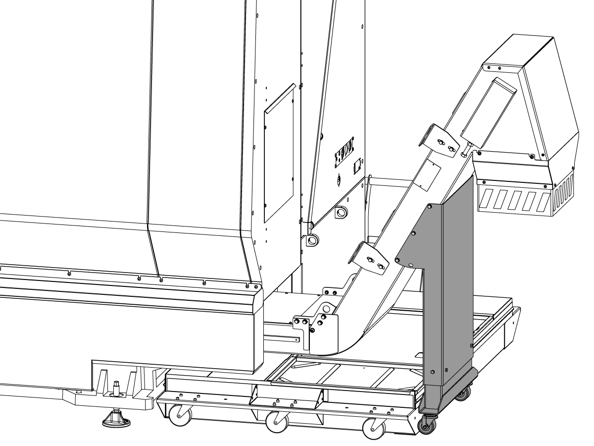

 Note: This step applies to ST-40/45/40L/45L/50/55 machines with a 95 Gallon Coolant Tank.
  • Lower the conveyor legs.
  • Push the conveyor in until the conveyor legs almost touches the coolant tank.
  • Remove the legs from the conveyor.
  • Push the conveyor the rest of the way in.
  • To prevent a coolant leak install the bolts back into the tapped holes.

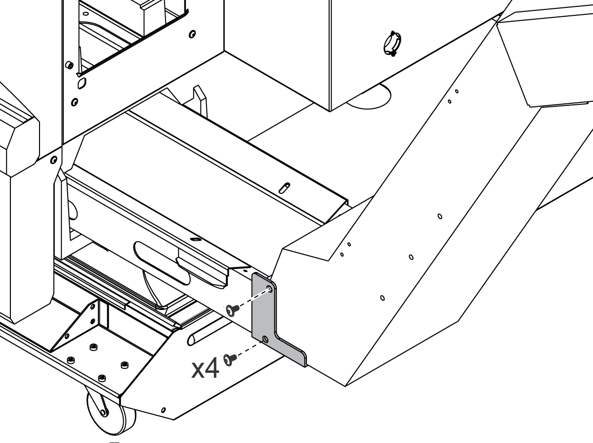

 Note: This step applies to ST-10, ST-20, and ST-30 lathes only.
For a Hennig conveyor, install the (4) 1/4-20 X 1/2" button head cap screws (BHCS) to lock the conveyor in the operating position as shown.
For a Jorgensen conveyor, install the (2) 1/4-20 X 1/2" BHCS to lock the conveyor in the operating position.

For ST-40/40L models, unfold and lock the leg before operation. The leg height needs to be adjusted so that the casters touch the floor after the machine is leveled.

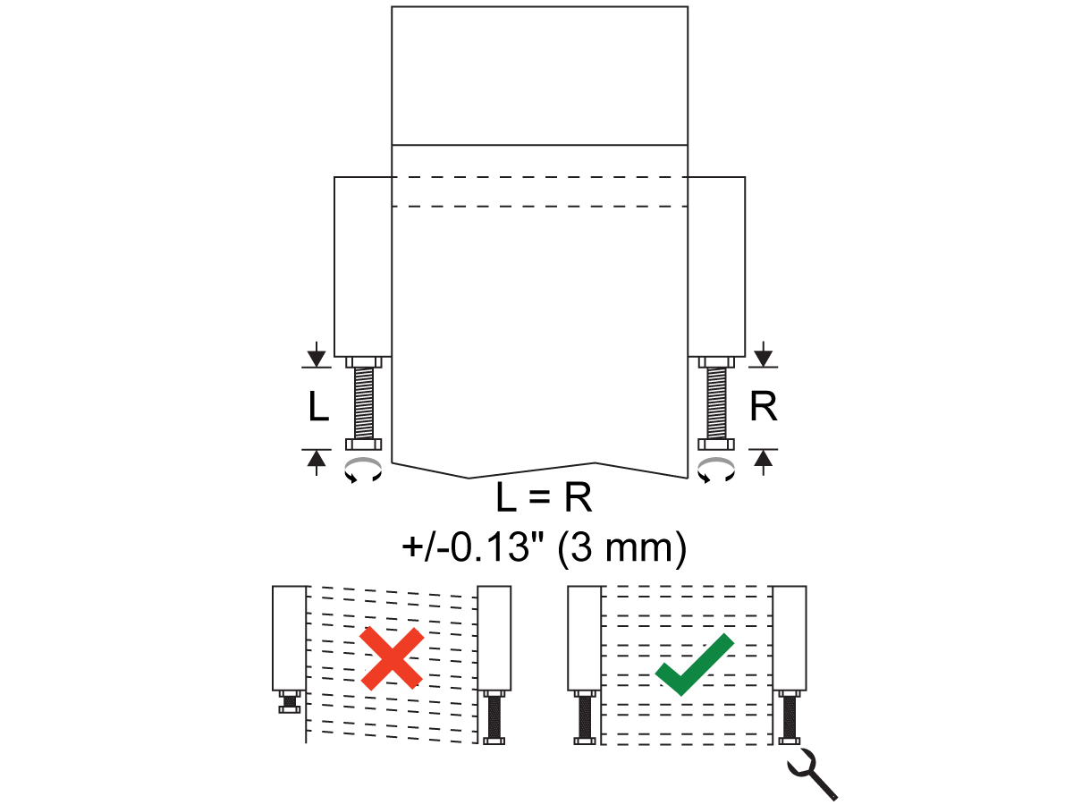

Chip Conveyor - Belt Tension
Open the cover at the head of the conveyor. Look at the belt tension as the belt goes around the sprocket.
Tighten the belt tensioning screws at either side of the conveyor head to adjust the belt drive shaft and remove slack from the belt.
 Note: Adjust the screws equally to keep the drive shaft perpendicular to belt travel.
While you adjust the belt tensioning screws, push up on the belt with a wrench at the head of the conveyor. Measure the belt slack [1] at the center of the belt in the lift section of the conveyor. The correct belt slack for Jorgensen conveyors is 0.25" - 0.38" (6 - 10 mm). The correct belt slack for Hennig conveyors is 0.12" - 0.25" (3 - 6 mm). Repeat step 2 as needed.
 IMPORTANT: Loosen the motor bolts before adjusting the tension on the belt. Leaving the motor bolts tight will result in shaft failure.
Apply the jam nut on each tensioning screw to lock it in place.
Install the access cover.

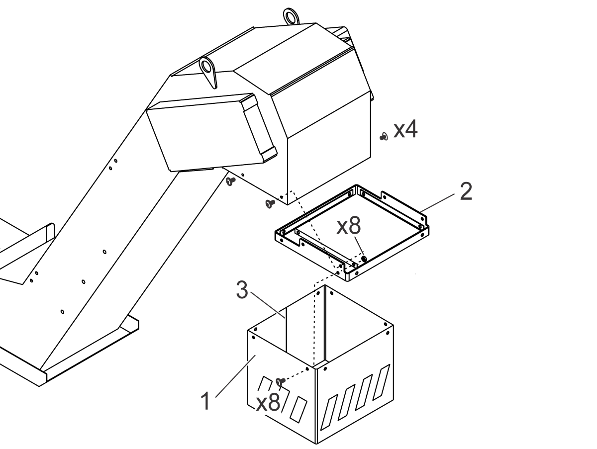

Chip Conveyor - Safety Skirt - Installation
Attach the skirt [1] to the bracket [2].
Note: The seam [3] in the skirt faces the conveyor as shown.
Mount the bracket to the conveyor.

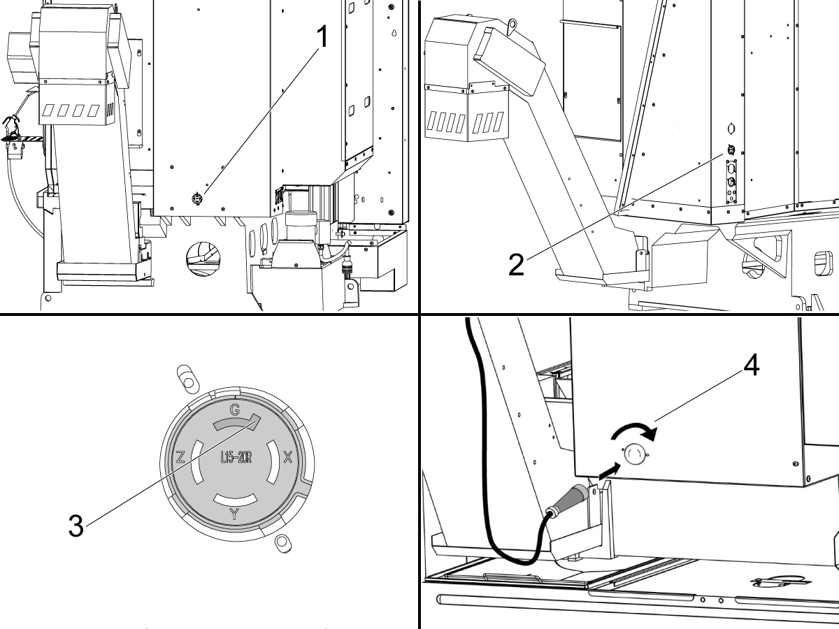

Connect the chip conveyor power cable to the connection terminal on the enclosure.
On ST-10 and ST-15 machines, the connection terminal is on the right side of the machine [1].
On ST-20 and larger machines, the connection terminal is on the back of the machine on the chip conveyor side [2].
 Note: Make sure you are connecting the chip conveyor power cable to the correct terminal. You can identify the terminal by looking at the shape of the ground terminal [3].
When connecting in the power cable, push the male connector into the terminal, and then twist the connector clockwise [4] to lock the connection.
 Note: If you have to remove the power cable at any time, you have to twist the connector counter clockwise before disconnecting.
