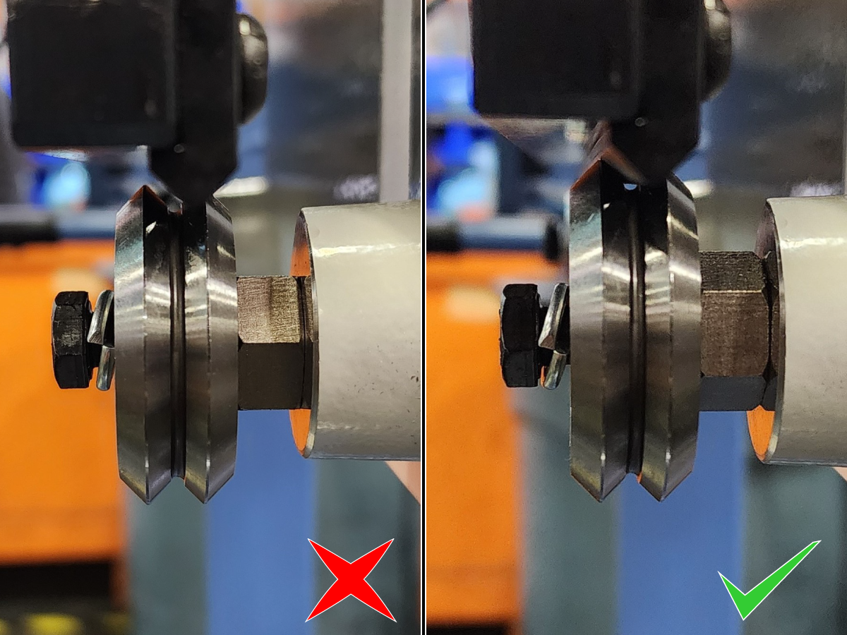

Visually inspect the roller to verify the carousel is not binding and is properly aligned as shown in the image.

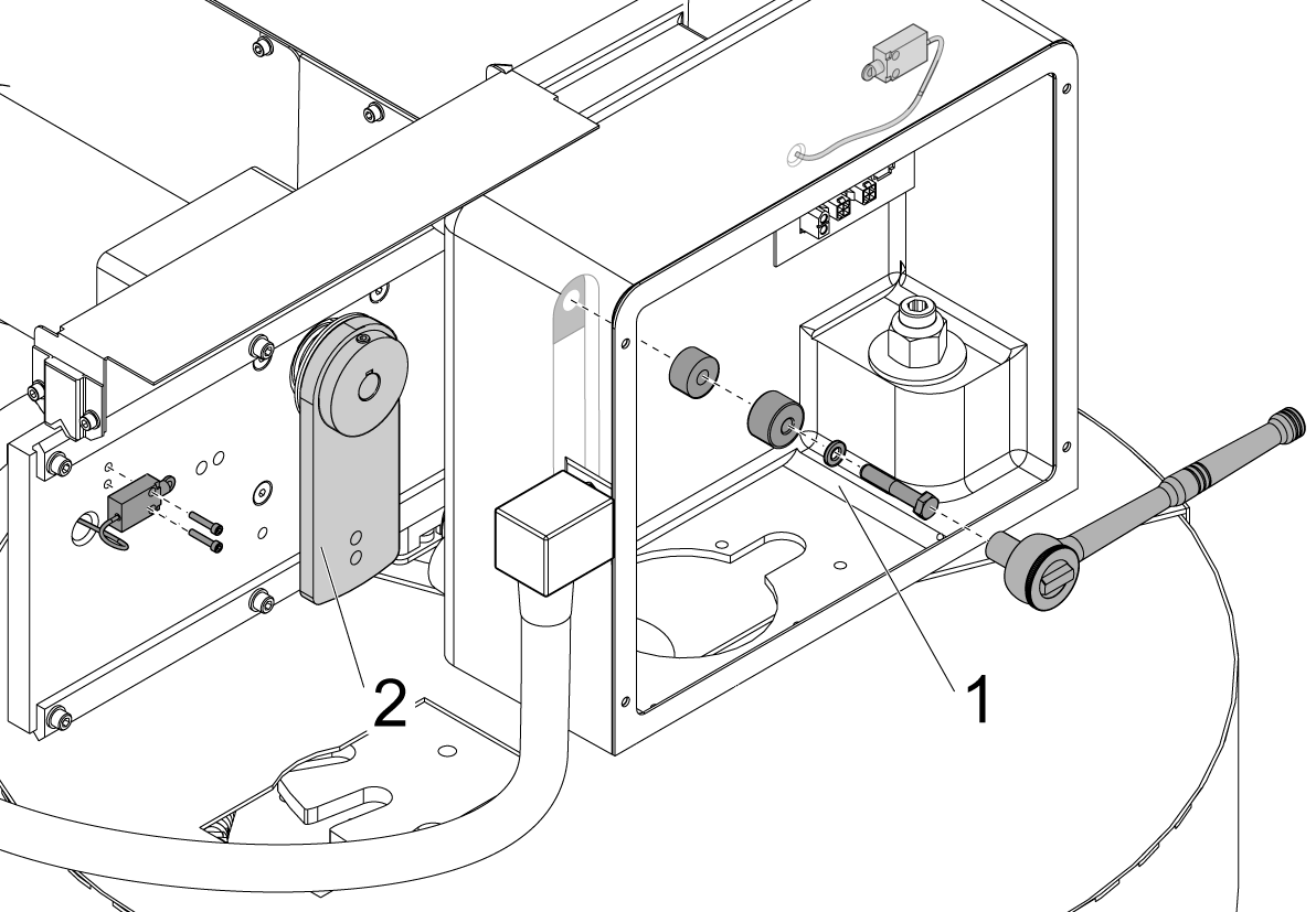

Remove the cam follower assembly [1] and lower the slip clutch arm [2] to move the carousel assembly from the shuttle in position, to the shuttle out position in order to verify there are no binds.
If the carousel does not bind, re-install the cam follower assembly.
