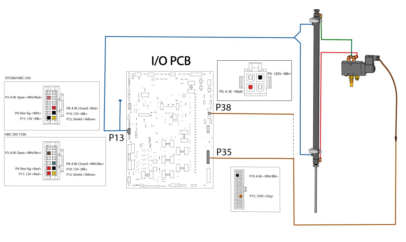

Electrical Schematic
NOTE: There are two wiring configurations for the Auto Window. All DM, DT, VF, and UMC-350 machine's auto window output cable connects into P38 whereas all UMC-500, 100, 1250, and 1500 machine's auto window output cable connects into P35.
