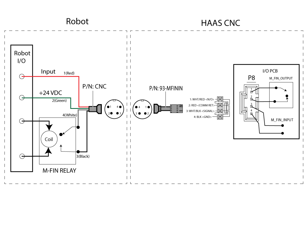

  • P/N: 93-MFININ This is the internal M-Fin function cable.
  • P/N: CNC This is a 15' external M-Fin function cable. For a 30' cable order P/N: CNC30.

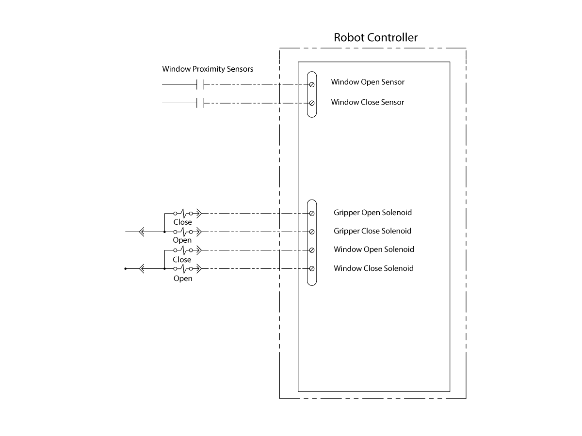

Robot Integration Example
This illustration shows a Robot installed on the right side of a VMC.
  • The robot loads the raw material through the right side window.
  • The side window is being open/closed by an air cylinder [1] . The robot control the operation of the air cylinder .
  • There is an open and close proximity sensors mounted on the side window.  The robot monitors the condition of the window sensors.
  • There is a pneumatic vise [3] mounted on the table. The machine controls the operation of the vise.
Note: This robot setup does not have a cell safe signal as the side window status is not being monitored by the Haas control.
  1. Window Open / Close, Air Cylinder
  2. Robot Arm
  3. Pneumatic vise
  4. Side Window
  5. Robot Cage
  6. Haas VMC

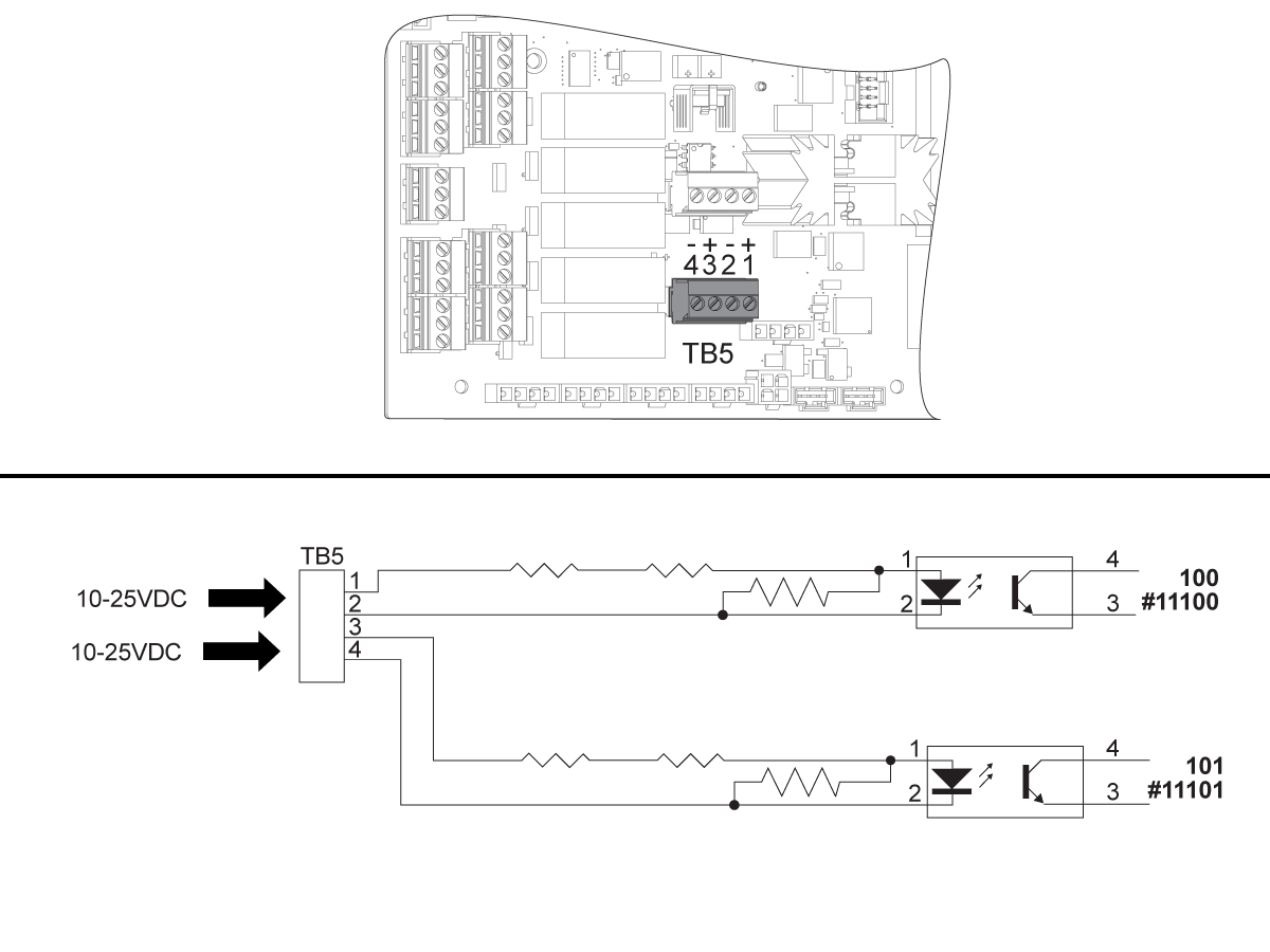

Note: The wiring diagrams shown below were used for the Robot integration example listed above and may not work with your application.
  • Emergency Stop Circuit
  • Clamp / Unclamp Solenoid
  • M-Fin Signal Relay
  • 8M PCB wiring
  • Air Cylinder Solenoid
  • Gripper Solenoid
  • Window Sensors

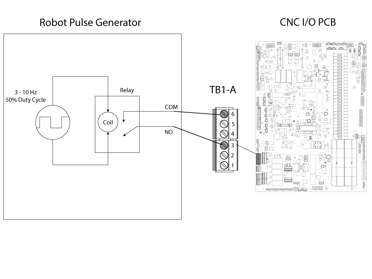

Method 1: Cell Safe Input Pulse
The robot sends a pulse signal to the CNC control.
  • The machine monitors the cell safe input for the discrete pulse.
  • This pulse can be created by triggering a relay with a square wave (3-10 hertz @ 50% duty cycle).
  • The (NO or NC) contacts of the relay can then be connected to I/O PCB TB1-A at terminals 3 & 6.
    Note: Damage to the I/O PCB will occur if external voltage is applied to these input terminals.
To view the status of cell safe input pulse:
  1. Press the DIAGNOSTIC button.
  2. Go into the I/O tab.
  3. Type in CELL.
  4. Press the F1 button.
When the pulse if being received by the control the input #103 CELL_SAFE value will toggle from 0 to 1.

Method 2: Turn on and Wait for M-Fin Signal
The  M29 Pnnn (Mills) and M129 Pnnn (Lathes) codes are use to call a robot to perform a task.  When the Haas control executes these codes it will turn on a relay and wait for the robot to complete the task.  The robot will complete the task and then send a M-FIN signal to the Haas control.  When the Haas control receives the M-Fin signal it will turn off the relay and continue with the program.
Note: Pressing the RESET button stops any operation waiting for a relay-activated accessory to finish.

M-Fin Signal
The M-Fin function can be setup by installing the internal wire harness P/N: 93-MFININ , and using the M-Fin cable P/N:CNC to interface with the robot.
M-Fin Input: The M-Fin signal input is necessary when using the M29 Pxxxx M-codes. The pins 3, 4 are used for this input.
Important: Use a relay to activate this input (see illustration). Do not apply voltage to this input. When a M-Fin signal is sensed the diagnostic #18 M_FIN_INPUT bit will toggle.
M-Fin Output: This is a normally open relay built into the I/O PCB. The pins 1,2 are used for this relay. This relay can be activated with a M59 P4 or deactivated with a M69 P4.
Robot Door Sensors
On Haas machines, it is recommended that the control pendant and door open sensors are installed. These sensors will provide an input to the robot that can be used to determine if it is safe to operate. Any proximity sensor can be used for these applications. The control pendant proximity sensor is used to confirm that the pendant is in a safe position for robot operation. The door open sensors confirm the autodoors are completely open and it is safe to enter the machine.
If your machine has 2 doors, such as in a VMC, you can install 2 sensors, one for each door, and then have to separate inputs or wire them in series as shown below so that both must be energized to send a signal.
External sensors can either be directly wired to the robot, or can be wired to an interface used for communication with the robot.

User Inputs
User Inputs on the I/O PCB
The I/O PCB includes a set of (2) available inputs (100 (#11100) and 101 (#11101)) at TB5.
Note: Devices connected to these inputs must have their own power supply.
When a device applies 10-25 VDC between Pins 1 and 2, the input 100 bit (Macro #11100) changes from 1 to 0.
When a device applies 10-25 VDC between pins 3 and 4, the input 101 (Macro #11101) bit changes from 1 to 0.
