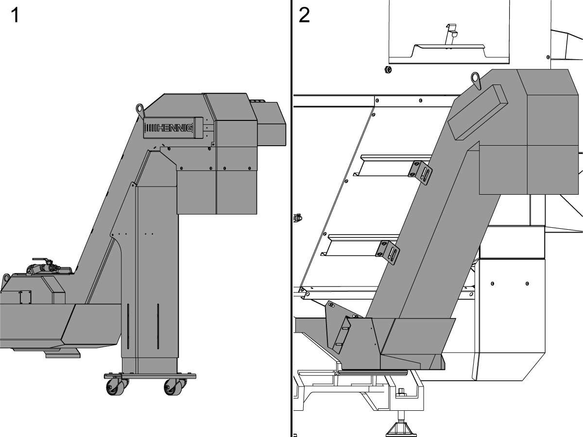

Conveyor Type
Symptom: Chip build up on a standard conveyor.
Corrective Action: Install a CDF [1] or FIlter Conveyor [2].
For a CDF conveyor's refer to AD0551.
For a Filter conveyor refer to AD0748.
For more information on the different conveyor types visit the Product Description Pages for the CDF Conveyor and the Filter Conveyor.

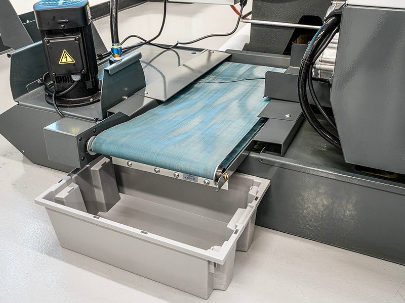

Mini Conveyor
Symptom: Chips are contaminating the coolant tank.
Corrective Action: Install a Mini Conveyor.
Refer to AD0719 for mini conveyor installation and service kit.
 Important: The mini conveyor is only compatible on UMC's that have a 55-gallon coolant tank.
Important: Before installing a mini conveyor the machine will need to have a spillway kit from the previous section installed.
