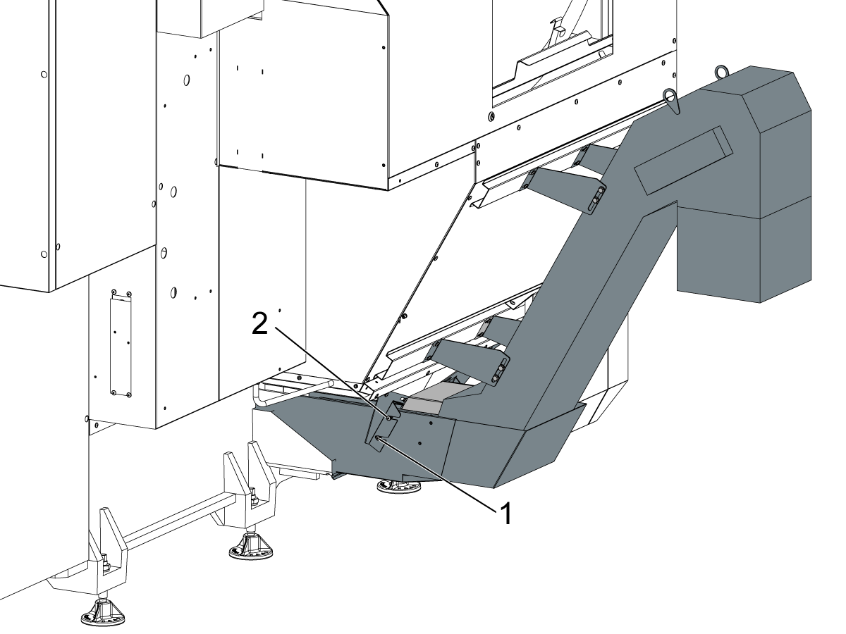

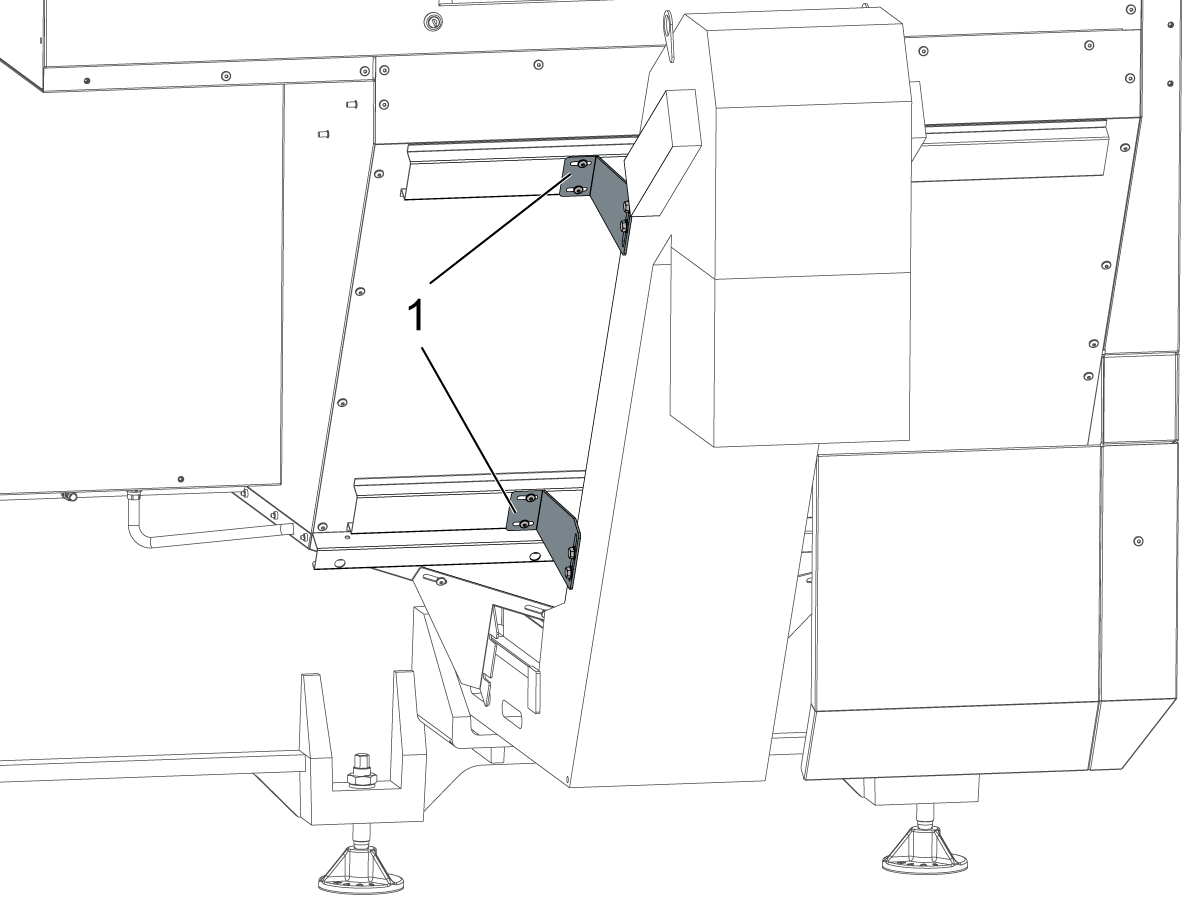

Remove the bolts attaching the conveyor to the enclosure [1].

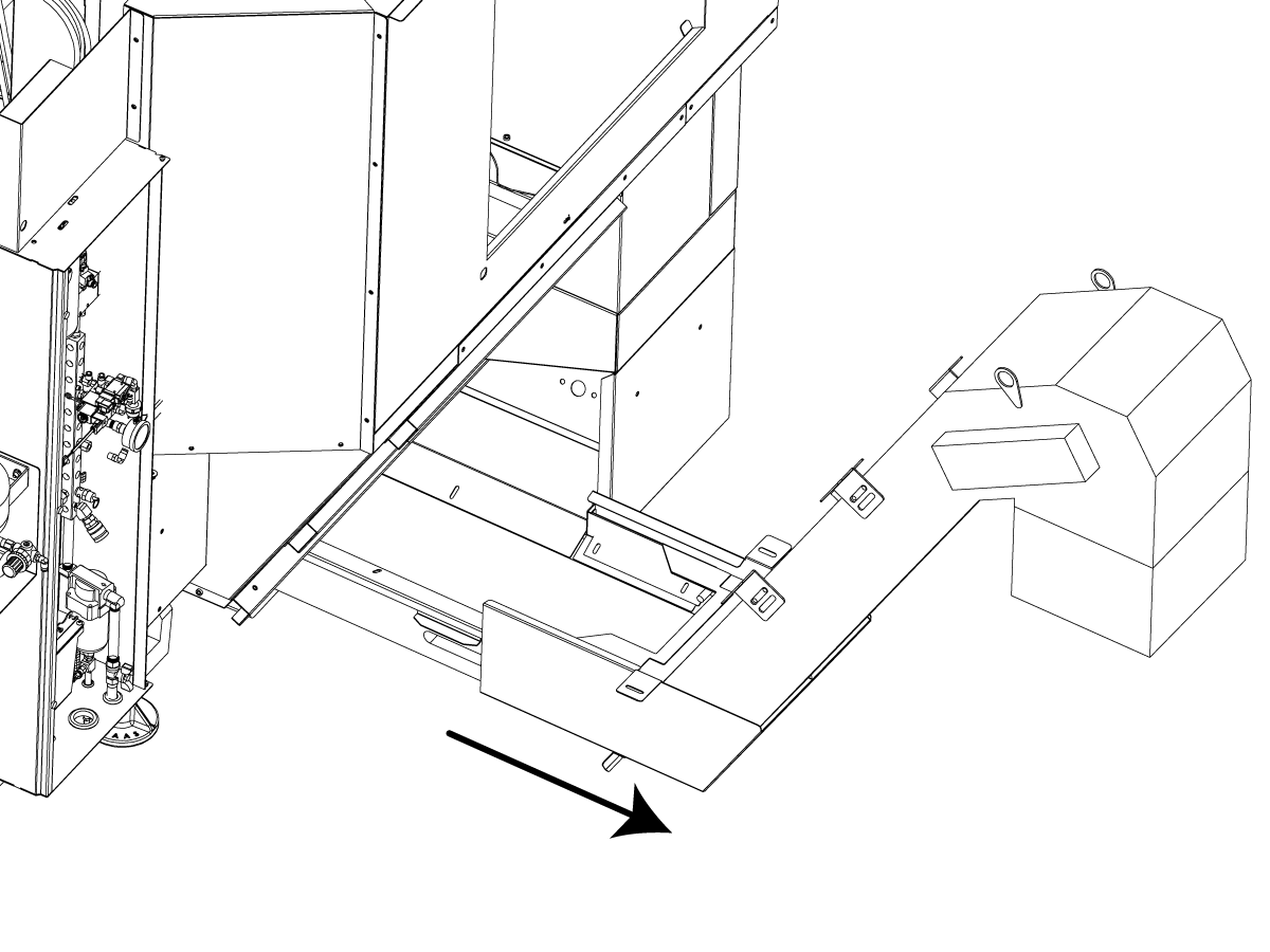

Pull out the conveyor far enough so that the extension panel can be removed and the mating brackets are exposed.
Remove the extension panel from the conveyor. It should start falling out when the conveyor is pulled out.

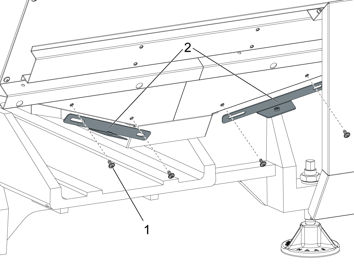

Remove bolts [1] to remove the left and the right adapter bracket [2] from the Chip Conveyor Funnel Enclosure.
UMC - 750/1000/1250/1500/SS:

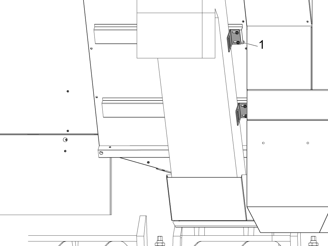

Install Left Adapter Bracket and Right Adapter Bracket [1] provided in the kit using ¼ - 20 bolts [2] to the Chip Conveyor Funnel Enclosure.

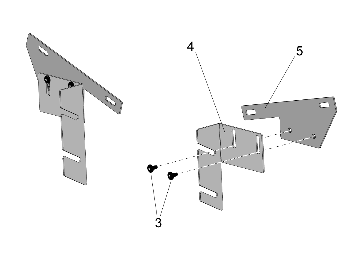

UMC-1250:
The left and right adapter brackets will have to be assembled before installation.
The front [4] and rear [5] brackets must be fastened to each other as shown with the provided ¼-20 [3] bolts provided in the service kit.
The installation of the brackets on to the machine follows the same procedure as above.

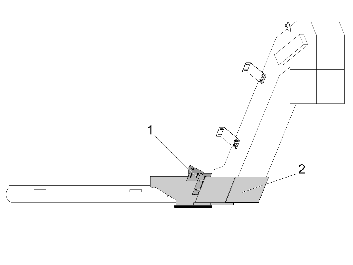

Once the left and right adapter brackets have been replaced, push the conveyor back inside the machine.
6
Reinstall the bolts attaching the conveyor to the enclosure [1].
7

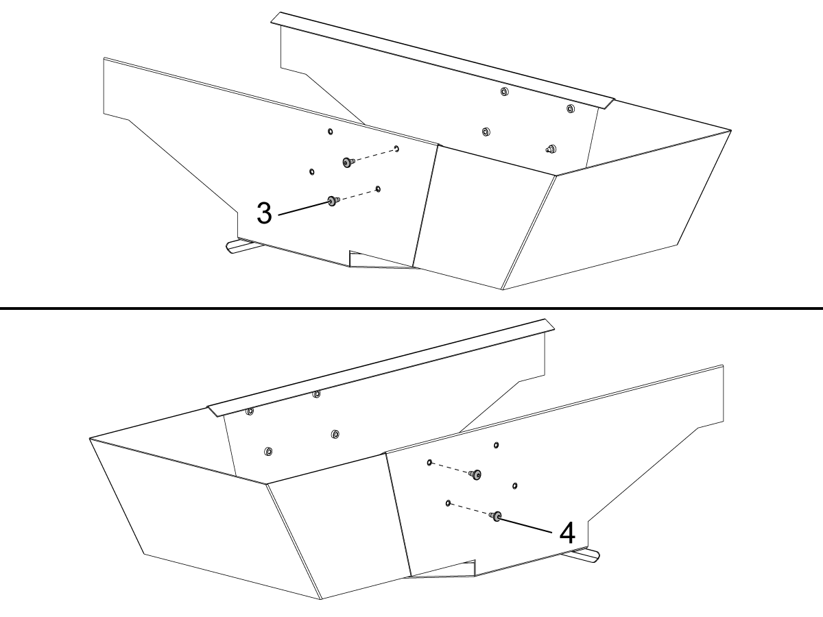

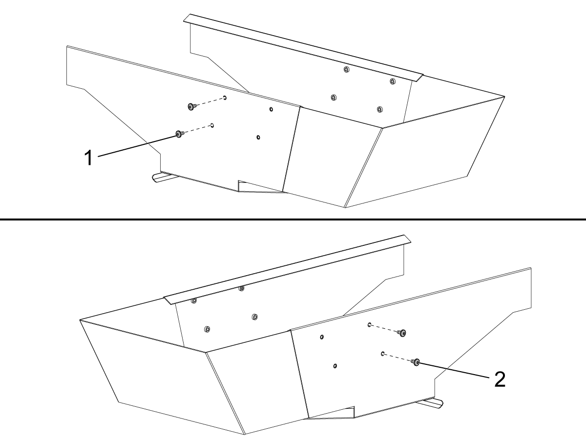

Important: Location where the bolts are installed are crucial. Take note of the machine series to install the 1/4 - 20 bolts in the right location.
UMC - 750/SS: Screw 1/4 - 20 bolts half way to Drain Pan Spillway in both left [1] and right [2] as shown in the image.
UMC - 1000/1500/SS: Screw in 1/4 - 20 bolts half way to Drain Pan Spillway in both left [3] and right [4] as shown in the image.
UMC-1250: Drain pan does not have alternate bolt locations, screw bolts half way into the provided holes.

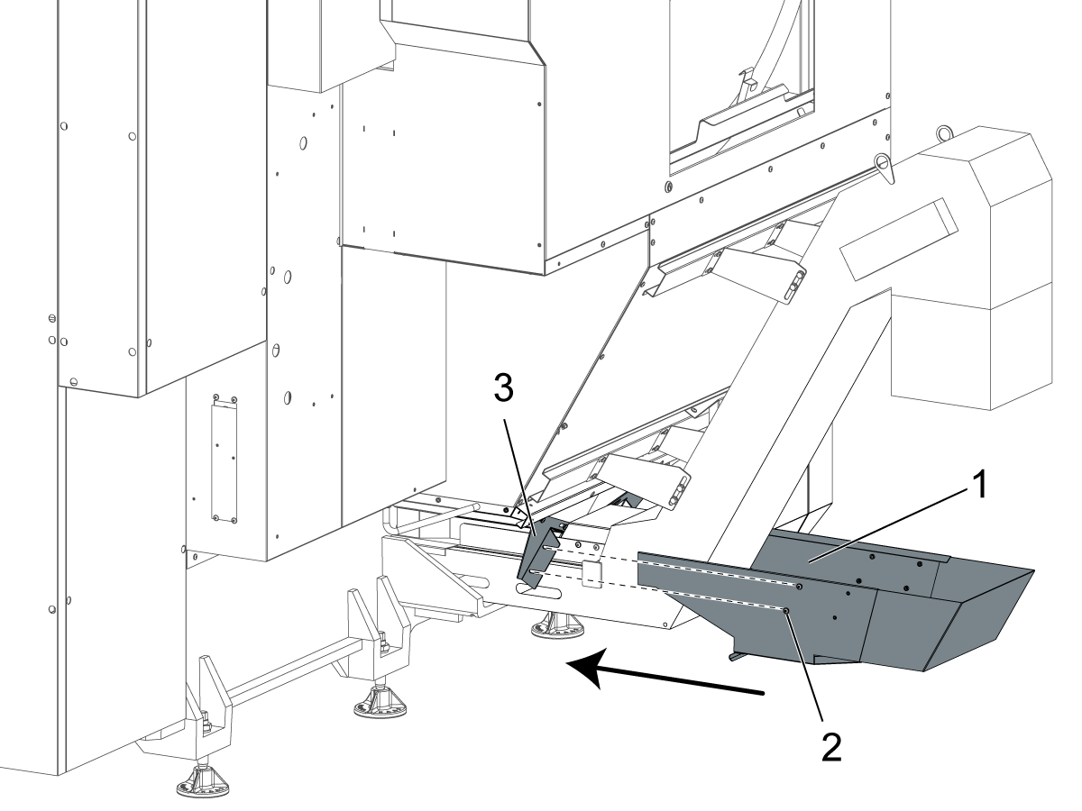

8
Slide Drain Pan Spillway [1] until it is up against the spillway such that the bolts [2] added in step 7 are in the slots of the left and right Adapter Bracket [3].
9
UMC - 750/1000/1500/SS:
Tighten bottom bolt [1] first for easier installation followed by the top bolt [2]. This should be done on both sides of the drain pan.
With the bolts attaching the adapter brackets to the enclosure lightly tightened, Align the coolant tank chip pan with respect to the spill way. Tightly fasten the adapter brackets to the enclosure when complete.
