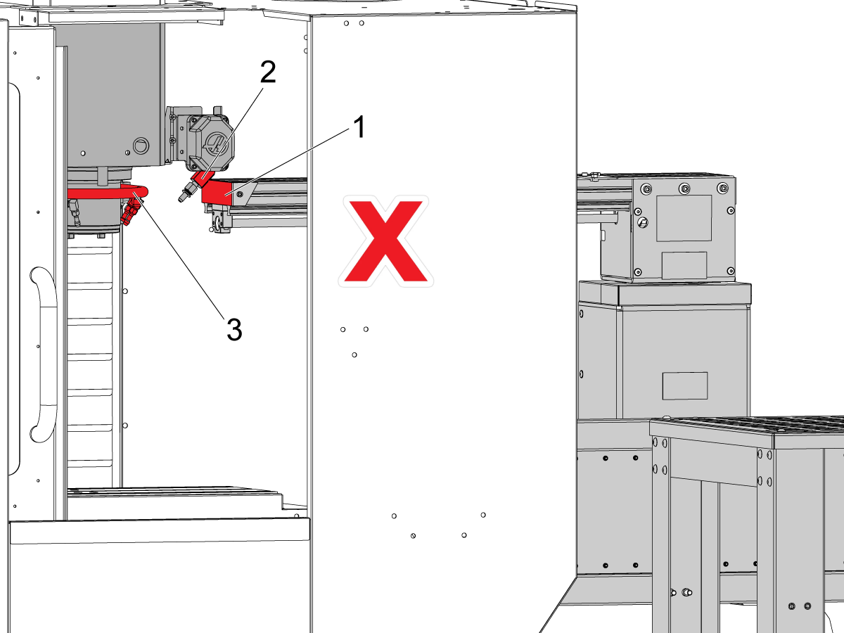

FOR MINIMILL AND SUPER MINIMILL MACHINES:
Warning: When jogging the AU-axis it is possible to jog the C-APL arm into the spindle head area. When jogging the AU-axis make sure not to jog it too far into the machine.
IMPORTANT: Always watch the end of the arm [1] when jogging to make sure it does not hit the P-Cool Option [2] or spindle head [3].

IMPORTANT: MINIMILL MACHINES - When jogging the APL arm into the machine for the Raw Stock Load Location, watch the end of the arm [1] to make sure it does not run into the P-Cool option [2] or the spindle head [3].
