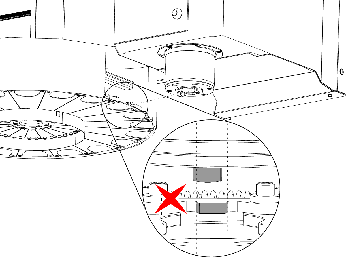

Spindle Orientation Offset - Introduction
The spindle orientation offset parameter is Parameter 4.082 in machines that have the Next Generation Control. Parameter 4.082 sets the position of the spindle dogs in relation to the tool pocket. This procedure tells you how to set Parameter 4.082.

Make sure no tool is in the spindle. Make sure no tool is in the pocket that faces the spindle.
Put the magnetic base with the indicator on the table.
Handle jog the machine to indicate the alignment of the spindle dogs and the X Axis.
The spindle dogs must be aligned within 0.010" (0.254 mm) of the X Axis.

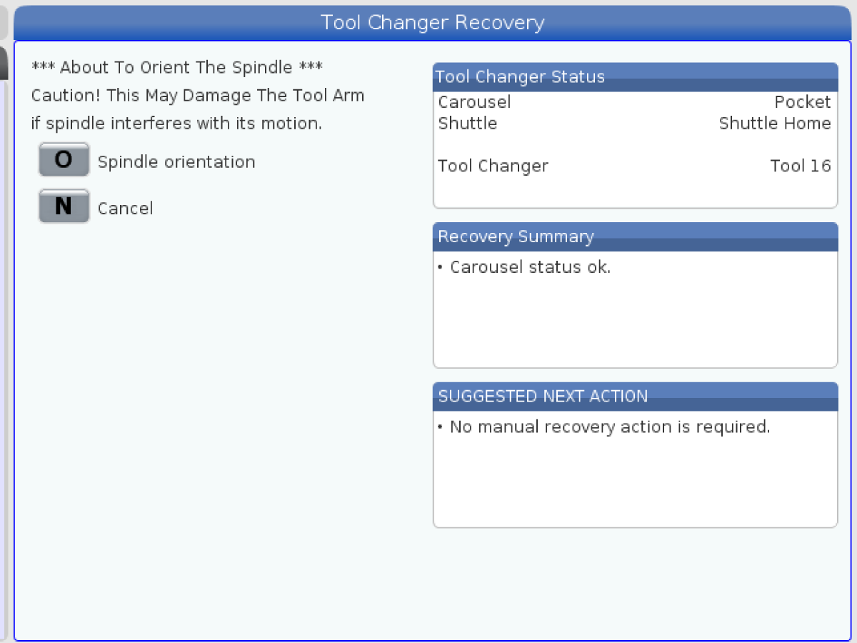

Push [RECOVER].
Select Tool Change Recovery and push [ENTER].
Push [M] to select Manual Recovery.
Push [O] to select Spindle Orientation.
Push [O] again to orient the spindle.
Repeat Step 2 to make sure the spindle dogs are aligned correctly.
Push [E] to Exit.
