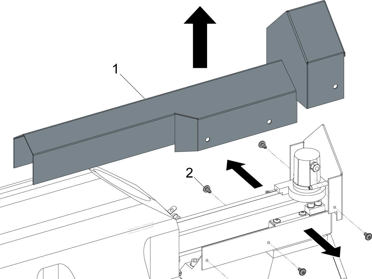

Replacement
Push [POWER OFF]. Set the main circuit breaker to the OFF position. Lock the main circuit breaker.
Remove tailstock outer hydraulic cylinder cover [2].
Remove the hydraulic cylinder inner cover to gain access to the encoder.

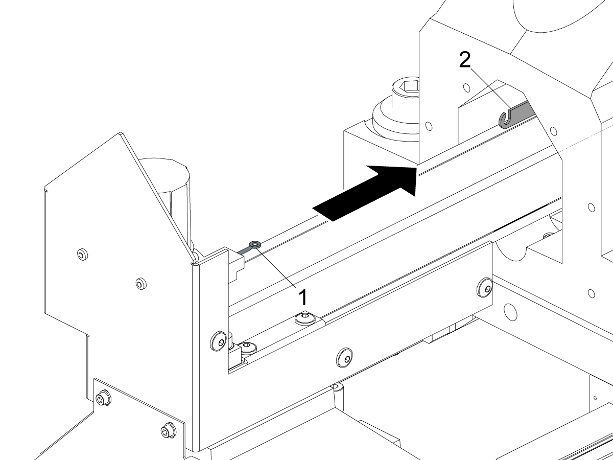

Detach the encoder string from the bracket on the tailstock.
Install the new ENCODER [1].
Connect the ENCODER [1] female connector end to the male 690B cable that connects to the MAINCON PCB.
Attach the string from the new encoder [1] to the bracket [2].
