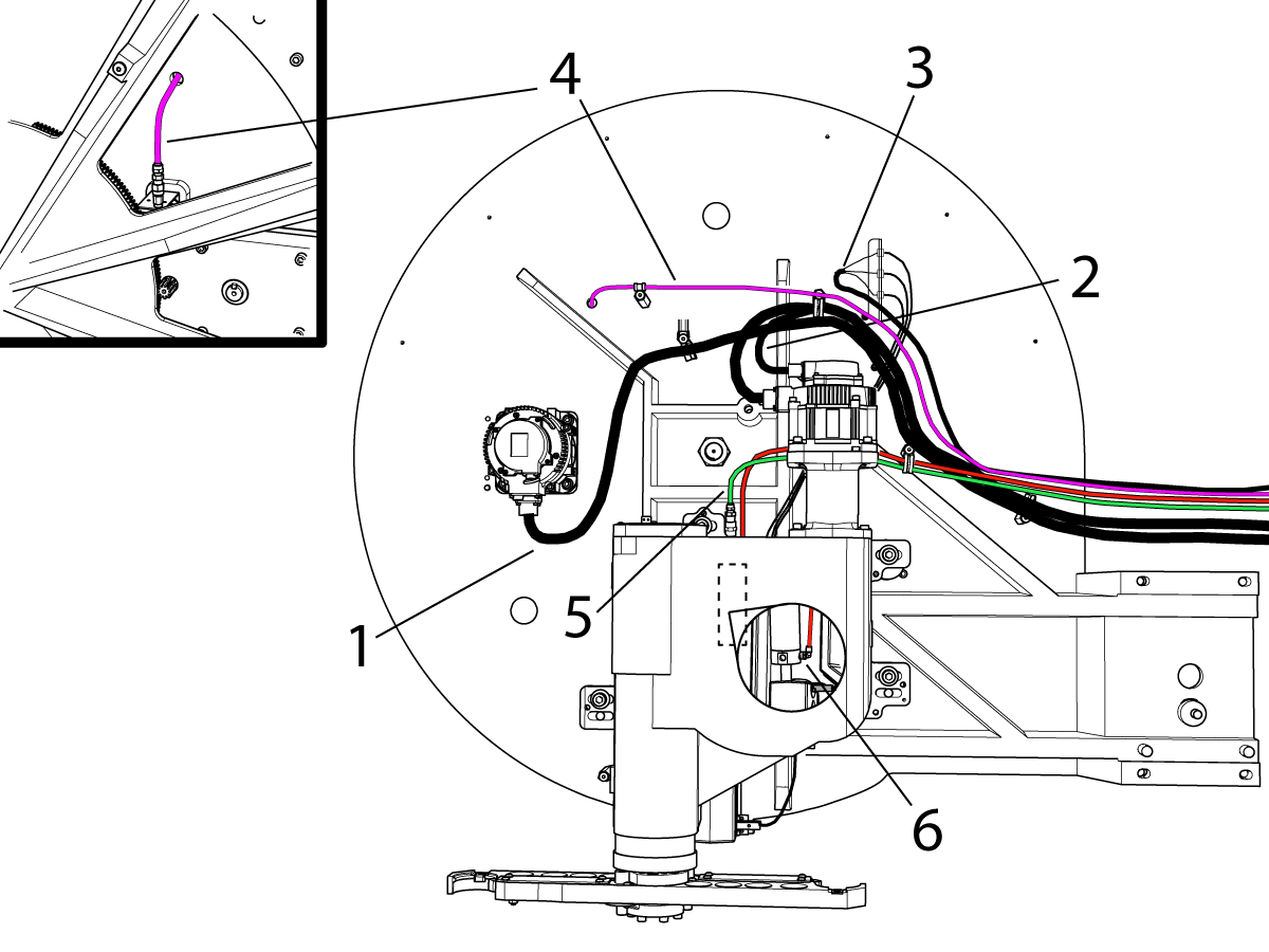

The tool changer is wired as shown:
  • Carousel Motor (TT) [1]
  • Cambox Motor (TA) [2]
  • Tool Changer Status Harness [3]
  • Carousel Lube Line [4]
  • Pocket Up Air Hose [5]
  • Pocket Down Air Hose [6]
The cable clamps are removed to reach the shipping position but the cables are still connected. Reinstall the cable clamps.

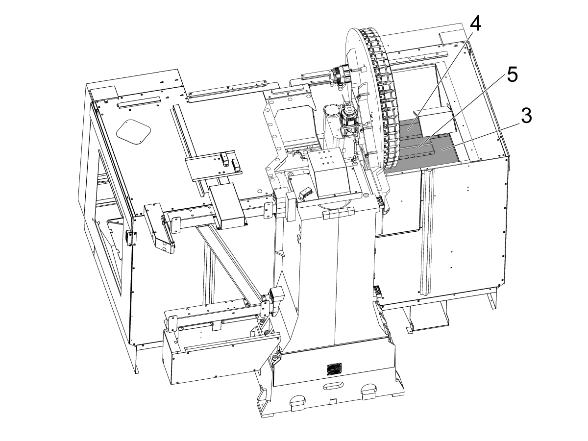

The sheet metal will be installed in this order.
  • [1] Back Enclosure Panel
  • [2] Cover Bottom Front
  • [3] Cover Bottom Back
  • [4] Cover Bottom Middle
  • [5] Brushes
  • [6] Cover Seal Bracket
  • [7] Cover Seal Top
  • [8] 5/16 Plastic Rivet
  • [9] Cover Tool Back
  • [10] Cover Tool Front
  • [11] Cover Tool Brace
  • [12] Cover Carousel
  • [13] Cover Cambox
  • [14] Cover Top Access

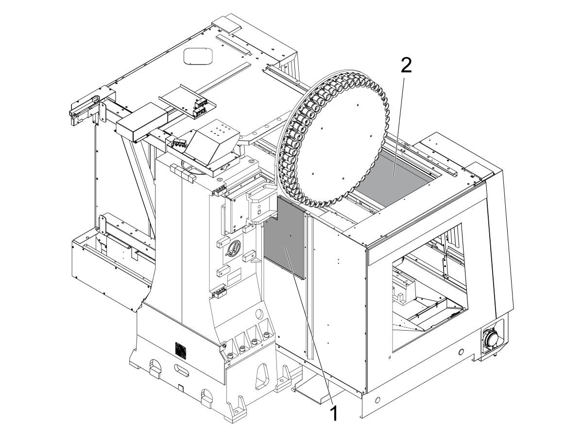

Install
6

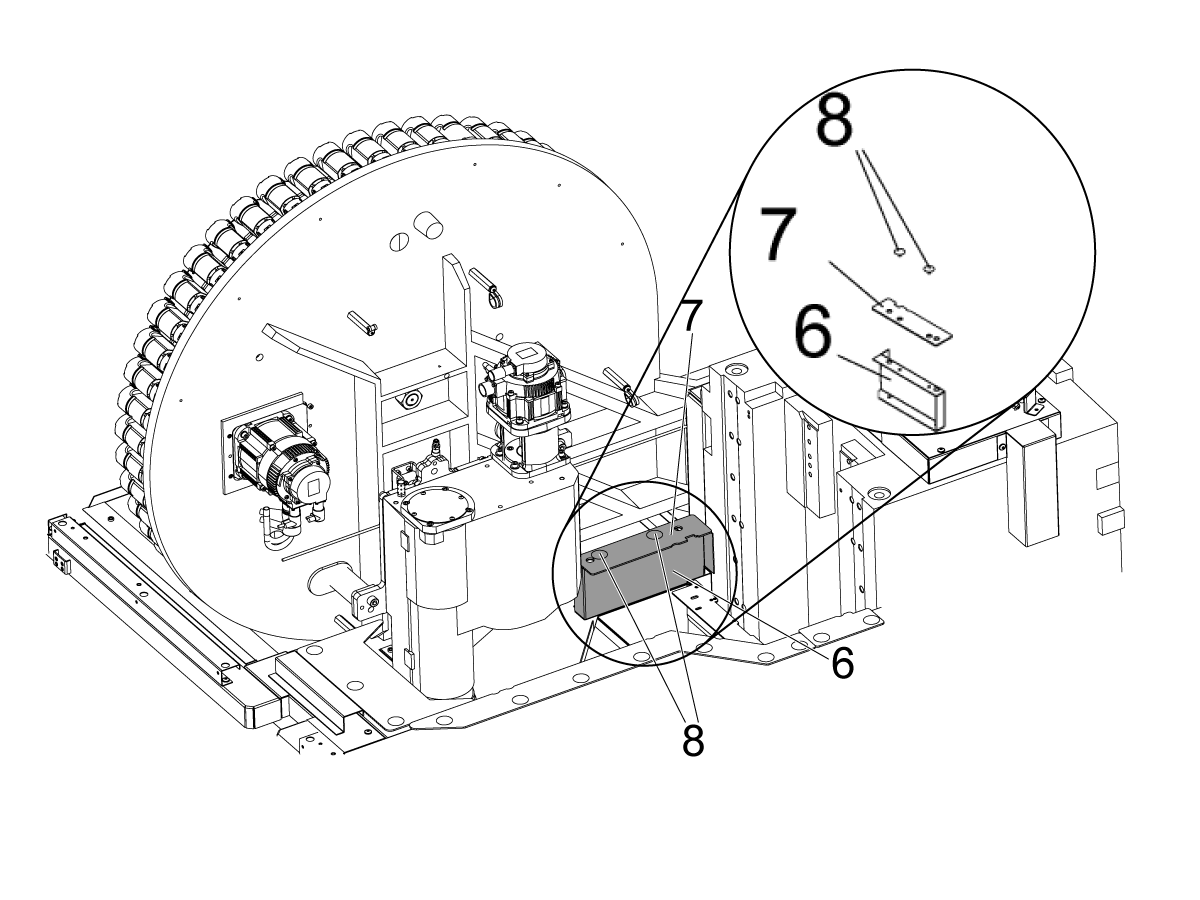

Install [6] [7] [8], cover seal assembly.
8

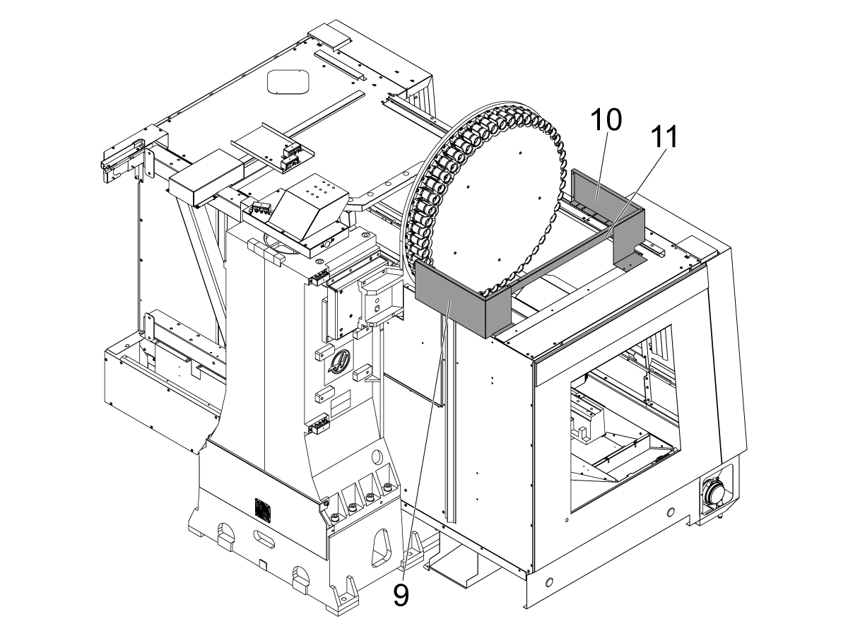

Install
9

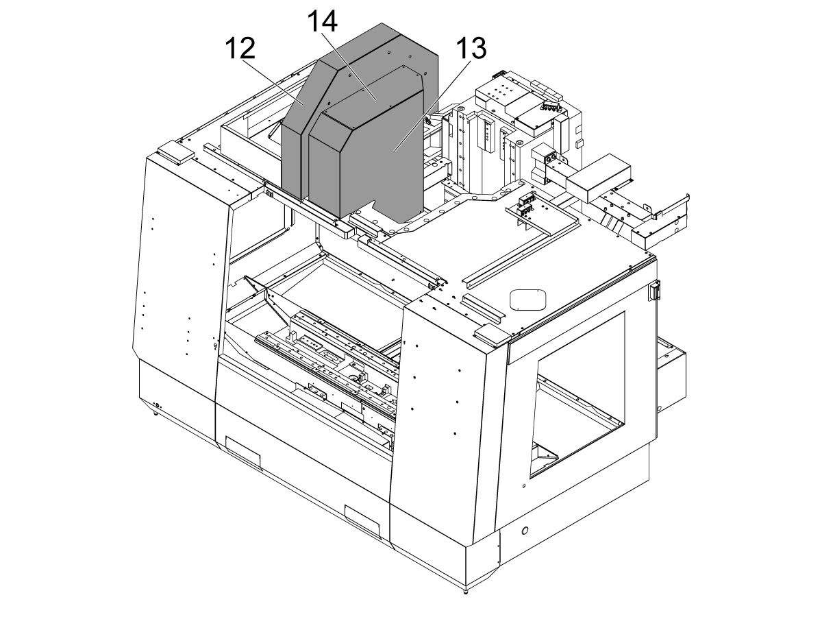

Install
  • [13] Cover Cambox
