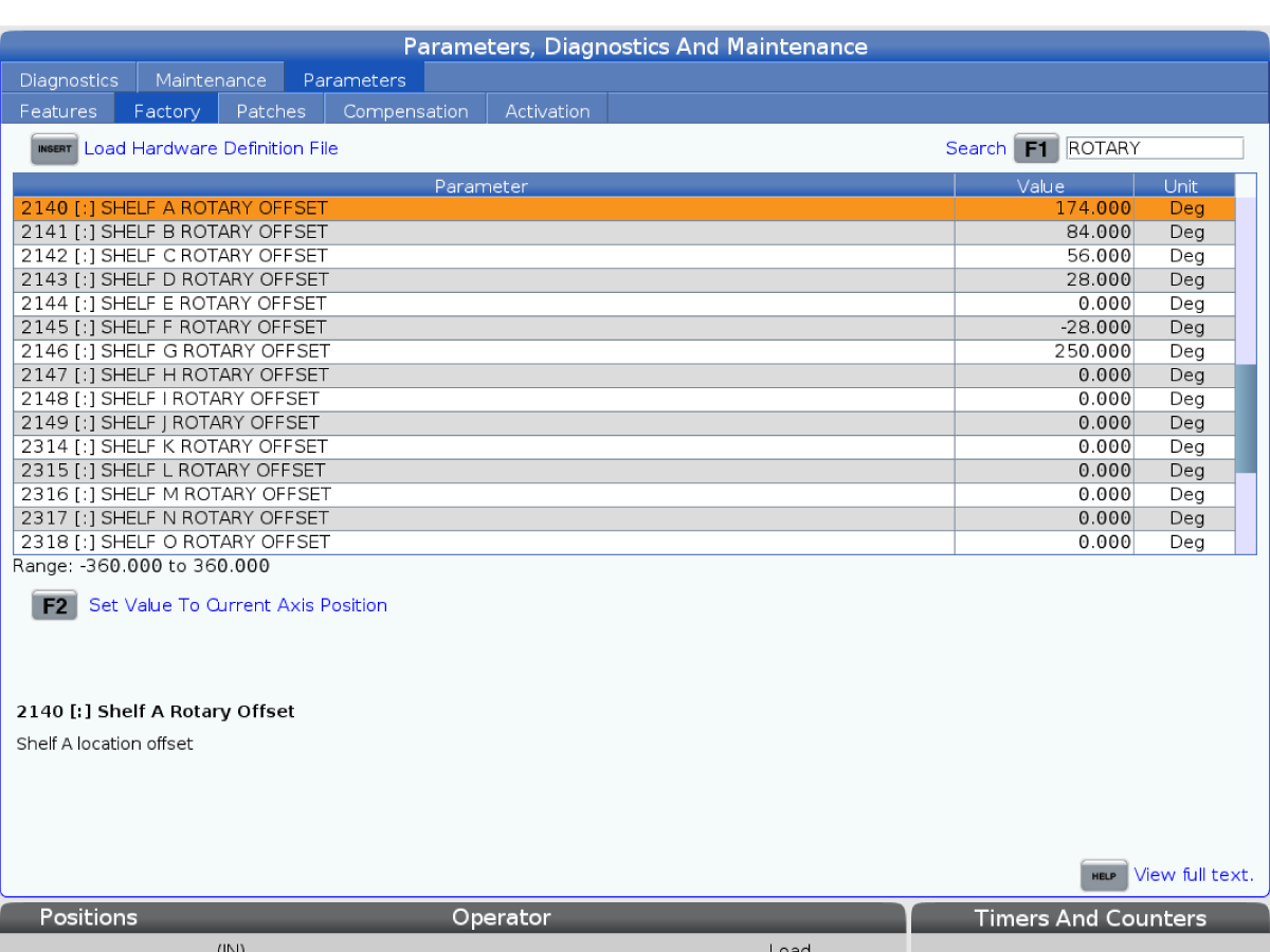

Press [DIAGNOSTIC] Go to the PARAMETERS> Factory setting tab.
Press [EMERGENCY STOP].
Type in SLIDE and press [F1].
Find the parameter that coincides with the station you are trying to adjust.
Note:The parameter number for Slide Offset will be between 2130 and 2139, 2306 and 2313, or 2372 and 2379.
Once the parameter is found, highlight the desired parameter and press [F2].  Double check that the populated value matches the noted value from the recovery page.
Type in ROTARY and press [F1].
Note: The parameter number will be between 2140 and 2149, 2314 and 2321, or 2380 and 2387.
