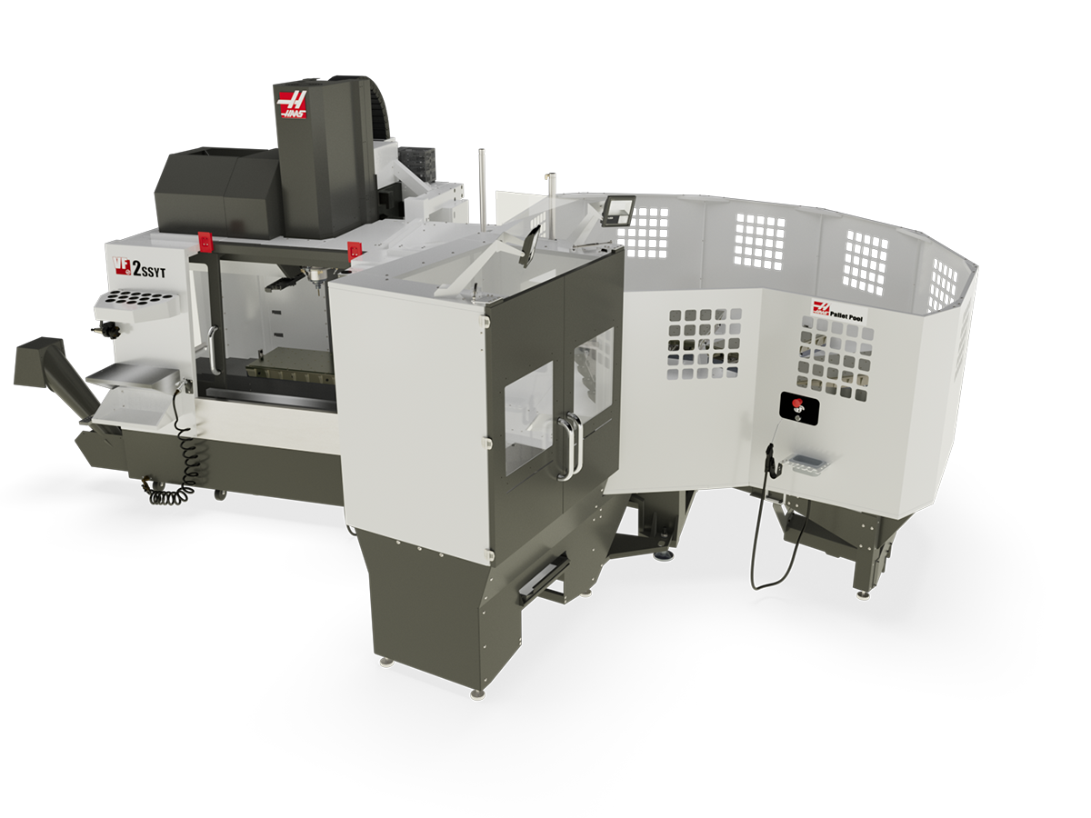

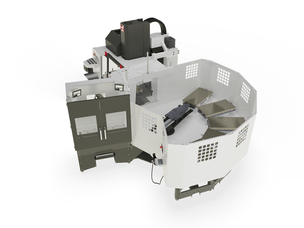

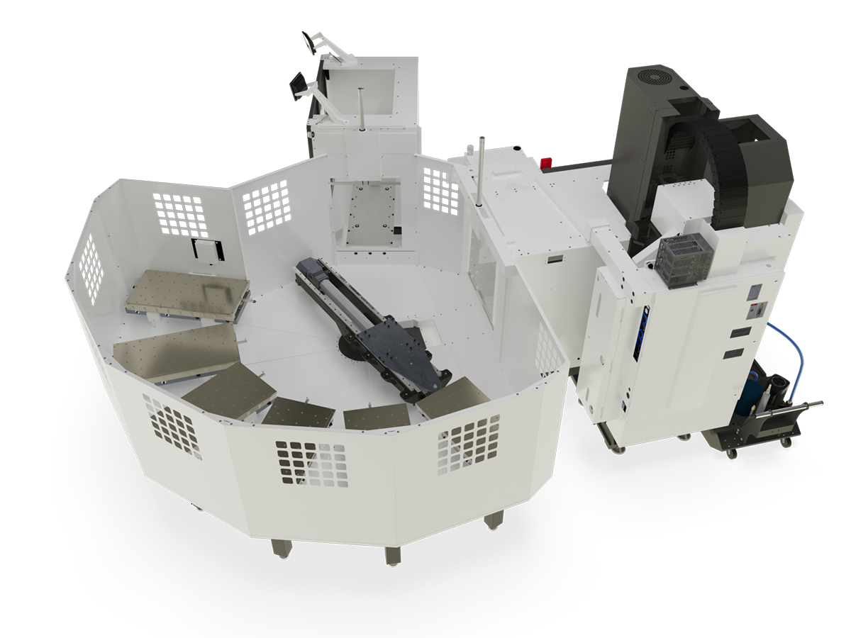

Our 6+1 pallet pool for the Haas VF-2YT Series VMCs is perfect for high-volume production runs, or high-mix/low-volume machining. The pallets – 36" x 18" (914 x 457 mm) with bolt-hole pattern – can be scheduled individually according to priority and sequencing requirements, allowing high-priority parts to be machined first or staged more often. Completed pallets are returned automatically to the holding location, or can be sequenced to a protected operator station for immediate unloading and re-loading.
NOTE: Requires a side-mount tool changer. The Pallet Pool must be anchored for proper operation. Not available for field installation.
  • Work Envelope: 30" width x 18" depth (762 x 457 mm)
  • 6+1 pallets (6 storage locations + 1 machining station)
  • 750 lb (340 kg) max payload per pallet (workpiece + workholding)
  • Fully integrated solution for lights-out production
  • Easy-to-use scheduling interface in the Haas control
  • Dedicated load/unload station
  • Must be ordered with the machine
