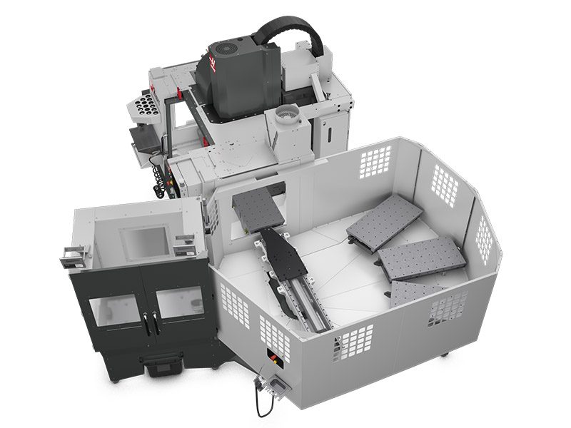

The following procedure will show you how to install a 3 station Pallet Pool on the following machines:
  • VF-2YT
  • VF-2SSYT
  • VM-2
The Next Generation software on the machine must be version 100.22.000.1010 or higher.
The Pallet Pool option is not field installable.
The VF-2YT must be level and anchored before the Pallet Pool can be installed. Refer to the VMC-Installation procedure.
The Pallet Pool option has a room for a total of 4 pallets that can be installed on a VF-2YT with the Pallet Pool option.
The Pallet Pool has 2 servo axes. The PR axis rotates the Pallet Pool saddle and the PS axis extends and retracts the Pallet Pool saddle to load/unload the pallets.

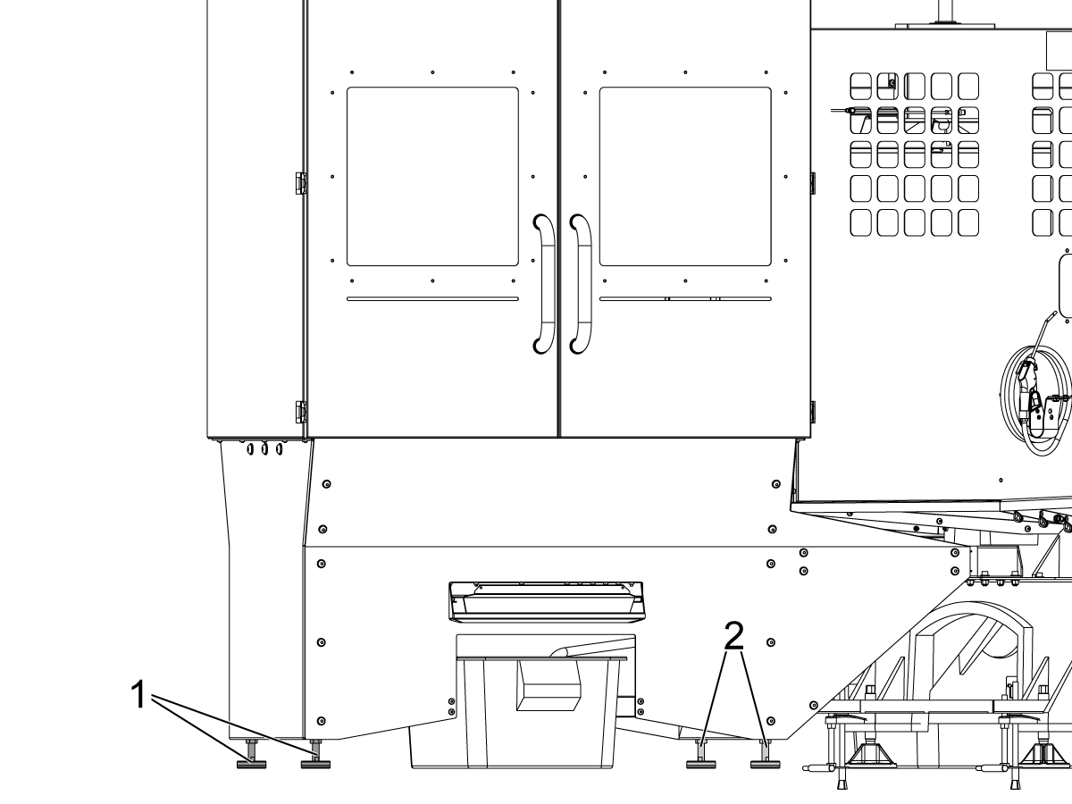

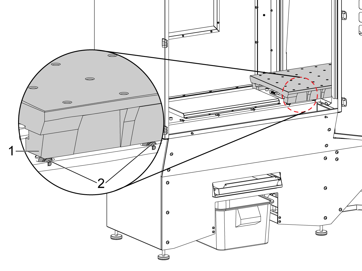

Leveling Screws Hardware
Note: The washers [1] and nuts [2] are installed during shipping and should be saved for installation and not be discarded.
Note: The washer orientation [3] is important.  The conical part of the washer should be against the casting,  see illustration.

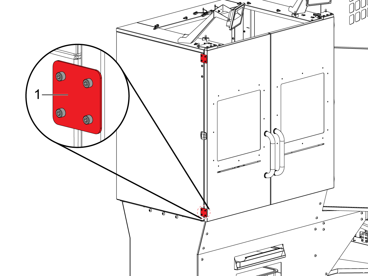

Take one hinge [2] and remove the hardware covers [1].
Attach the hinge to the top of the door where the shipping bracket was previously as shown in the image [3].
Once he hinge is secured in place with the hardware, snap on the hardware covers [1]
6

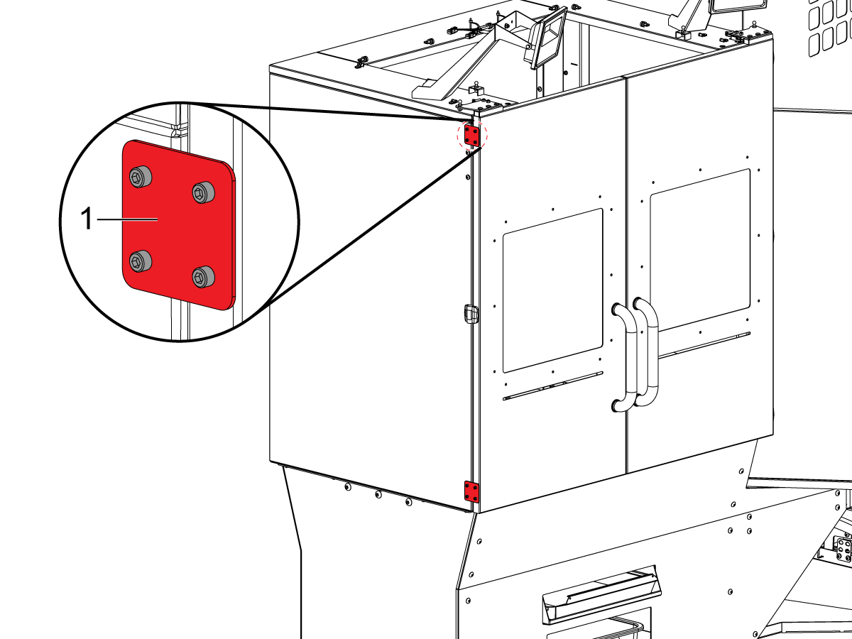

Remove the bottom shipping bracket [1] from the load station door.
Save the hardware to reuse on the door hinge.
Repeat step 5 for the bottom hinge.

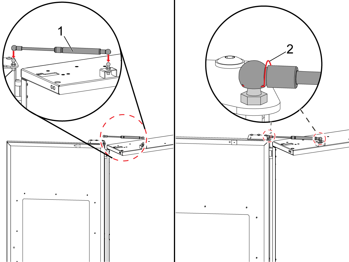

The load station door gas springs are in a zip lock bag zip tied to the load station doors.
Remove the retaining rings [2] from both sides of the gas spring [1].
Open the door and place the gas spring [1] on the ball studs as shown.
Install the retaining rings [2] on each side of the gas spring.
Repeat steps 4-7 for the second load station door.

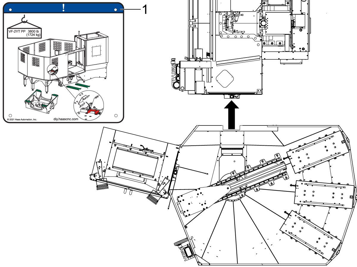

The machine and Pallet Pool should be placed using the anchoring templates. Place the templates over one another so that the points in boxes [1] and [2] line up with each other. View the image for reference.
Important: To ensure that the Pallet Pool does not become mis-aligned, it is required that the machine and Pallet Pool be anchored after leveling. Refer to the following link: Anchoring Instructions.
Use a pallet jack or forklift to move the pallet pool close to the machine. When moving the pallet pool into the machine, center the cross bar opening on the pallet pool around the sheet metal bracket that covers the air cylinder on the auto window of the machine.
A decal [1] has been placed on the rear of the pallet pool to indicate where the pallet forks should lift the pallet pool from.
NOTE: Have the pallet jack pick up the pallet pool from the opposite side of where the slide window would be.

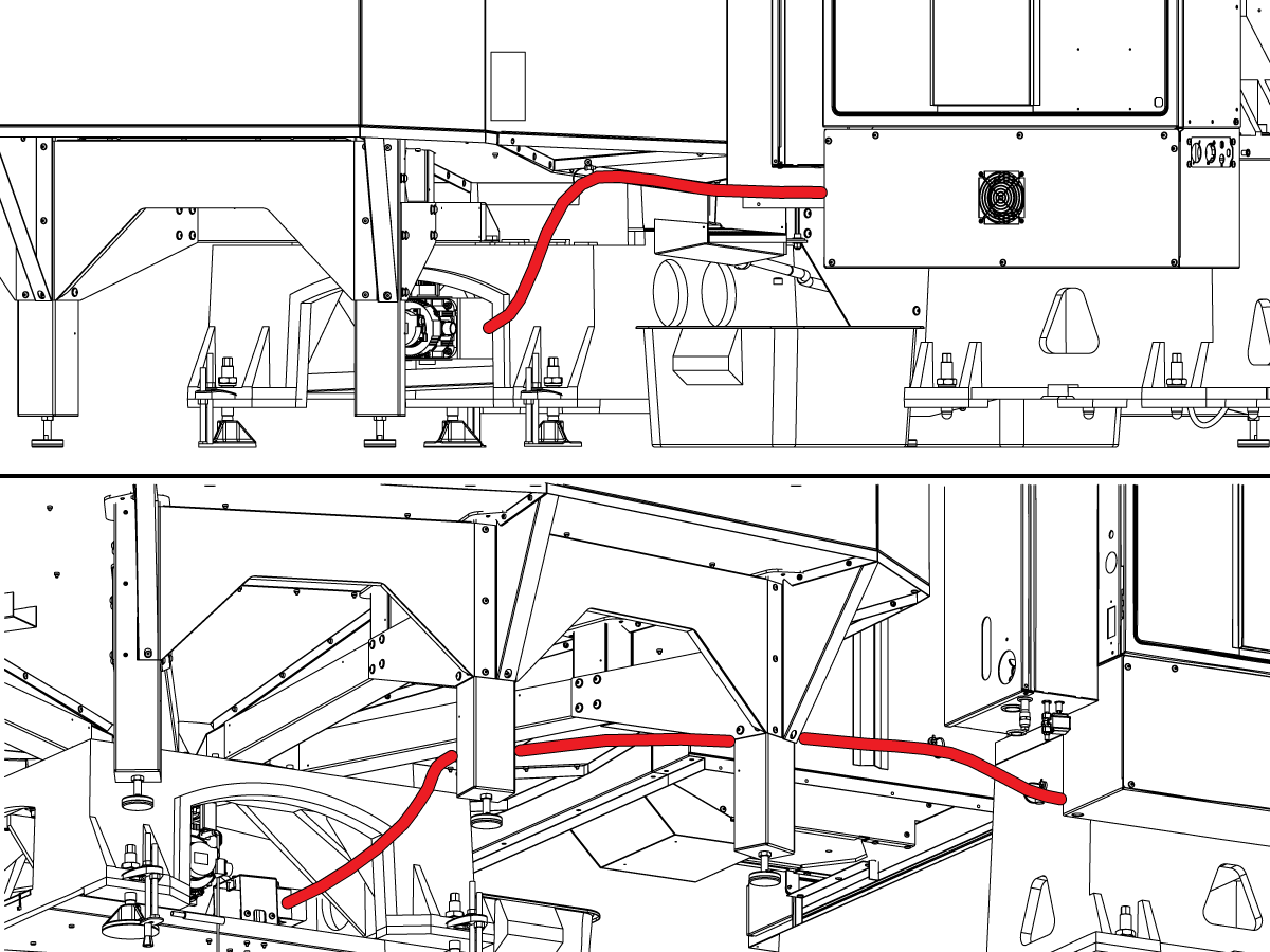

Electrical and Pneumatic Connections
Make sure the main circuit breaker is in the [OFF] position and wait until the Vector Drive High-Voltage light turns off.
 Note: The PR (Pallet Rotate) and PS (Pallet Slide) amps are already installed at the factory.
Route the pallet pool cables into the control cabinet as shown in the illustration.
Note: Remove the panel under the electrical cabinet for access to the cables routed from the pallet pool.
Connect the PR motor encoder cable to Maincon PCB channel 15. Install the ferrite filter bead on the motor encoder cable.
Connect the PS motor encoder cable to Maincon PCB channel 16. Install the ferrite filter bead on the motor encoder cable.
Connect the PR motor power cable to the amplifier labeled PR. Install the ferrite filter bead on the motor power cable.
Connect the PS motor power cable to the amplifier labeled PS. Install the ferrite filter bead on the motor power cable.

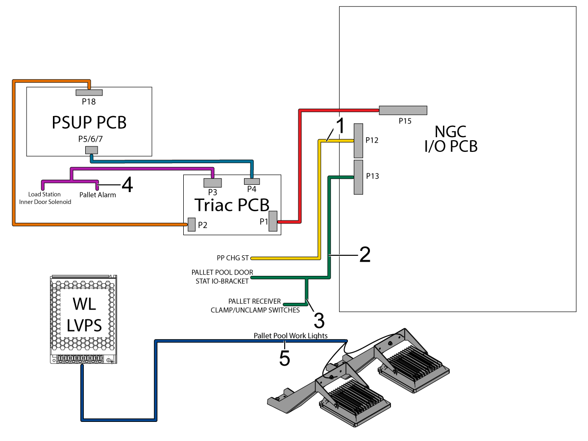

Remove the jumper from P12 and connect PP CHG ST (cable 33-1163) [1] to P12 on the  IOPCB.
Connect PALLET POOL DOOR STAT IO-BRACKET (cable 33-1114) [2] to P13 on the IOPCB.
Connect the pallet receiver Clamp and Unclamp switches to the pigtail [3] on cable 33-1114.
Note: The receiver clamp and unclamp connections are located under the electrical cabinet.
Connect PALLET ALARM (cable 33-1160) [4]  to the pigtail cable at P3 on the SMTC/Triac PCB.
Connect the Pallet Load Station worklights (cable 33-5840) [5] to the Work Light LVPS power supply.

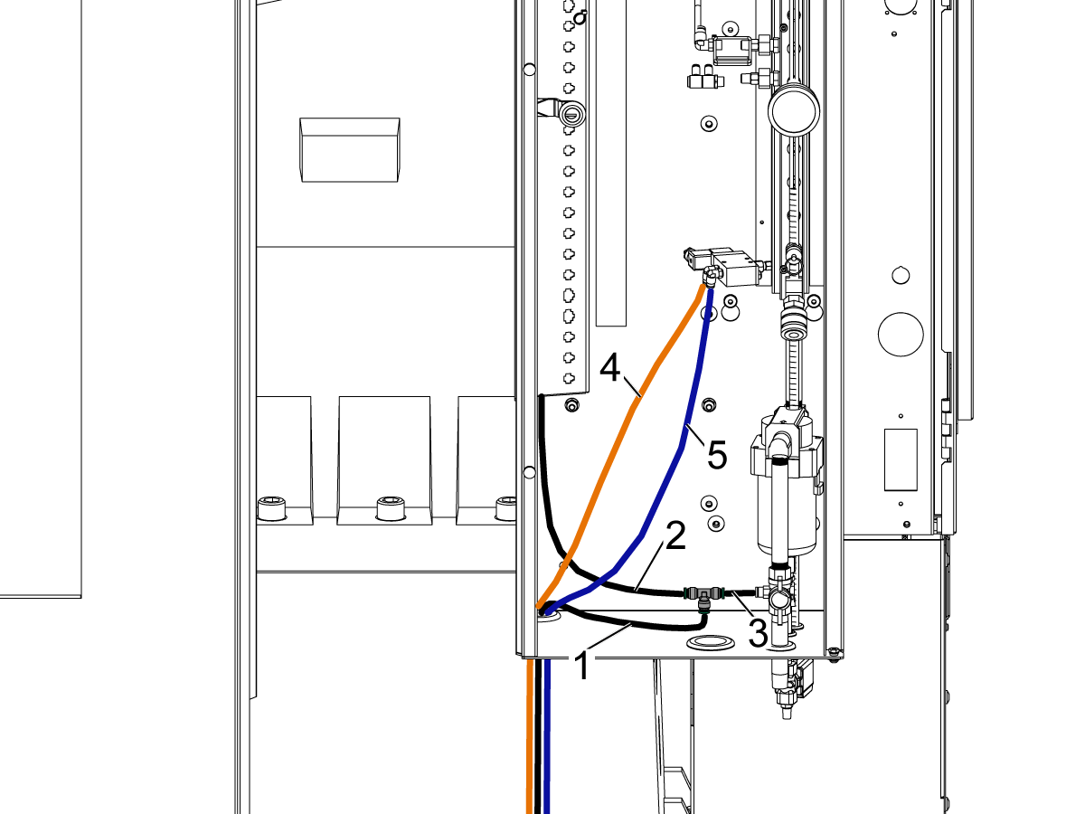

Route the air line with the T-fitting [1] from the pallet pool cable conduit into the lube panel as shown.
A small piece of air hose will need to be cut to connect to the air line in the lube cabinet [3].
Connect the air hose from the machine air gun [2] to the T-fitting as shown.
Route the orange [4] and blue [5] hoses from the inner load station window air cylinder to the bottom solenoid in the lube panel as shown. The ports on the solenoid will have orange and blue zip ties to show where each hose is connected.

Base Level Pallet Pool

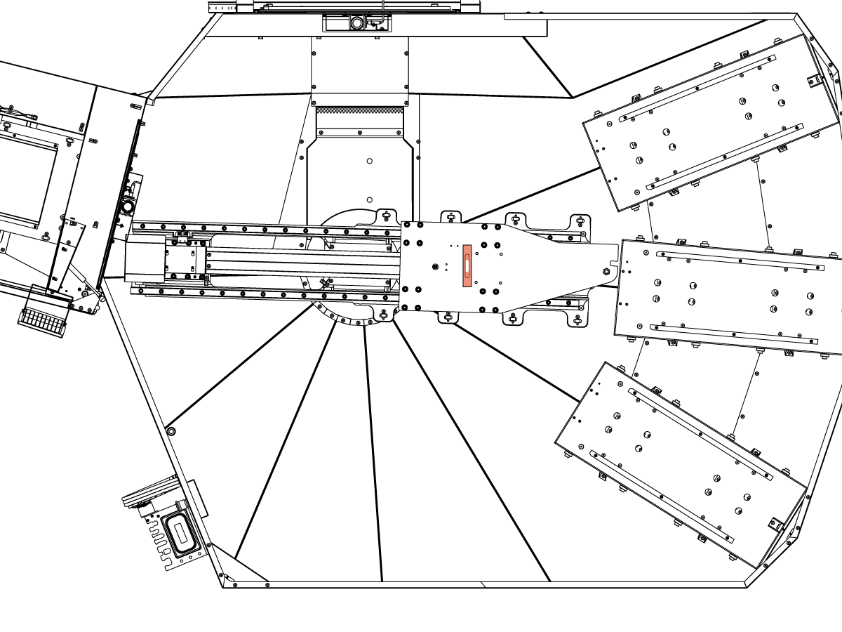

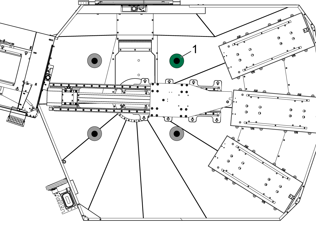

Verify all outer supports feet are NOT touching the floor.
Make sure the pallet pool sit on 3 points, the leveling foot that is not touching the puck is the one closest to the machine control cabinet [1].
The distance from the floor to the bottom on the Pallet Pool base should be approximately 3.5 inches.
Move the saddle to its home position if it is not already, place the bubble level on the trolley plate and rough level with respect to X & Y.
NOTE: Rough level by adjusting the 3 leveling feet without adjusting the 4th in the air.
Once the base is leveled on the 3 points, bring the 4th leveling screw down to touch the pad.

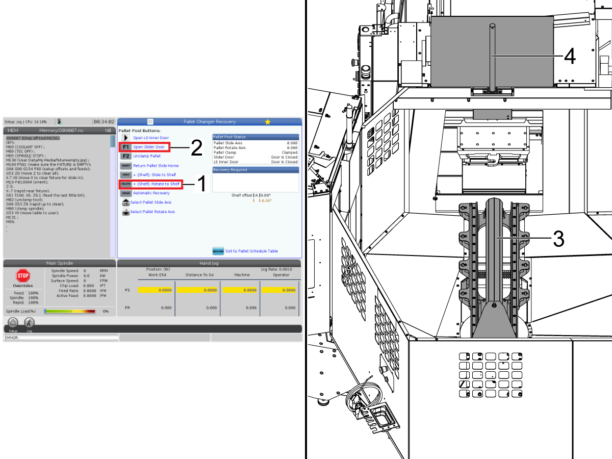

Press [H] and then the [DELETE] [1] button. This will rotate the saddle [3] towards station H (as shown in the image).
Press [F1] [2] to open the auto window [4].

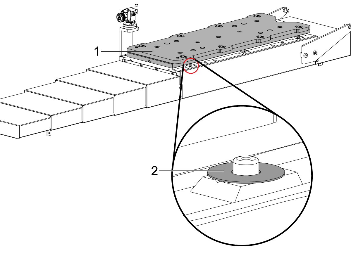

Once the pallet is hooked and fully extended onto the receiver, set parameter 2137 [:] SHELF H SLIDE OFFSET.
In the Pallet Changer Recovery page while the pallet in the machine is hooked, press [INSERT] to return the pallet slide to home.
Once the pallet is moved off of the receiver [1], remove the nylon washers [2] that are on the (4) surrounding pins.

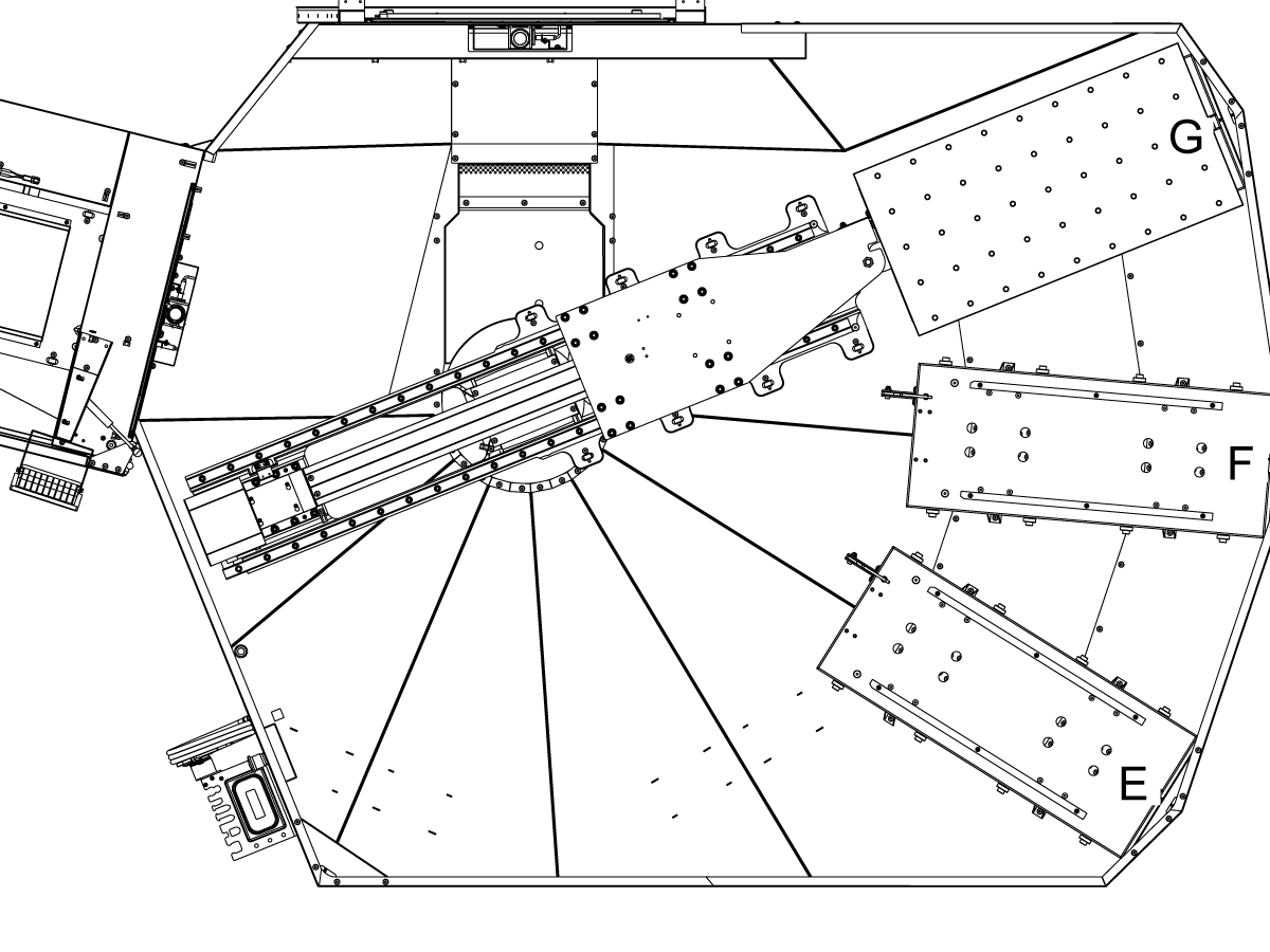

Align Remaining Pallet Shelves
Use the Pallet Changer Recovery page to pick up the pallet and rotate it to shelf G and hand jog the PS axis until the pallet is over the first two rollers of the load station.
The pallet should run smoothly across all of the rollers. If it does not run smoothly, use the outer leveling feet to help adjust and make a smoother shelf loading process.
Use the Pallet Changer Recovery page to send the pallet into shelf G and rotate the trolley plate out so that the pallet is no longer hooked on the trolley plate and verify that the locking mechanism dowel pin latches the pallet correctly.
Note: Refer to the next step for a more in depth explanation for how the locking mechanism dowel pin should latch the pallet correctly.
If the locking mechanism is not latching the pallet properly, adjust the leveling foot to help adjust the locking mechanism.
Repeat this for shelves F and E.
There should have been grease added to the trolley plate at [1] and on all of the dowel pins [2] in the pallet latch mechanisms, if this grease has rubbed off in shipping add more grease to these locations.
It should also be verified that the dowel pin in the pallet station latching mechanism makes at least 0.25 inches [3] of contact with the trolley plate. If this is not the case, adjust the shelf leveling feet to ensure the right amount of contact is being made at each pallet shelf.
Once the shelves are all aligned to satisfaction, anchor the pallet pool base.
Loading Other Pallets
Attach the provided I-bolts to the pallet shown. Attach lifting straps or safety hooks to the I-bolts. Use a fork lift to lift the pallet and into pallet station E.
Note: Make sure when lowering the pallet to not lower it onto the latch.
Note: The pallets can be loaded into the load station but keep an eye on the back wall when bringing in the pallet as to not hit the load station with the forklift.
Undo the I-bolts from the pallet and use the Pallet Recovery Page to move the pallet from station E to the other pallet stations.
Note: When loading the pallets into the pallet Load Station, make sure to use a proper lifting mechanism. Each pallet weighs approximately 250 lbs.
Repeat till all the pallets are in the pallet pool. Verify that the Pallet Scheduler Table page matches what is in the machine.
