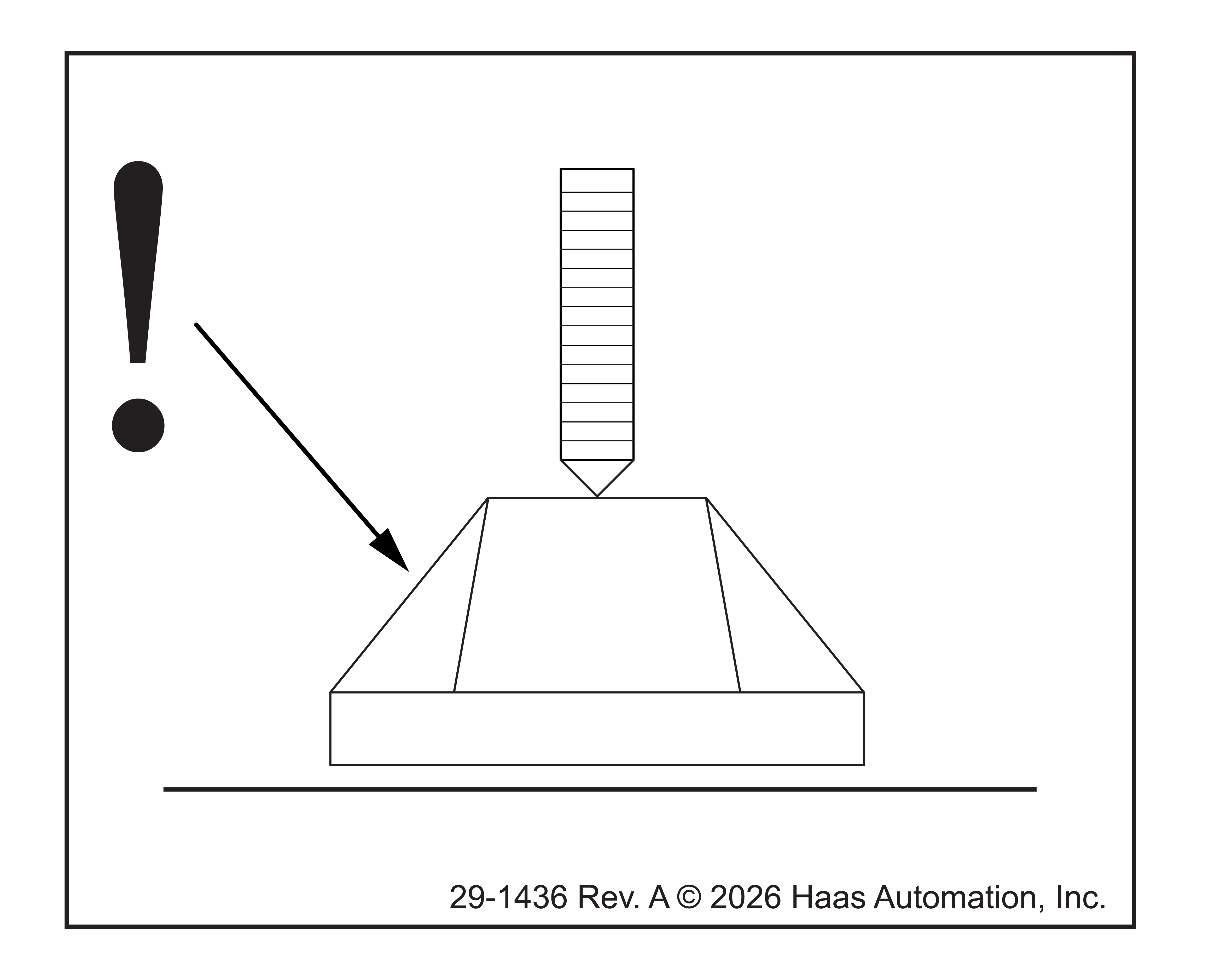

Leveling Screws Hardware
Note: The washers [1] and nuts [2] are installed during shipping and should be saved for installation and not be discarded.
Note: The washer orientation [3] is important.  The conical part of the washer should be against the casting,  see illustration.

  • Adjust the four corner leveling screws to the same height to lift the base casting to the height specified as [H] on the leveling decal on the back of the machine.
  • Loosen the middle leveling screws [3, 6] so that they are not touching the pads, install jam nuts [1] on leveling screws, but do not tighten

  • Lower the center leveling screws 3 and 6 until they make contact with the pads. Tighten these hand tight and then tighten them an additional 10 degrees with the ratchet.
  • Place the level in the center of the bed and orient it so the long vial is parallel to the Y-axis
  • Look at the bubble position when the bed is at its center position and then jog the bed back in the Y direction until it reaches the column.
  • Take note of the bubble position, if the level shows that the machine is either bowed in the up or down direction, make small and even adjustments to middle leveling screws 3 and 6
  • The Tolerance for both the twist and bow is N.T.E 0.0002"/10"
