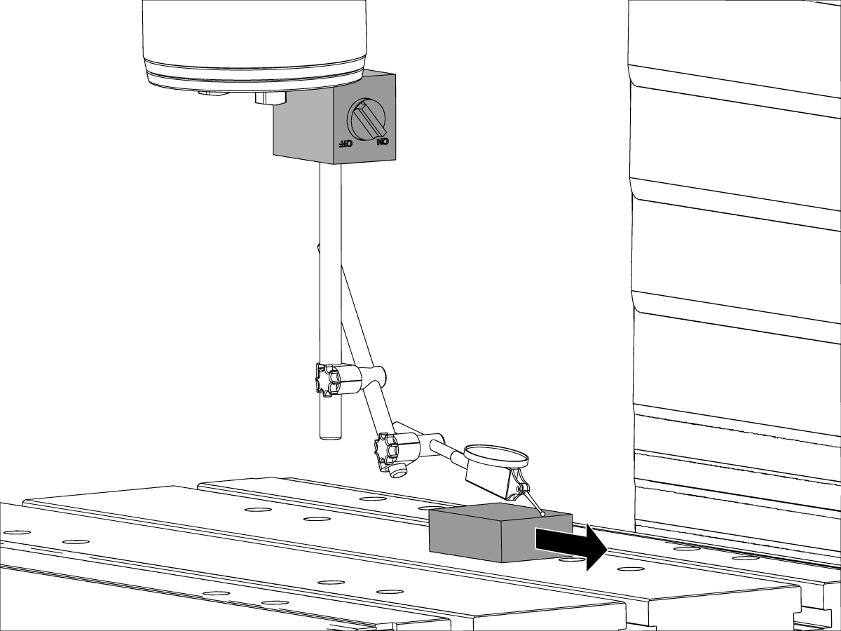

Put a magnetic base with a 0.0005" (0.01 mm) indicator on the spindle.
 Note: Make sure the indicator base cannot move or turn with the spindle.

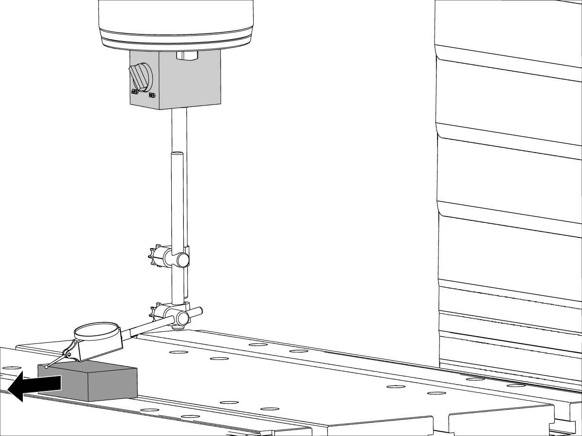

Move a gauge block below the indicator stylus from the rear of the indicator. Set the indicator to 0. Remove the gauge block.
Examine the table every 10 inches (25.4 cm) on the X and Y Axis. Move the table to the next location. Move the gauge block under the indicator stylus from the rear of the indicator. Record the value.
 Note: The maximum permitted error is 0.0012" (0.03 mm) at a distance of 10" (25.4 cm).

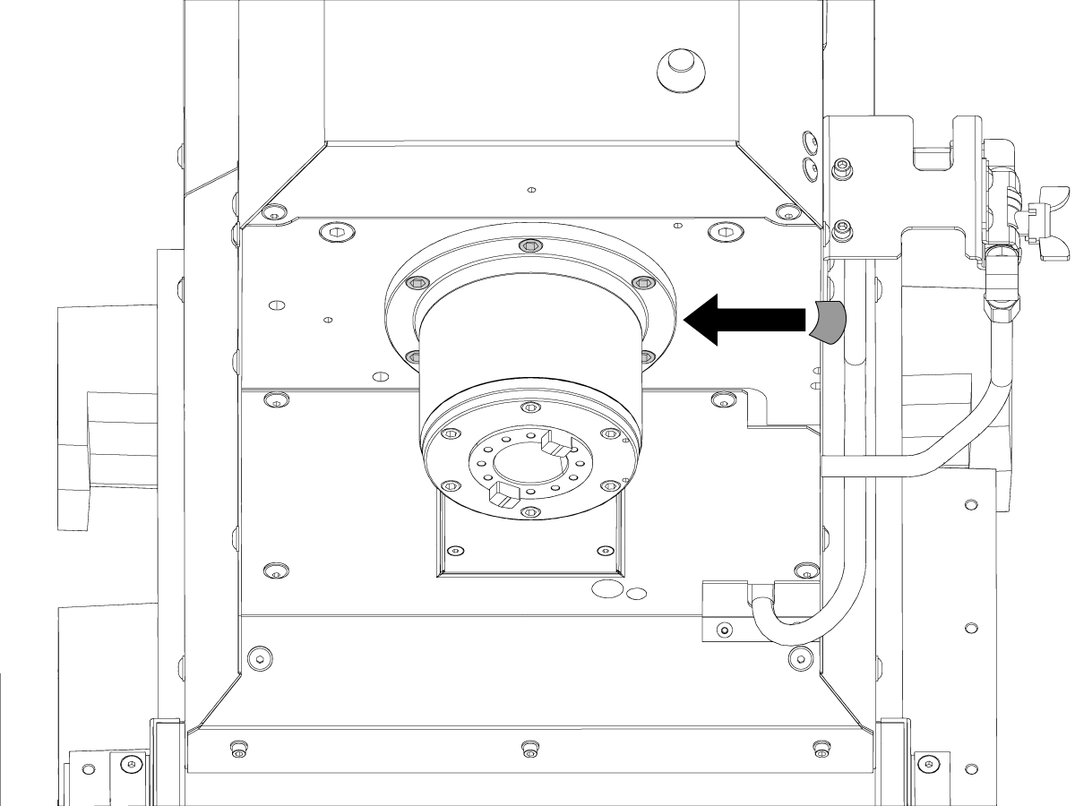

If the error is more than 0.0005" (0.01 mm), then you must add or remove shims from the spindle.
6
If adjustment is necessary, loosen the (6) spindle mounting screws.
Add shims or change the position of the shims between the spindle flange and head casting. This corrects the alignment.
Torque the (6) spindle mounting screws in a star pattern to 10 ft-lb (14 Nm).
Then torque the screws to 30 ft-lb (41 Nm).
Then torque the screws to 50 ft-lb (68 Nm).
