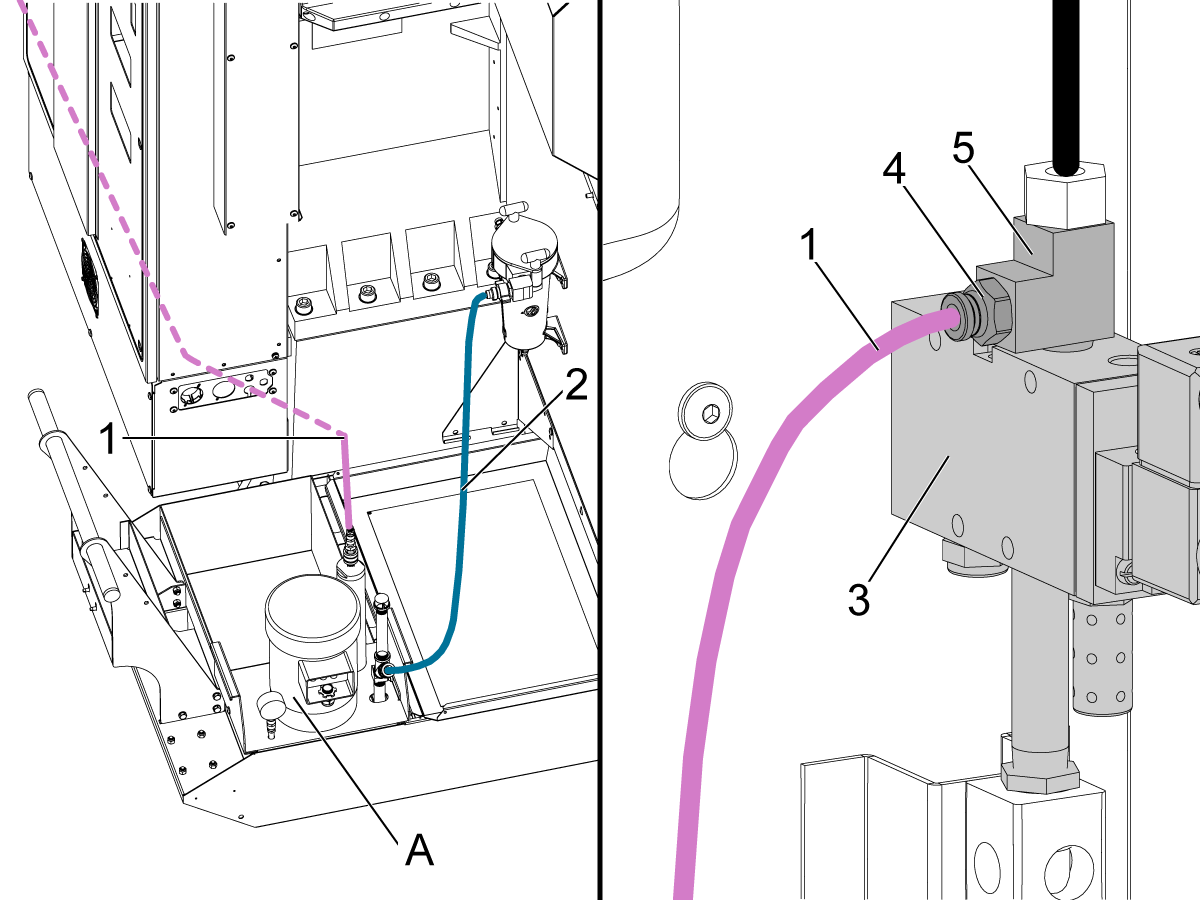

Route the hoses from the HPFC pump [A] as shown.
The air hose [1] will come from the TRP solenoid in the lube panel and connect to the air cylinder.
A tee fitting [5] and 1/4 push to connect fitting [4] will need to be attached to the TRP solenoid [3]. Then connect the air hose [1] to the push to connect fitting [4].
The output hose from the HPFC will go to the filter [2].
Note: Machines with TSC previously had the purple air line split between the TSC and HPFC pumps, that is no longer the case and the HPFC pump should be connected to the TRP solenoid [3] as shown in the image.

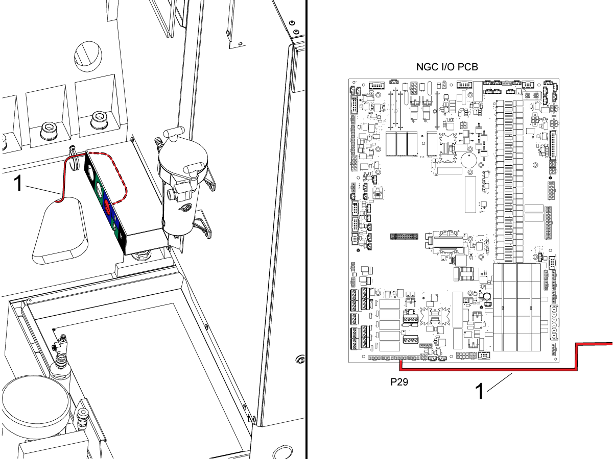

VFD coolant upgrade to HPFC
If you are upgrading from the VFD coolant system to HPFC remove the current cable on the coolant connection bracket and replace with the cable provided as shown [1].
Route the new cable from the bracket to I/O P29.
Note: VFD will no longer be used, a patch is required to disable the drive. Contact the Service Department for the patch.
