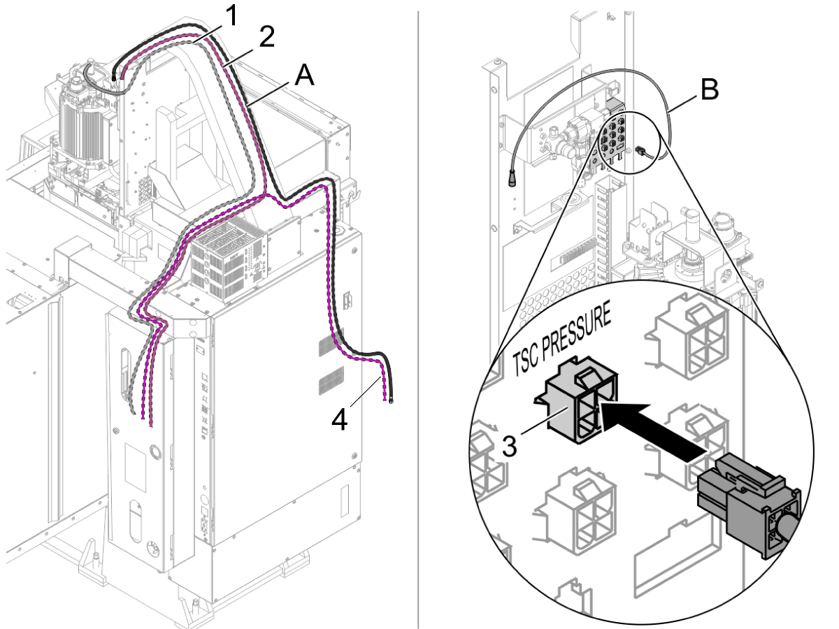

Route the clear 5/32 TSC positive pressure pneumatic hose [1] from the CALM cabinet though the cable channels to the top of the motor.
Route the purple TSC air purge pneumatic hose [2] from the CALM cabinet though the cable channels to the top of the motor.
Route the purple TSC auto clean cylinder pneumatic hose [4] from the CALM cabinet though the cable channels to the TSC pump.
Route the TSC coolant hose [A] from the TSC pump though the cable channels to the top of the motor.
Plug the TSC pressure senor cable [B] into the plug on the wire harness labeled "TSC PRESSURE" [3].

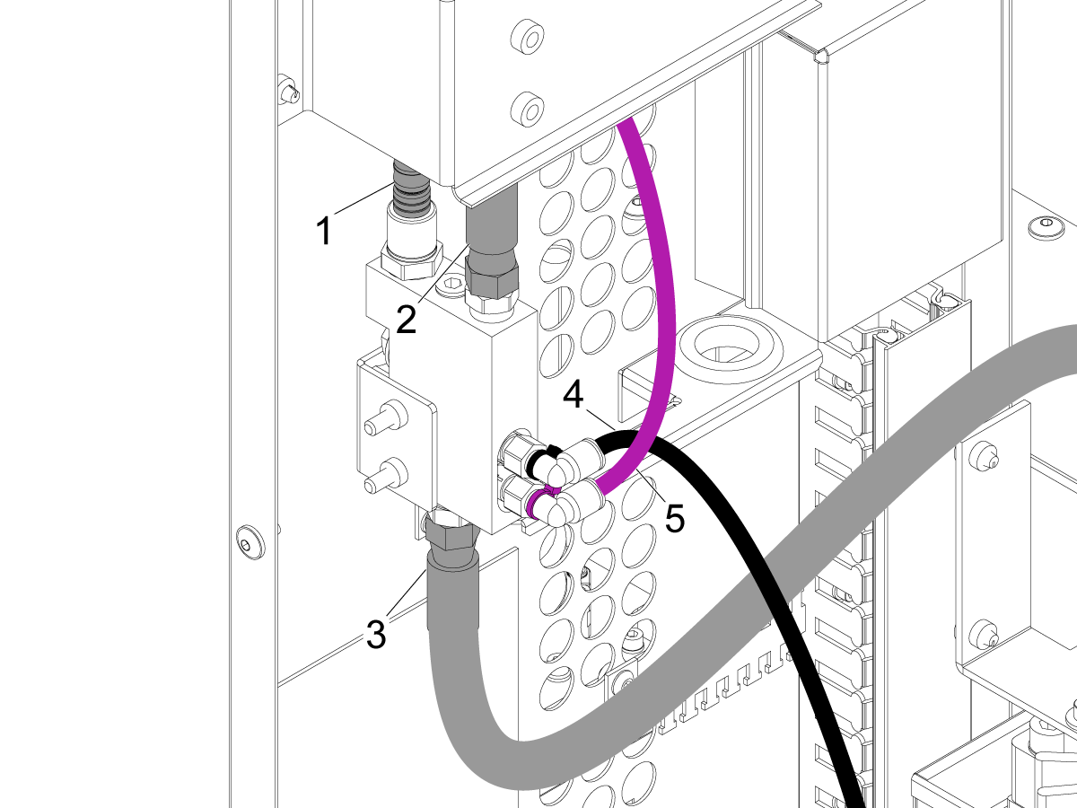

Install the TSC check valve assembly bracket [1] to the enclosure panel at the back of the column using the (2) 1/4-20 sheet metal screws [2].
Install the TSC check valve assembly [3] onto the bracket [1] using the (2) bolts [4].
Install the TSC pressure sensor cable [1] onto the plug at the top of the TSC check valve assembly.
Install the coolant hose from the TSC pump [2] onto the fitting at the top of the TSC check valve assembly.
Install the straight end of the short TSC hose [3] onto the fitting at the bottom of the TSC check valve assembly.
Install the black pneumatic hose [4] onto the push-to-connect fitting marked by the black zip tie.
Install the purple pneumatic hose [5] onto the push-to-connect fitting marked by the purple purple tie.

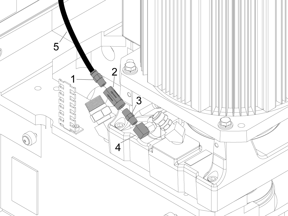

Remove the push-to-connect fitting [1] from the 90 degree fitting [4].
Install the check valve [2] and nipple [3].
Reinstall the push-to-connect fitting [1].
Install the black pneumatic hose [5] from the TSC check valve assembly onto the push-to-connect fitting.

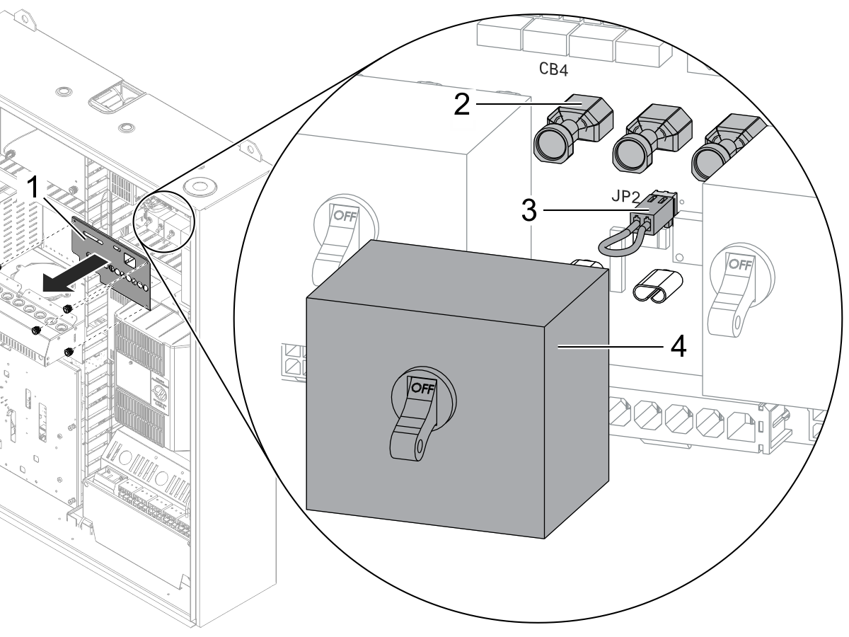

Remove the cover [1] for the power supply (PSUP) PCB.
Remove the push-on covers [2] for the connectors from position CB4.
Remove the electrical jumper at position JP2 [3] on the PSUP PCB.
Install the 15A circuit breaker [4] at position CB4.
13
