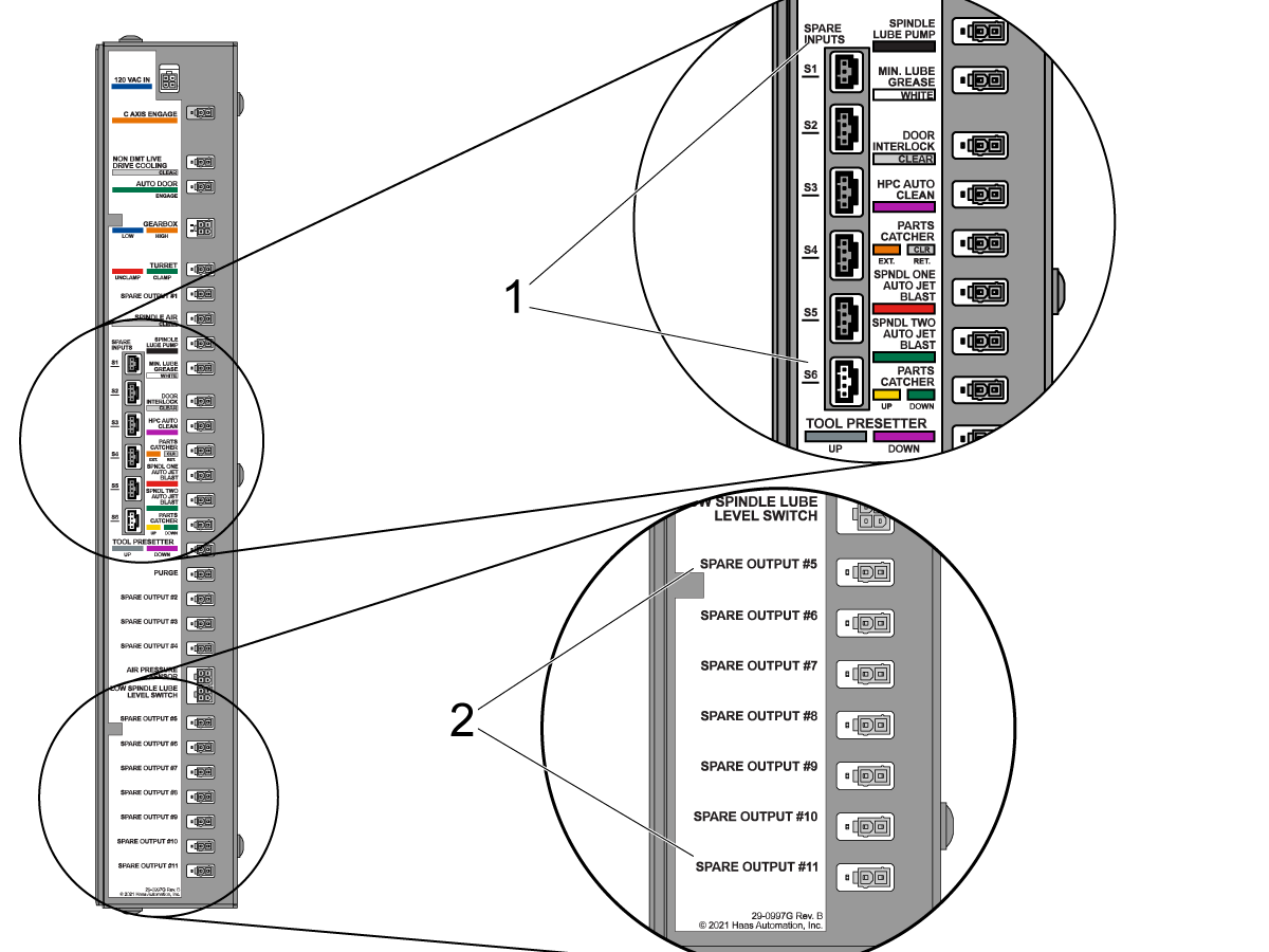

The lube panel pcb contains several inputs and outputs that are labeled as "spare".
The spare inputs [1] labeled S1 - S6 and the spare outputs [2] are not available for general purpose use.
Note: These inputs and outputs are included on machines so that they can be utilized when future machine options are created that way the Lube Panel PCB does not have to be replaced.
