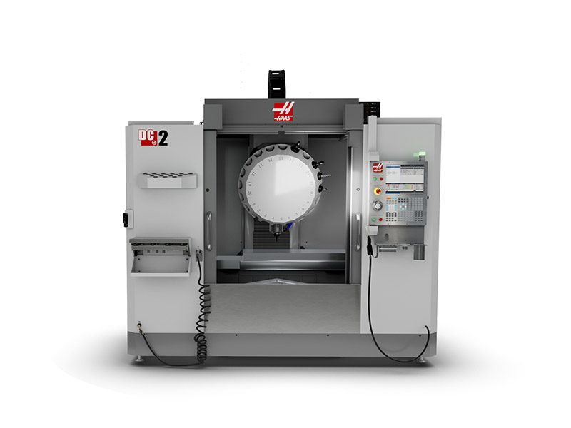

High-Speed Drill Center with 39.4" x 19.7" x 19.7" travels, 40 taper
The DC-2/40 is a larger version of our traditional-style drill/tap machine that offers more X and Y travel and a larger table to accommodate bigger parts, multiple vises, or high-density setups. The machine is equipped with a 10,000-rpm 40-taper spindle and high-speed turret-style tool changer to minimize cut-to-cut times and shorten cycle times. Choose the optional 12,000-rpm or 15000-rpm spindle to cut production times even further.

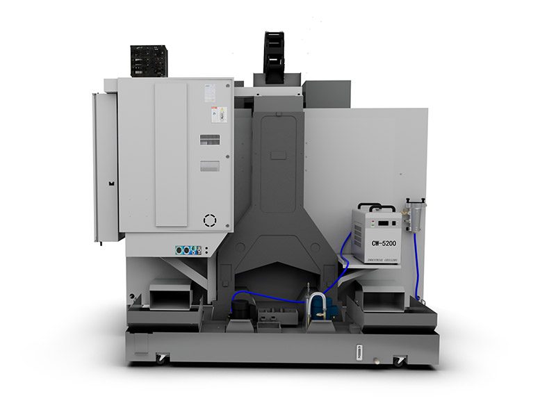

The rear chip discharge of the DC-2/40 allows machines to be placed side-by-side to maximize floor space, and provides easy side access for automation systems. The machine’s one-piece, extra-wide base provides stable support for heavier parts and fixtures, and the wide-stance triangulated column increases overall rigidity.
  • More travel and larger table for bigger parts and high-density setups
  • 10,000-rpm 40-taper spindle (12k or 15k available)
  • High-speed turret-style tool changer, 20 tools
  • Available auto window for easy automation
  • Rear chip discharge with front chip flush
