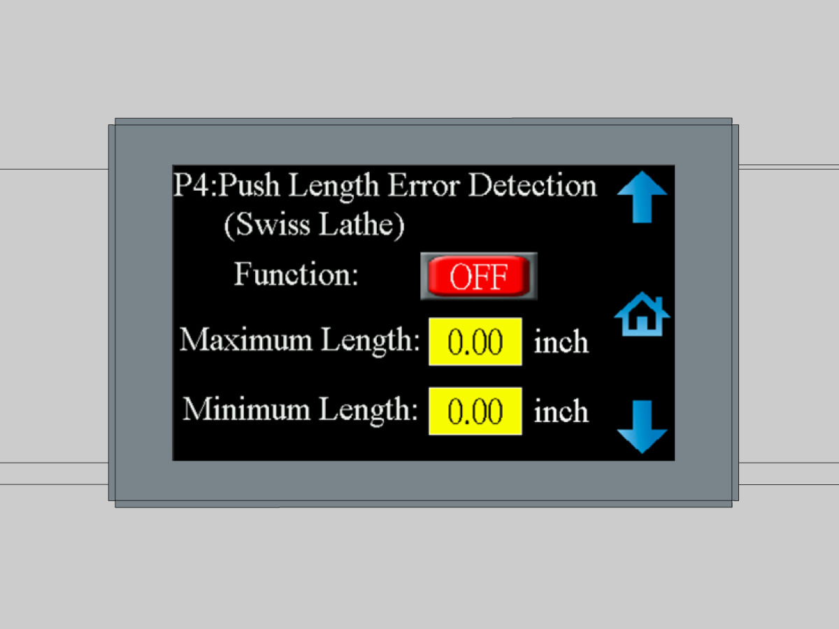

Parameter 4 Push Length Error Detection (Swiss type)
This is a safety parameter that can be set by the operator as a secondary safety function in the event the collect is closed too early or too late.
If the bar travel is :
  • Too short (Alarm 22)
  • Too long (Alarm 23)
Note : This parameter does not apply to Haas machines.
Factory Settings:
OFF
0 inch
0 inch

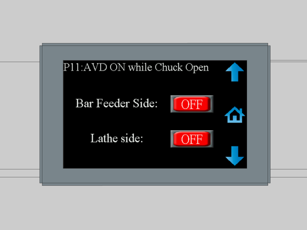

Parameter 11 AVD ON while Chuck Open
Bar Feeder Side : On/Off to enable or disable AVD
Lathe Side : On/Off to enable or disable SAVD (Not applicable to Haas Machines)
Factory Settings:
ON
OFF

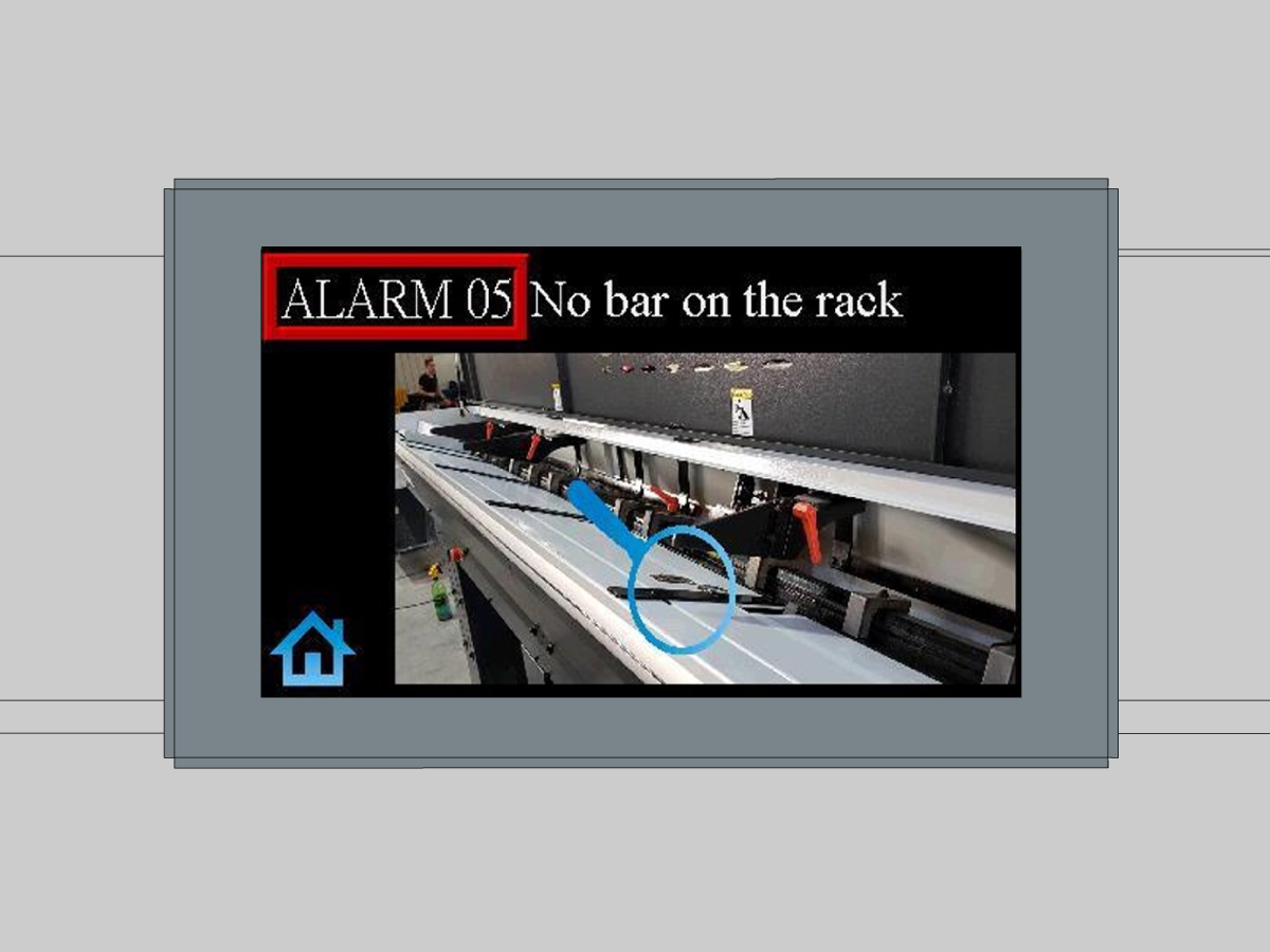

Alarm 01 Remnant in chuck
Alarm 02 Failed to reach home position
Alarm 03 Remnant in pusher chuck
Alarm 04 Upper-guide-channel-open idle too long
Alarm 05 No bar on the rack
Alarm 06 Chuck-open signal not received
Alarm 07 Low air pressure
Alarm 08 Failed to load bar into chuck

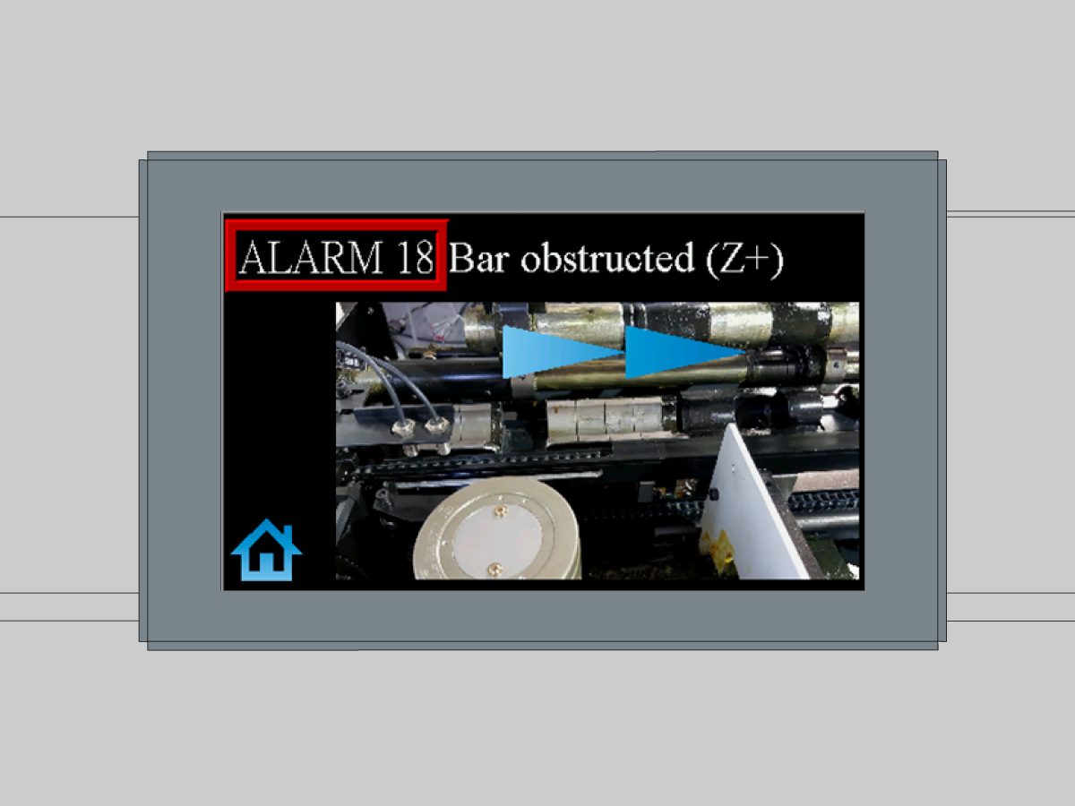

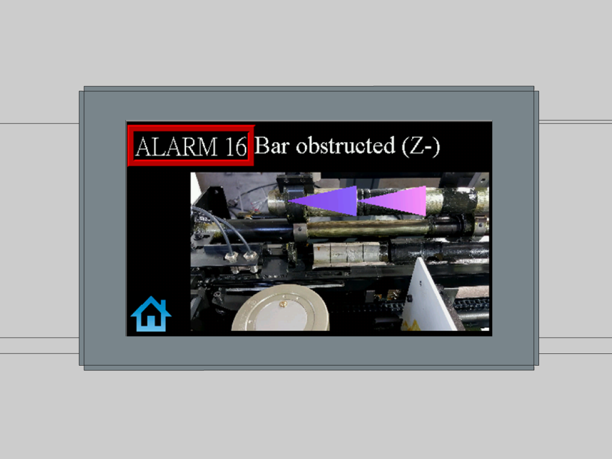

Alarm 16 Pusher motor slipping backwards
Alarm 17 Initial Push Position Sensor Fault (SR0)
Alarm 18 Pusher motor slipping forwards
