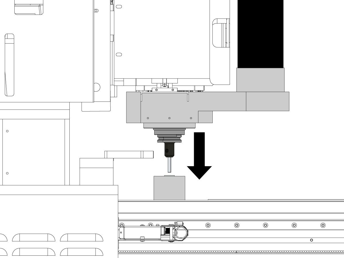

Place the table probe [3] directly under the tool [2] and press [CYCLE START].
Note : It is reccommended to start this routine at a rapid speed of 25% or slower [1] to be able to adjust the table probe position.

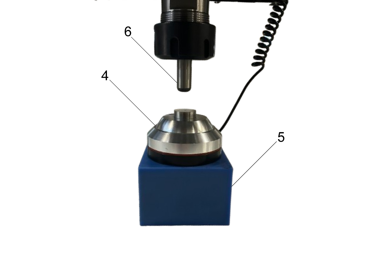

Place table probe on top of the work piece and start the single surface [1] probing routine.
Important : If any of the other options are selected the machine will generate alarm 1010 (NOT SUPORTED) [2].
Note : The SR-3015 is only able to measure the Z-axis height offset of the work piece. X and Y axis positions need to be set manually.
Select the desired work offset value [1] then ensure the selected axis [2] is set to Z or the machine will generate alarm 1010 (NOT SUPPORTED). Place the table probe [4] on top of the work piece [5] then jog the Z-axis down and press [CYCLE START].
