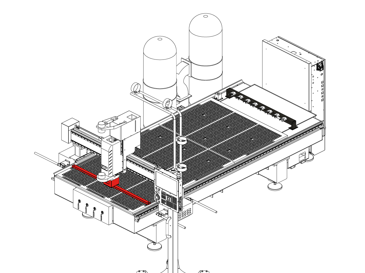

This procedure will guide you through the installation of the SR-3015/4020 machine.
Tools required:
  • Bubble level
  • 1-1/8" Wrench
  • Magnetic base (optional)
The SR-3015/4020 can be lifted by forklift. For details on how to lift the SR-3015 refer to the Pre-Installation Guide, or the machine lifting placard located on the machine.
Note : SR-3015/4020 will arrive with a L15-30P plug already wired into the pedestal and will require an L15-30R receptacle to be powered on.

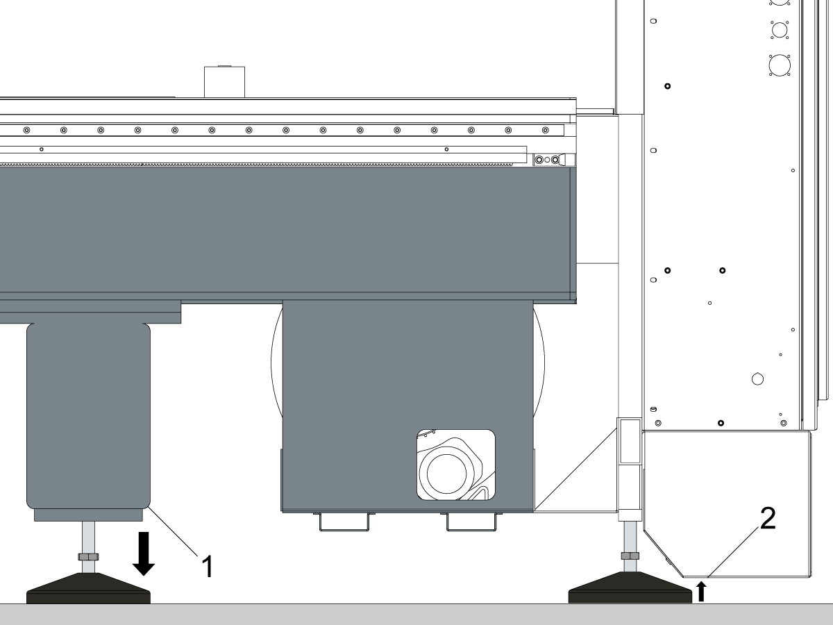

Note : It is reccomended to have the feet at the lowest possible position as a starting point.
To level the machine always raise the lower side by loosening the nut [1] on the foot [2] until it stops at the bottom then use the nut to rotate the entire foot to adjust the height up.
Note : A pallet jack can be used for ease of adjustment.
Only use legs 1, 2, and 3 to level the machine. Only touch down leg 4 when the machine is leveled and turn the wrench an extra 10 degrees to apply pressure.
To level the machine use a level attached to the bridge. Level the machine at the center of travel then fine tune by jogging the X-axis to the ends of its travel and adjusting the feet accordingly.
Note : Leveling can be done using a standard bubble level. If your level is too large to be used in the shown positon a mag base can be attached to the bridge and used as a base.

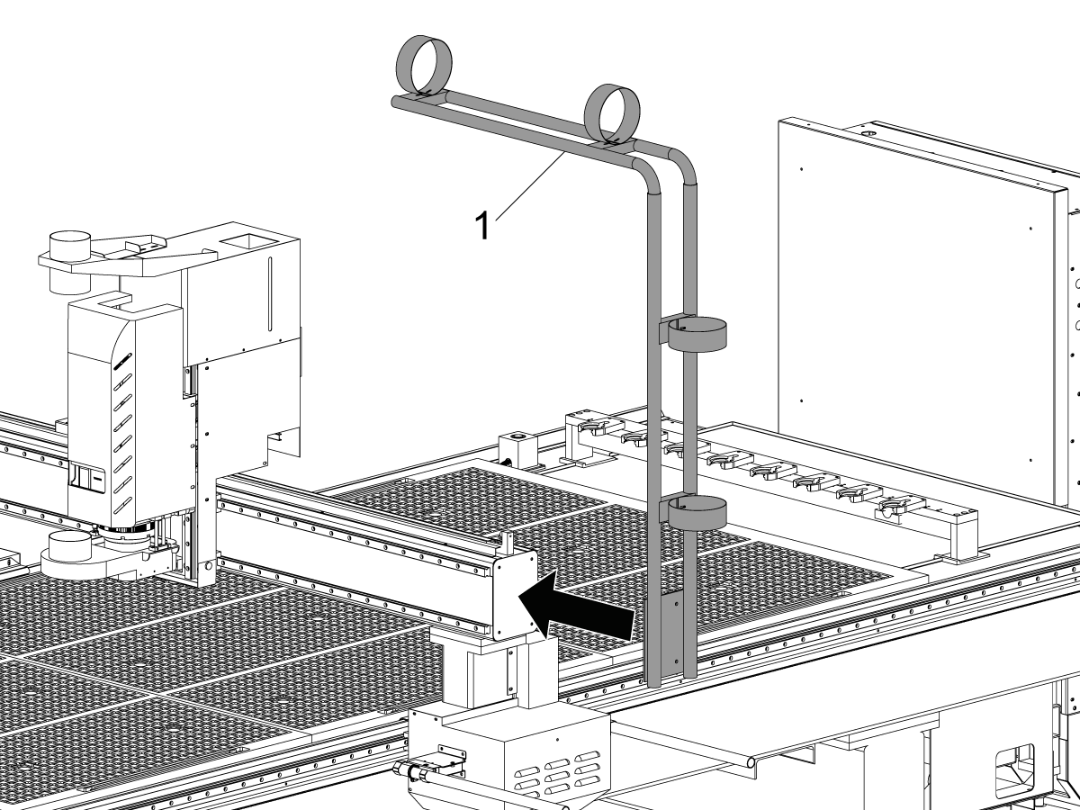

Install the vaccuum hose holder to the side of the machine [1] then intsall the spindle vacuum hose bracket [2].
Note : The spindle vacuum hose bracket is a 2-piece design that has one section that clamps onto the spindle and the other uses latches for ease of removal for tool changing.
To install the spindle vacuum hose bracket tighten the clamping bolt [1].
6
Final vacuum dust extractor assembly. Refer to Vacuum Dust Extractor Assembly tab for more information.

Important : The machine feet need to be extended before placing the machine down to avoid damaging the bottom of the control cabinet [2]
To level the machine [1] always raise the lower side by loosening the nut on the foot until it stops at the bottom then use the nut to rotate the entire foot to adjust the height up.
Note : It is reccommended to lift the machine up and roughly adjust the height of the feet before leveling. This can be done using a pallet jack for ease of adjustment.
Retract the Z-axis and remove the shipping bracket from the machine.
Similarly touch down feet 5 and 6 to support the electrical cabinet.
To level the machine place a level [1] on to the bridge. Level the machine at the center of travel then fine tune by jogging the X-axis to the ends of its travel and adjusting the feet accordingly.
If applicable Install the vaccuum hose holder to the side of the machine [1] and route the vacuum hose to the spindle. Refer to Vacuum Dust Extractor Assembly tab for more information.
Note : For more information regarding the operation of the spindle and table vacuum features please refer to the Operation chapter.
