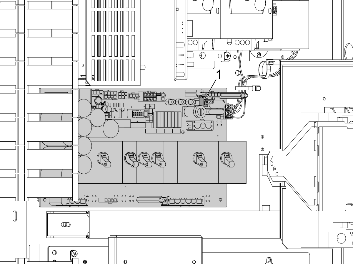

PSUP Jumper - Installation
Install the jumper [1] from JP1 on the PSUP.
