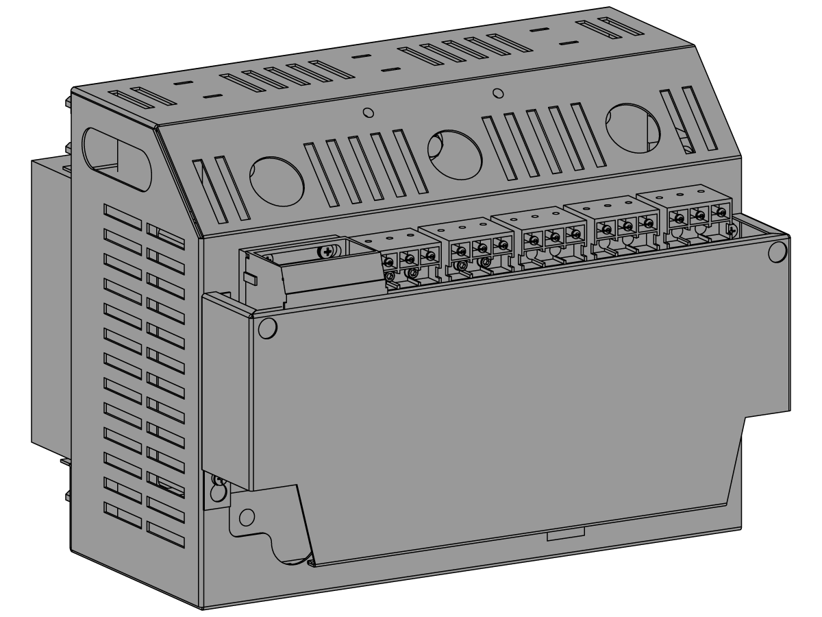

T5 Transformer - Replacement
Remove the old T5 transformer [1] and replace with the new one.
Measure the incoming voltage from the top of the breaker and place the jumper [2] to the correct location on the new T5 transformer.
Note: The incoming voltage determines the location of the jumper on the T5 transformer.
