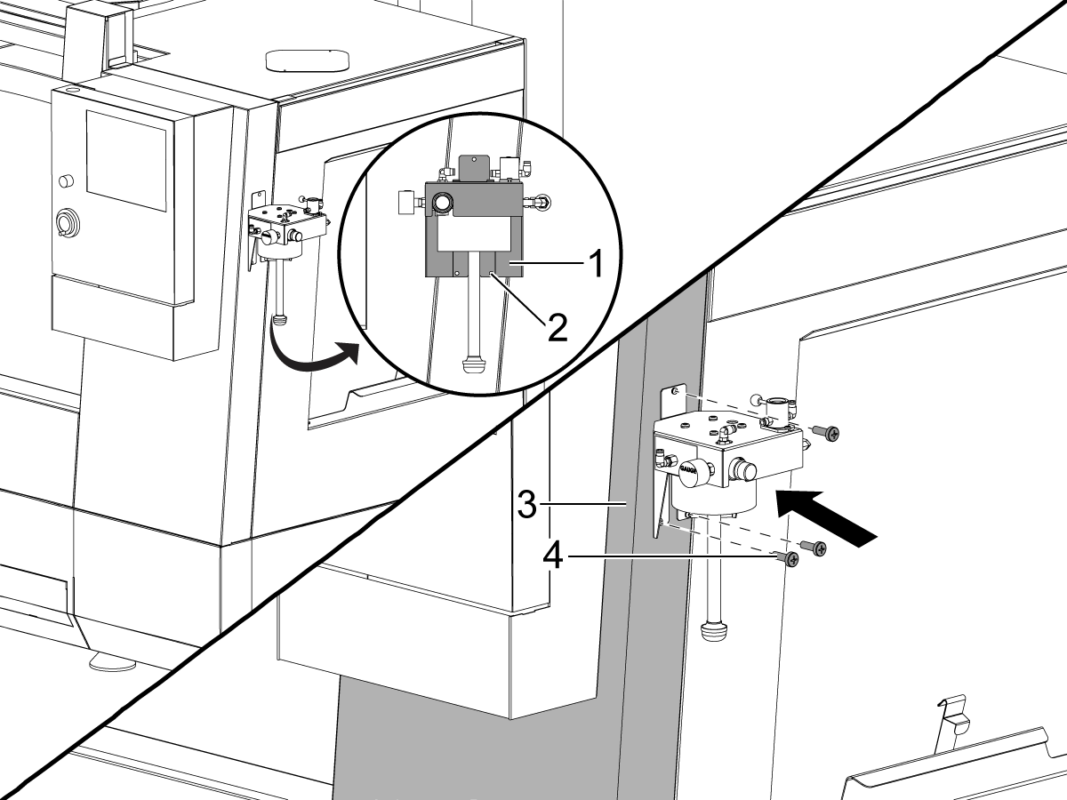

Remove the reservoir bowl [1] from the MQL oil reservoir assembly.
Attach the toggle valve [2] using the provided pemnuts [3]
Hold the MQL oil reservoir assembly [5] or the template on the right-front panel [4] so that the pressure gauge [6] is 5.5 ft (1.7 m) from the ground.
Caution: Attach the MQL reservoir to the front-right panel only.
Put marks for the (3) hole locations [2] for the bracket [1] onto the front-right panel.
Note: Some machines have these hole marks. Before drilling, look inside the machine to ensure there are no obstructions for the screws.
Drill the (3) 0.144" (size 27 drill bit) holes in the front-right panel [3].
Attach the bracket to the front-right panel. Use the (3) self-tapping screws [4].
Note: If you damage the sheet metal, use the (3) screws and the (3) nuts.

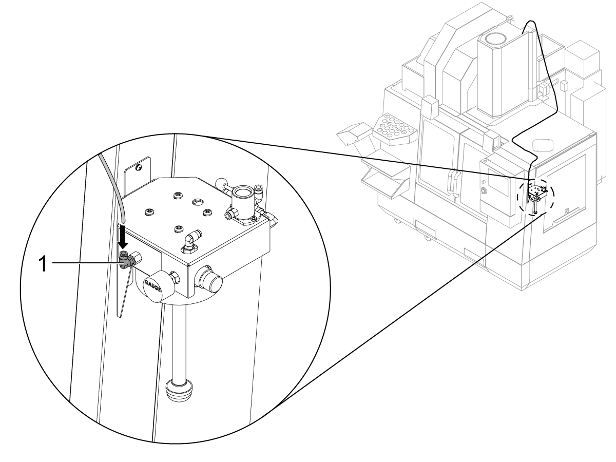

Install the clear 1/4" MQL oil tube [1] through the cable carrier and cable channels as shown. Uncoil the clear 5/32" MQL oil tube that is under the spindle head cover and attach it to the push connect fitting on the 1/4" tube.
Put the clear 5/32" MQL oil tube [2] through the slot [3] on the spindle head casting.
Note: Keep the fitting that connects the clear 1/4" and 5/32" tubes inside the spindle head cover.
Install the upper cover for the spindle head.
Connect the other end of the 1/4" clear tube to the oil output port [1] on the MQL reservoir assembly.

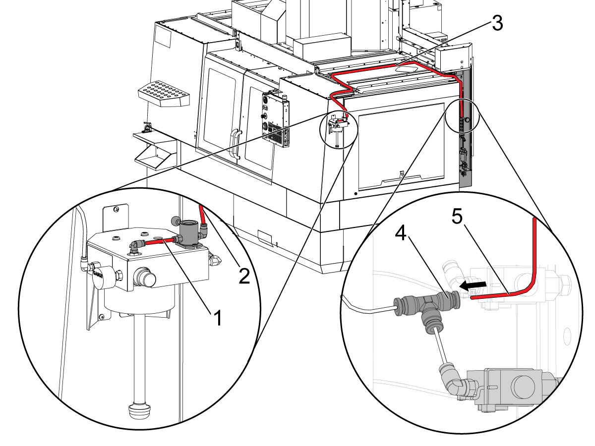

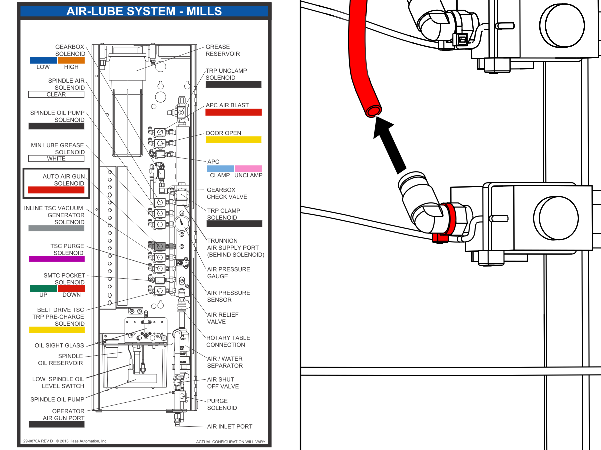

Disconnect the red tube from the AAG solenoid in the lubrication panel.
9
Cut a 2" piece of the red tube [3].
Use the piece of the tube to install the tee-fitting [2] to the AAG solenoid.
Connect the AAG tube [1] to one of the ports on the tee-fitting.
10
Cut a piece of the red 1/4" tubing [1] given in the kit to install on the MQL.
Route the red 1/4" tube [3] from the lubrication panel to the MQL reservoir assembly. Use the (3) cable ties and the (3) magnetic cable mounts.
Connect the tube [5] to the other port of the tee-fitting [4].
Connect the other end of the tube[2] to the air inlet port of the toggle valve on the MQL reservoir assembly.

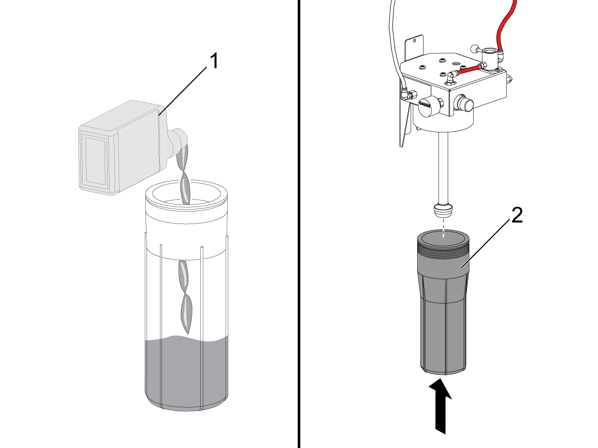

Fill the oil reservoir with MQL lubricant [1].
Install the reservoir [2] into MQL Reservoir assembly.
Caution: Only use lubricants that are non-toxic and specially made for MQL systems. Refer to the Lubricant Table for Haas Machine Components for recommended lubricants.

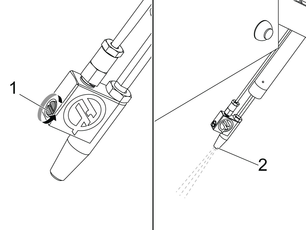

Find the atomizer needle valve [1]. Turn the needle valve counterclockwise (2) full turns from the closed position.
Operate this code in MDI mode:
M83;
Operate the MQL system [2] until no air is in the system. The mist can stop momentarily. This shows that air is in the system. If the mist does not stop, no air is in the system.
Push [RESET] to cancel the purge cycle.
Close the atomizer needle valve. Then open it (1/2) to (1) turn.

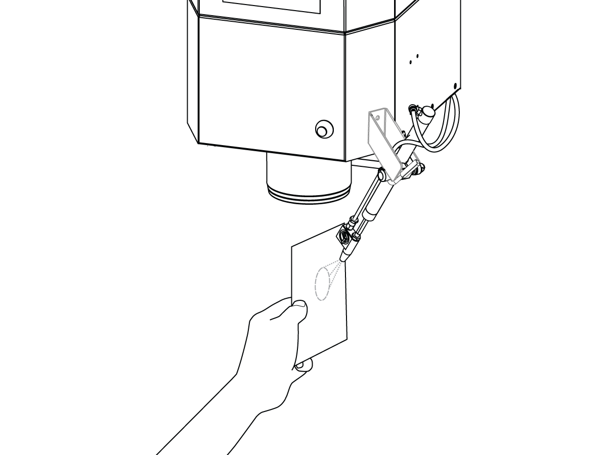

Do these steps to make sure the MQL system operates correctly: Hold a small piece of paper approximately 3 inches from the atomizer. Operate the program in Step 2. A round wet pattern shows that the MQL system is adjusted correctly.
Some oils have a higher viscosity. Oils with higher viscosity flow slowly. To make the oil flow correctly, adjust the needle valve.
Note: If the oil is not flowing through, remove the needle valve and its spring to clean it off and let it run until oil starts leaking through the needle valve hole. Put back the needle valve and its spring, and close it. Then open it (1/2) to (1) turn and try again.
