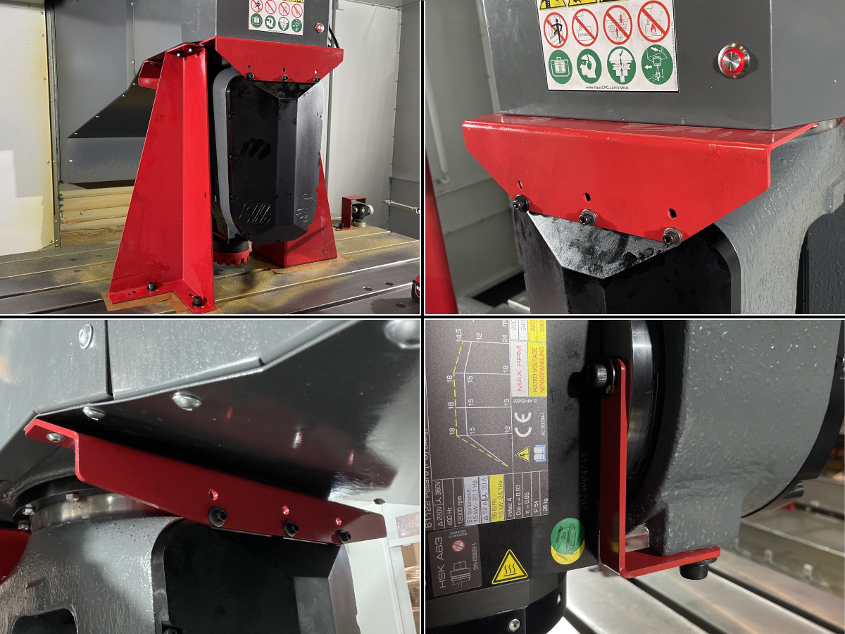

 Note: Machines built 9/1/2025 and later will ship with larger brackets[1] and an additional Spindle Support bracket[2].
  • Remove the four bolts[3] holding the spindle support bracket[2] to the shipping brackets[1].
  • Remove the spindle support bracket[2].
  • Remove the shipping brackets[1].
 Note: Machines built 9/3/2024 and later will ship with brackets securing the B-Axis and C-Axis.
  • Remove the shipping brackets from the B-Axis and C-Axis.
