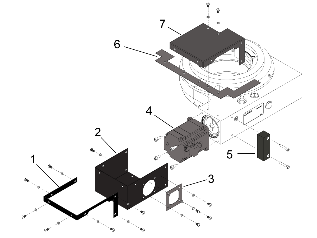

The top image shows the following components of the Mill Spindle C-Axis Drive
  1. Gasket Enclosure Cap
  2. Enclosure Base
  3. Gasket Square J-box
  4. Servo Motor
  5. Enclosure Block
  6. Gasket Enclosure Base
  7. Enclosure Cap

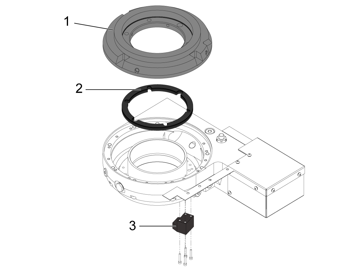

The bottom image shows the following components of the Mill Spindle C-Axis Drive
  1. Mounting Plate
  2. Shim Stack
  3. Tooling Stop Block
