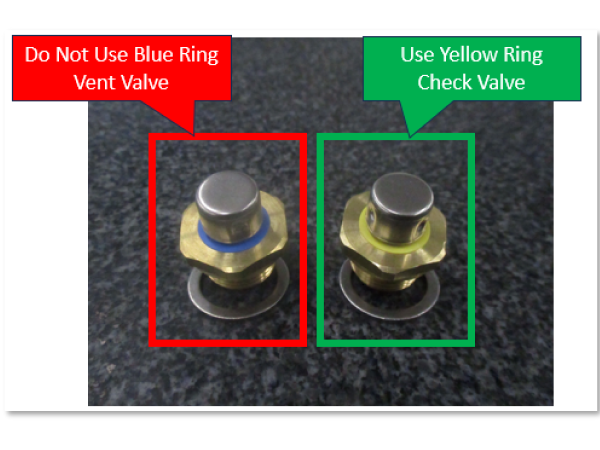

C-Axis Drive Check Valve
Updated
Early models of the C-Axis drive saw servo motor overload and poisition error too large alarms due to pressure buildup. A breather valve was added to the design to resolve this issue for future models. If the breather value  [1] is not installed, contact Haas Service for assitance.
Note: Some models may come with a valve that has a blue ring attached DO NOT USE the valve with the blue ring as it does not protect the oil cavity from coolant intrusion. Use the valve with the yellow ring instead PN 93-6587.
