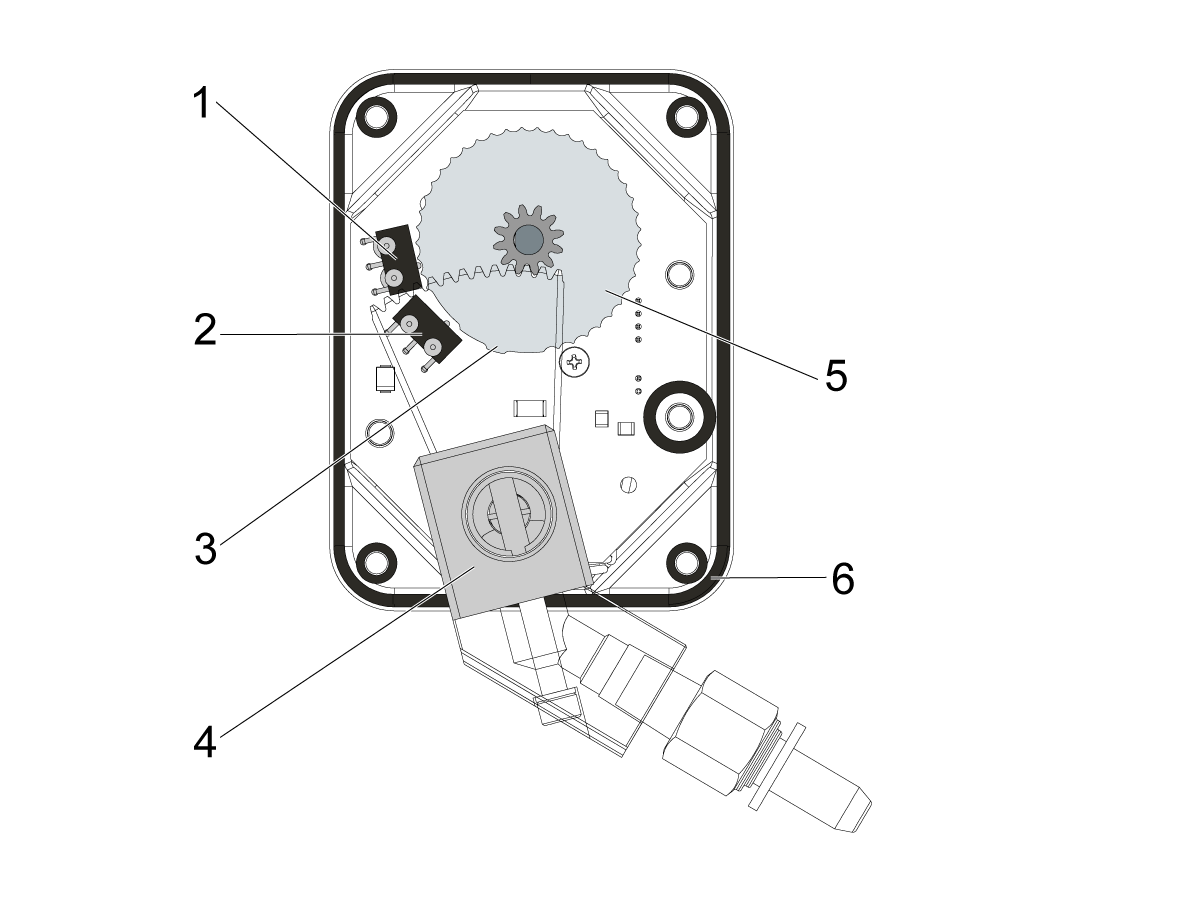

Caution: OPENING THE P-COOL UNIT IS NOT A RECOMMENDED STEP IN THE TROUBLESHOOTING GUIDE AND MAY VOID YOUR WARRANTY.
[1] Position switch
[2] Home switch
[3] Home flag
[4] Nozzle Swivel Fitting
[5] Count Gear
[6] Seals

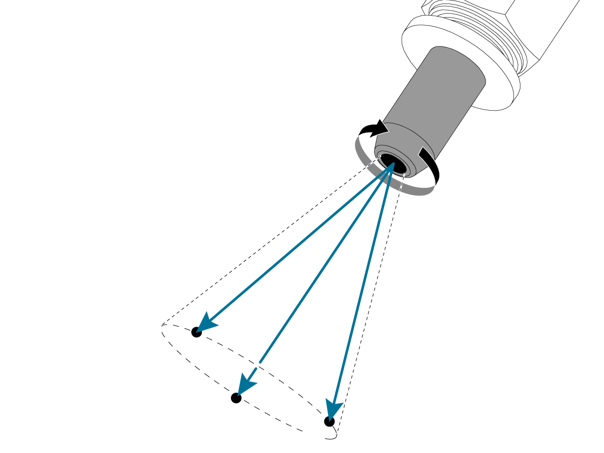

The push connect type nozzle allows for some deviation in the P-COOL coolant stream.
The nozzle can be twisted to make small adjustment to the alignment of coolant stream. If the nozzle is not loose enough to be moved by hand, pull the nozzle out gently until it clicks. The nozzle should now be free to rotate by hand.
Twist the nozzle incrementally, turning on coolant between adjustments, until the coolant hits the tool.

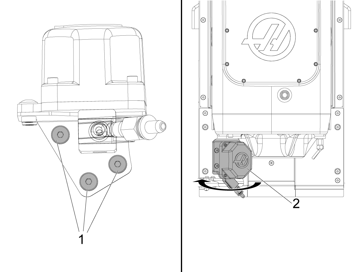

UMC Machines Only:
P-COOL units on UMC machines are attached to the spindle with a bracket. To adjust the alignment of the P-COOL, loosen the bolts that secure the P-COOL to the bracket [1].
Push the P-COOL in the desired direction [2] and hold it in place while tightening the bolts.
Test the alignment by turning on the coolant.

Inspect the swivel fitting (4) attached to the nozzle and determine if it is bound or fixed in position.
Reset any alarms and power cycle the machine. The pcool will home itself, actuating the home switch (2) then reset the count switch (1) position..
NOTE: When the P-COOL is in motion and that action is interrupted by a loss of power, then it is possible that the unit will lose position. Homing the P-COOL fixes this position error. To do this, power cycle the machine.

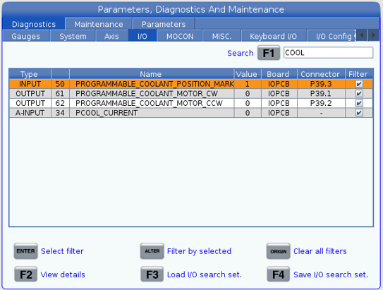

I/O confirmation
Monitor the following inputs and outputs and verify their values change across all positions by manually commanding the unit.
Use the CLNT UP or CLNT DOWN buttons on the control to actuate the nozzle.
NAME P# TYPE SW# HW# CONNECTOR INITIAL VALUE
PROGRAMMABLE_COOLANT_POSITION_MARK P39 INPUT 50 IO16 P39.3 1
PROGRAMMABLE_COOLANT_MOTOR_CW P39 OUTPUT 61 0031 P39.1 0
PROGRAMMABLE_COOLANT_MOTOR_CCW P39 OUTPUT 62 0030 P39.2 0
PCOOL_CURRENT P34 A-INPUT 34 A34 - -

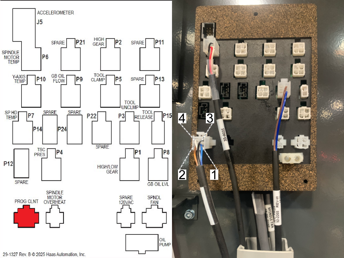

Verify that the cable connection for the P-COOL cable at the spindle head bracket is secure.
Verify the cable is not damaged along its length.
Verify the connectors at P35 on the I/O PCB, are properly seated, pins are in good condition and not contaminated.
Run this program in MDI mode:
M34;
G04 P2. ;
M35;
G04 P2. ;
M99 ;
While the program runs, use a multimeter with needle-tip probes to measure the resistance from pin 3 (black) to 2 (brown). The meter will alternate between a value and OL, verifying the condition of the position switch.
While the program runs, use a multimeter with needle-tip probes to measure the voltage from pin 4 (white) to 2 (brown). The voltage must measure 12 VDC. This will verify that the position switch is supplied power.
Do not measure the voltage with the cable disconnected.
If there is no voltage, check for continuity in the cable between the P-COOL and the connector bracket. If there is no continuity, the cable is at fault. If there is continuity, the P-COOL assembly is at fault.
If there is voltage, refer to:

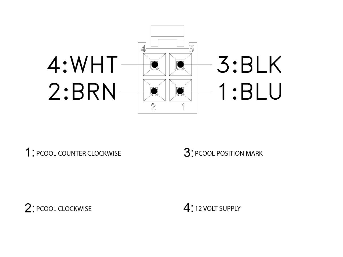

Do a visual inspection of the cable assembly for any cable cut, pinch or damage that could cause the cable to fail.
Do a continuity test of both ends of the cable assembly.
There should be no continuity between these pins in a resting state:
  • Pins 4 (white) and 1 (Blue).
  • Pins 4 (white) and 2 (brown).
  • pins 4 (white) and 3 (black).
