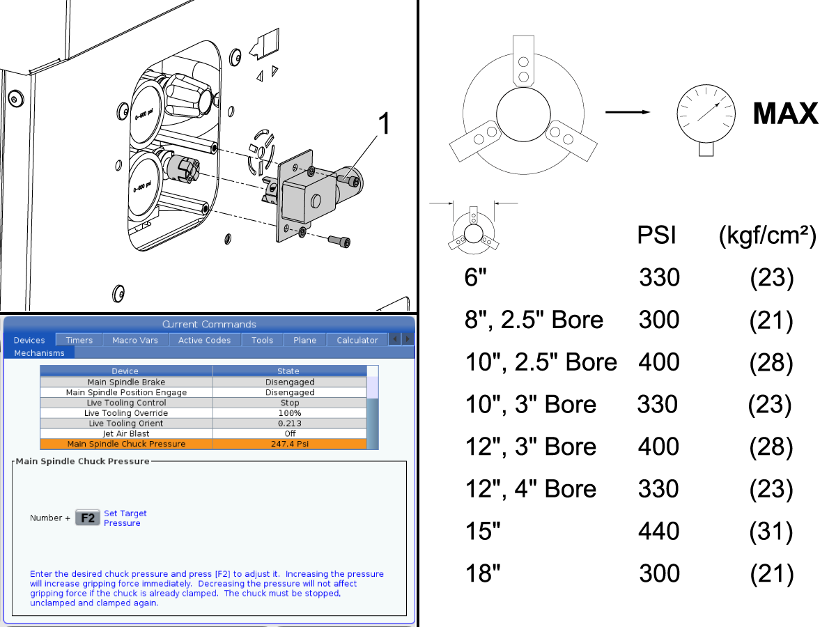

Navigate to Current Commands > Devices > Mechanisms and down to Main Spindle Chuck Pressure. Command the pressure to 100 Psi and then enter the max chuck pressure based on the chuck and spindle size.

Pressure Table
Sub-spindle chuck Max PSI  kgf/cm²
ST-10/20 SS (5" chuck) 450 32
ST-30 finihsing SS (6" chuck) 330 23
DS-30Y secondary spindle (8" chuck) 400 28
Tailstock 400 28

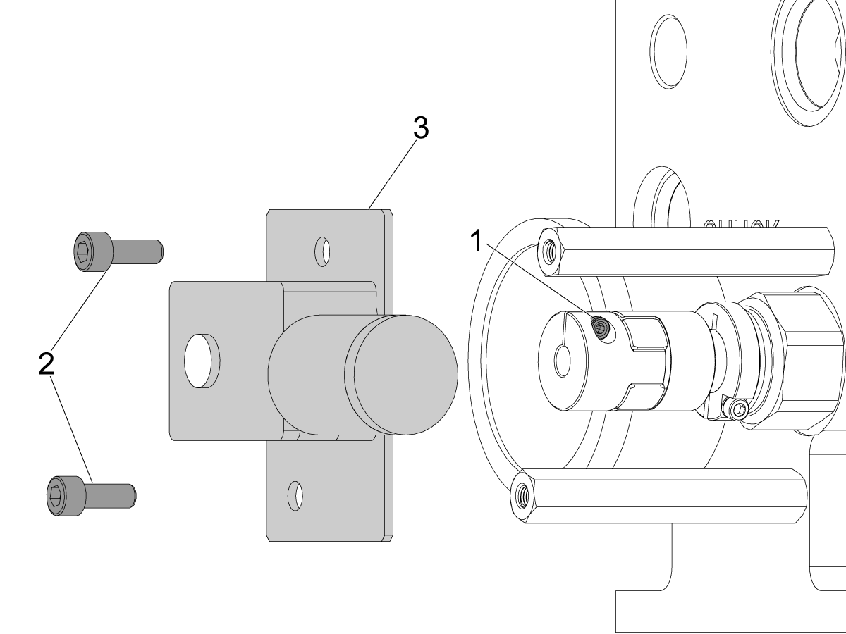

Remove DC motor by loosinig the coupler screw [1] then the motor bracket bolts [2] and finally the the motor and the bracket together [3]

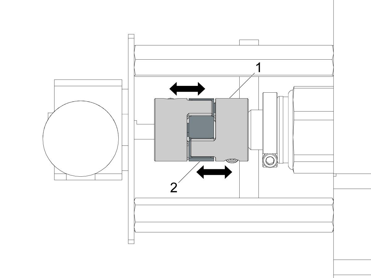

Make sure to adjust distances between clamping hubs [1] and the polyurethane material [2] in middle. When the hydraulic valve is fully in the open position (Anti-clockwise) adjust the coupler to have a visible gap (0.03125in to 0.0625in) then tighten the coupler screw onto the motor.
Note : This is a precautionary step to avoid collapsing the spider coupler which may cause binding

Navigate to Current Commands > Devices > Mechanisms and down to Main Spindle Chuck Pressure. Enter the max chuck pressure based on the chuck and spindle size.
Command max pressure via the control.
Verify that the pressure is accurate within 10 PSI.
Command pressure to 100 PSI via the control
Command max pressure again and tighten the SHCS's while motor is running and verify that the pressure is accurate within 10 PSI.
