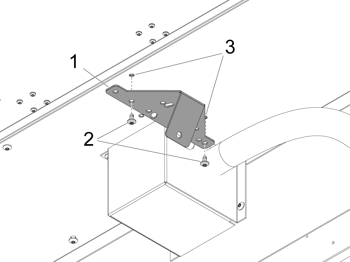

Removal
Push [POWER OFF].
Set the main circuit breaker to the [OFF] position.
Lock the main circuit breaker. Use an approved lock with an approved safety tag.
Unplug LED Lamp from the wiring harness.
Note: Do NOT pull the cable to unplug it. Disconnect the light by pulling the connector.
Uninstall 30W LED Light Bracket [1] by removing the two fasteners [2] from the threaded holes [3].
If access to the two fasteners is restricted, loosen the light pivot screws to adjust the position of the lamp.
 Note: The holes which the original 30W LED Light Bracket mounts to are not the same mounting holes for the new 45W/60W bracket design.
