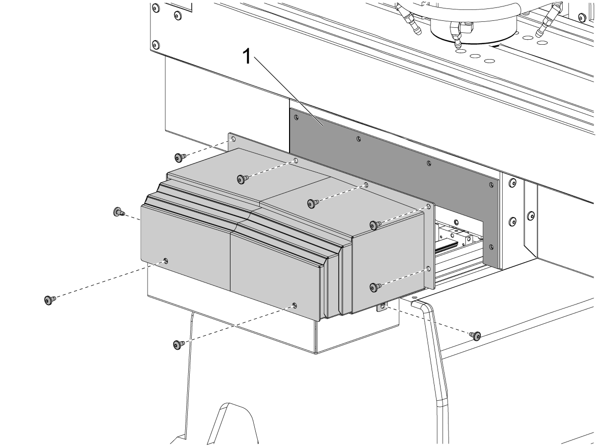

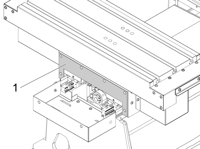

Front Y-Axis Way Cover Replacement
Unbolt and remove the way cover. Remove old gaskets [1].
NOTE: For proper adhesion, thoroughly clean the mating surfaces. Remove chip and debris from linear guides. Apply a fresh coat of grease to linear guides.
Install gaskets in their proper location:
  • Front Y-axis gaskets should be installed on the saddle cover [1].
Align the gaskets to the way cover so that the holes align as closely as possible.

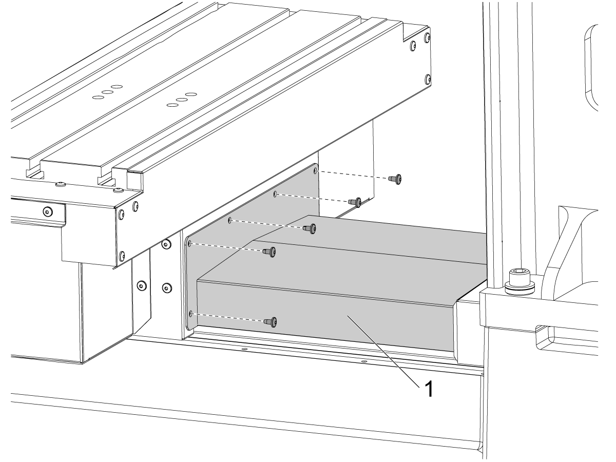

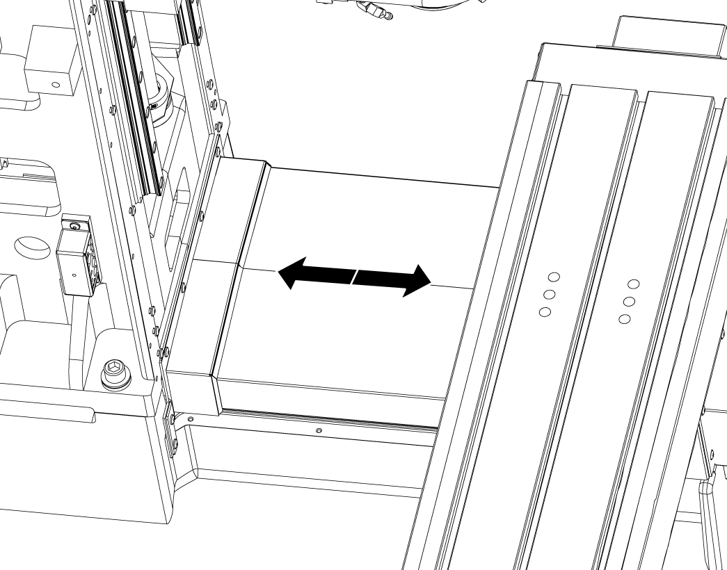

Place way cover on linear rails.
Bolt way cover in place, starting with the end further from the saddle. Expand the way cover by hand along the guide rails to reach the saddle.
Bolt way cover to the saddle. Leave bolts slightly loose.

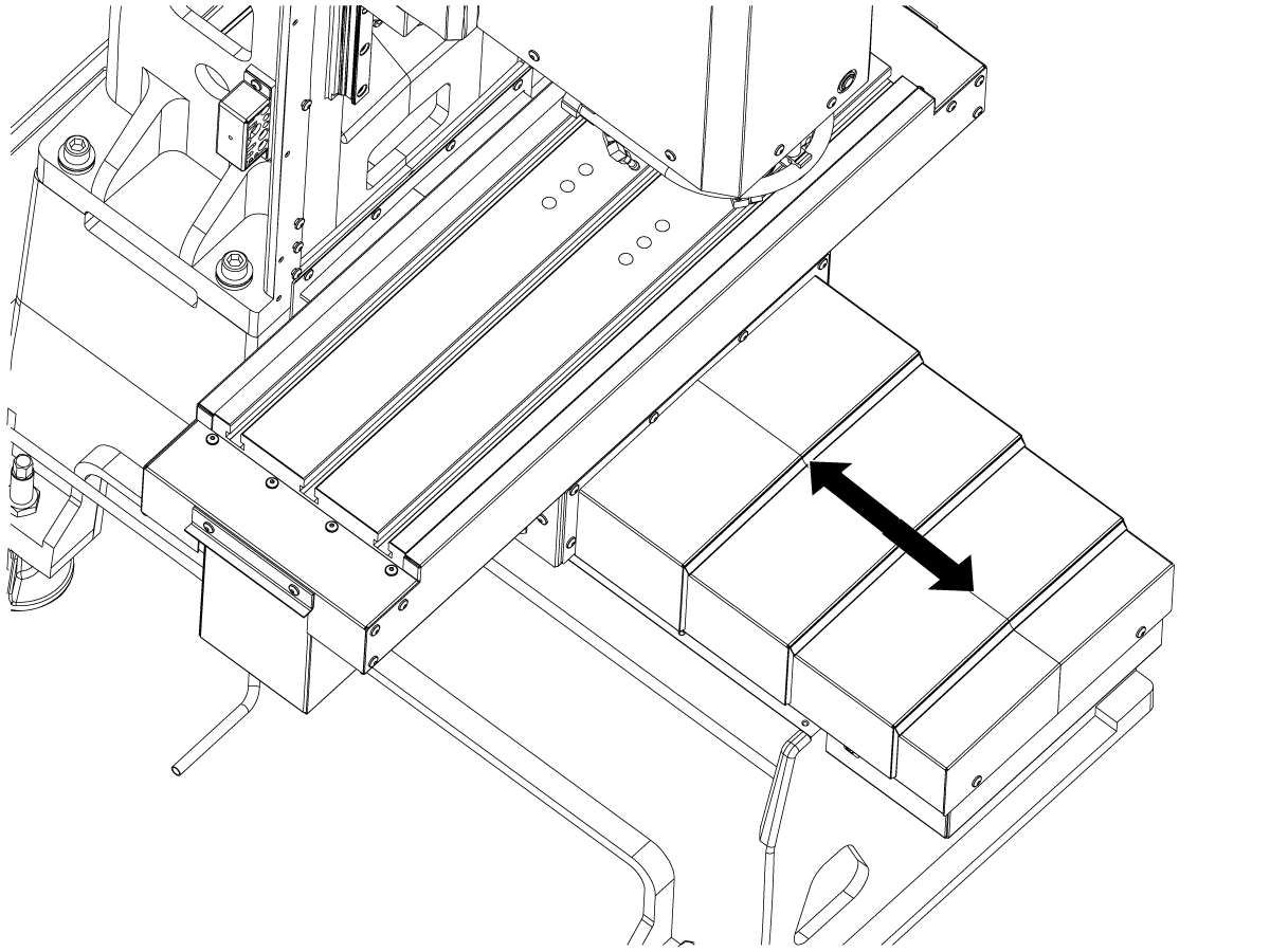

Slowly jog the Y-Axis across the full axis travel. Listen for grinding or sounds of impact from the way cover.
If these sounds are present, open the way cover and slowly move it along the rails, looking for places where impacts may occur.
Tighten down the way cover bolts. Spray a light coat of multi-purpose lubricant on the tops and sides of the new way cover panels.
Run the way cover back and forth across the full extent of axis travel several times to break it in.

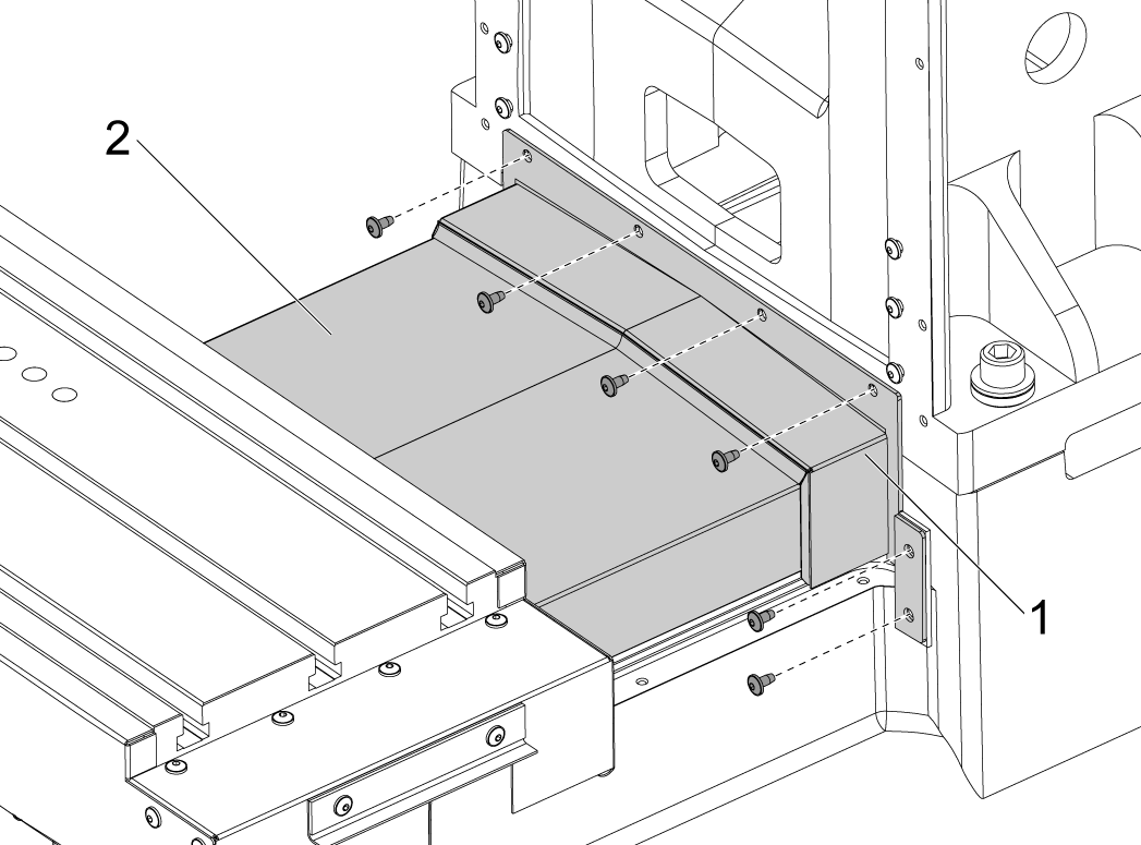

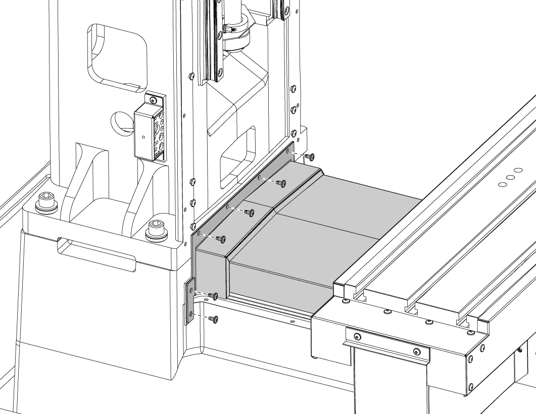

Rear Y-Axis Way Cover Replacement
Jog the Y-Axis to the end of travel in the negative (-) direction, and the Z-Axis to the end of travel in the positive (+) direction.
Remove the screws [1] from the front of the way cover.
Remove the screws from the wiper assembly [1] for the way cover.
Remove the old way cover assembly [2].

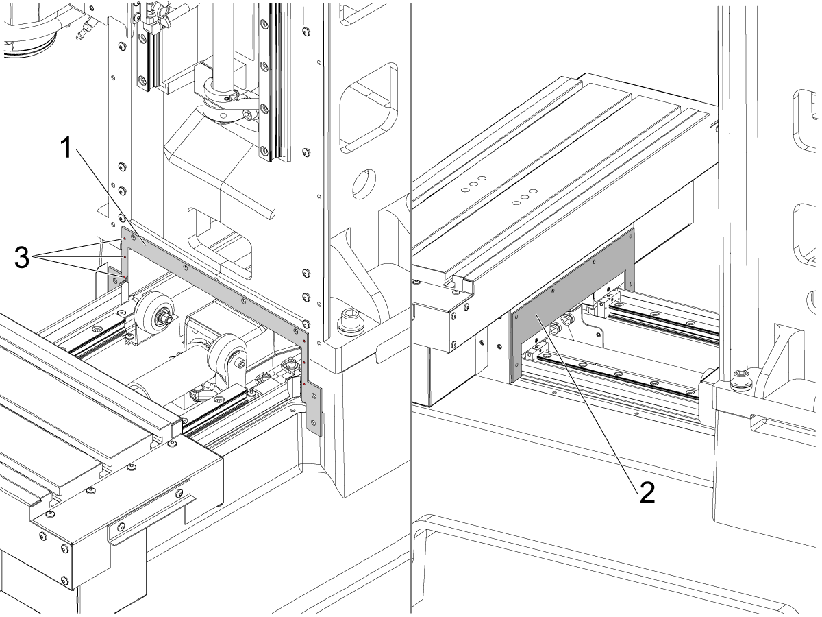

  • Rear Y-Axis gaskets should be installed on the column [1].
  • Front Y-Axis gaskets should be installed on the saddle cover [2].
 NOTE: For the rear Y-Axis gasket, RTV sealant should be used after installing the gasket. Apply the sealant to the middle of the left and right sides of the gasket so the sealant can distribute evenly [3]. Use the metal flanges as a guide for placement.

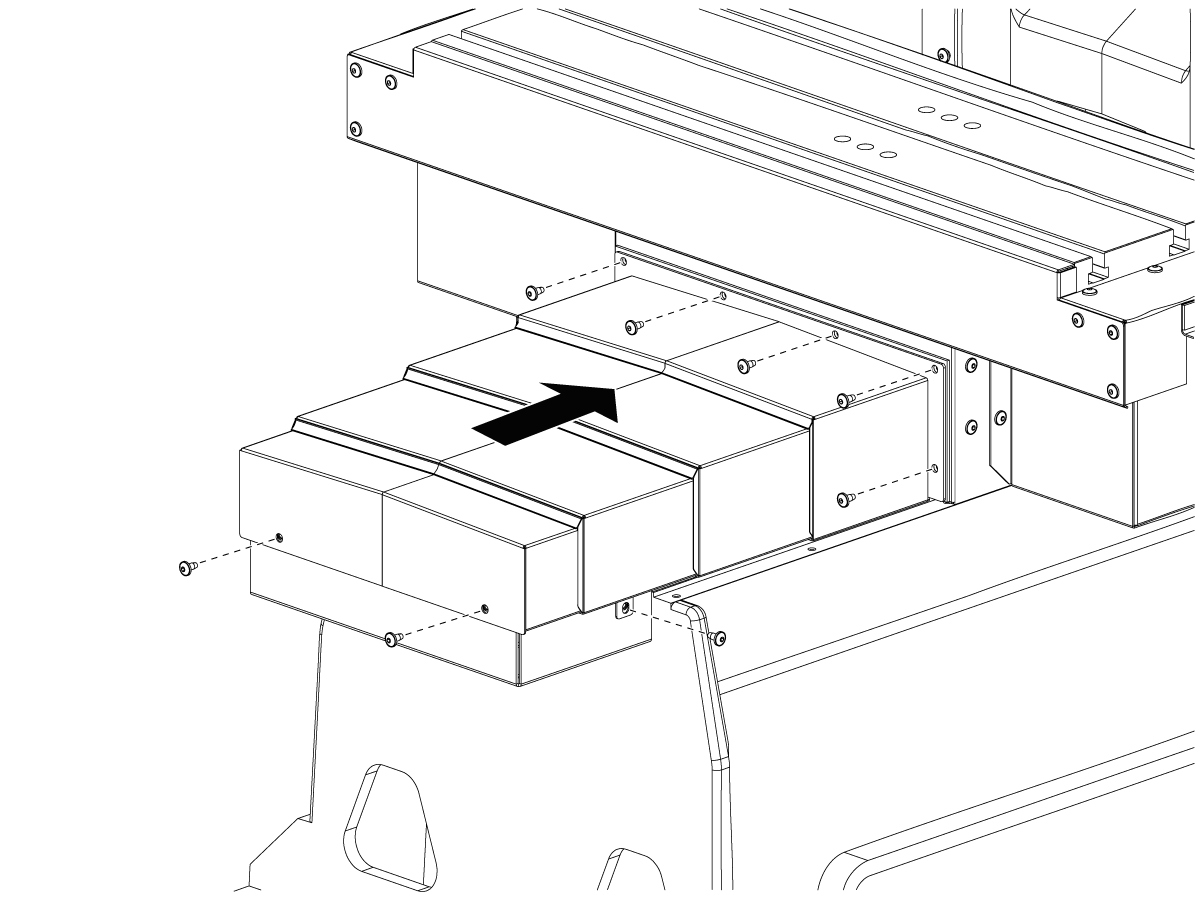

When installing the rear way cover, be sure there are no gaps between the wiper and way cover. Apply a thin layer of grease on the top of the way cover.
Place the way cover on the linear rails. Attach the wiper assembly to the way-cover assembly.
Bolt the way cover to the column. Leave bolts slightly loose.
NOTE: When installing the rear way cover, be sure there are no gaps between the wiper and way cover. Apply a thin layer of grease on the top of the way cover.
Repeat this step to attach the way-cover assembly to the saddle.
CAUTION: Do not let chips or debris to fall onto the ballscrew, ballscrew motor, or guide rail areas.
6
